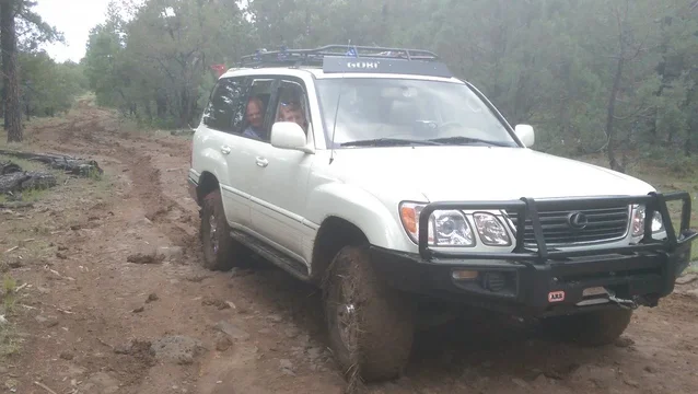

I know the price is pretty high on the Gobi Stealth but I would argue worth it. I wasn't sure how much I would use it and if it was worth it but we use it all the time for so many different things. I got mine with the sunroof insert too. The fact that you can walk on it is what has made it so useful and easy to use. Here are a few pics. The second is fully loaded after our Larbor day weekend camp trip this year. Really easy to load and it looks great. I have subsequently purchased the medium sized Gladiator Cargo Net which is way better than the tarp and tie downs of this picture. IMAG1922.webp IMAG2050.webp
I know the price is pretty high on the Gobi Stealth but I would argue worth it. I wasn't sure how much I would use it and if it was worth it but we use it all the time for so many different things. I got mine with the sunroof insert too. The fact that you can walk on it is what has made it so useful and easy to use. Here are a few pics. The second is fully loaded after our Larbor day weekend camp trip this year. Really easy to load and it looks great. I have subsequently purchased the medium sized Gladiator Cargo Net which is way better than the tarp and tie downs of this picture. View attachment 1144382 View attachment 1144383
Also my 100 is a 99 LX. I mistakenly bought the Land Cruiser roof rack which is different from the LX rack. It takes a small mod to the rain gutter trim piece but I like it better luckily. FYI, there are 3 mounting points on the LC version and 4 on the LX version. However the front LX mounts are double sided taped to the roof which doesn't seem great to me.
