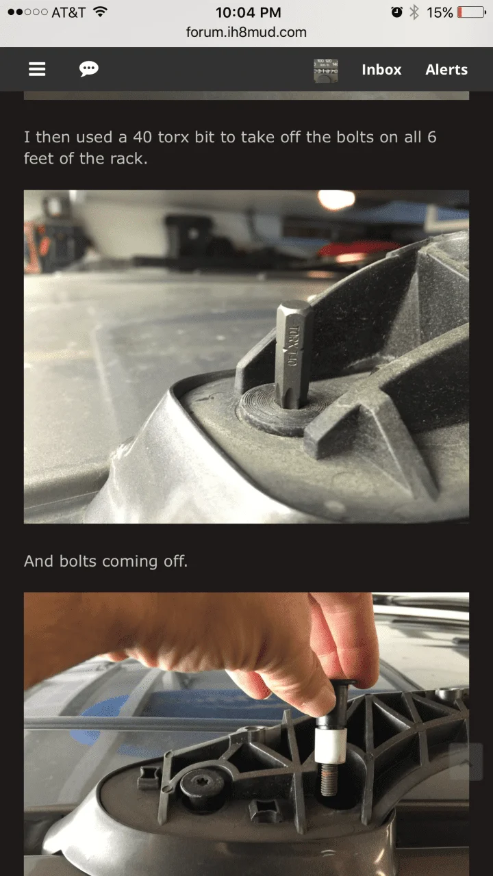

1. Is the Torx bit 30 or 40?

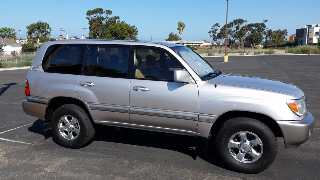

I'm surprised this question has not popped up more often in this thread (even if it's old one). I own a 2001 LC and I bought the T30 bit and it was too small. The T40 was the correct bit size, for my roof rack anyway. If you're on the fence and you don't have a Torx set, buy the T30 and T40 bits and return whichever is not needed. The thread was helpful however and I removed my rack in little time. Might be the lazy route but I just covered up the screw holes with electrical tape - not much rain in Southern California these days.. Looking to repaint and re-install but I actually do like the appearance sans rack.

Here's a pic from my thread and roof rack removal. Its 40 torx bit.

Thanks for the info! I briefly scrolled thru your thread but will look it over in detail. My rack will only be removed for a few days so I'm not concerned about anything entering the holes in the roof. Being garaged and in the dry so cal heat there's little chance of anything more than a spider getting into the screw holes.

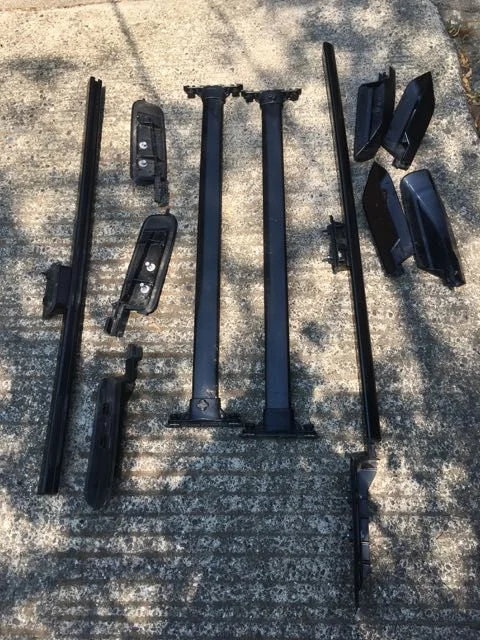

I was inspired by this thread (and because my new Rhino rack just arrived!!) this weekend and took my rack off. I have a 2004 LC with three pillars and the rack mounted to the roof with 12mm bolts. Besides getting the plastic covers off – where I consequently broke most of the tabs off – the job was a piece of cake.
I don't need the rack or crossbars anymore and do not plan on keeping them around. Anyone want the kit? Just a heads up: two of the screws that secure the pillar to the parallel load bar are stripped. The other six heads were snapped off by my drill. The screws rusted themselves in and need to be drilled out. The crossbars are a-ok. Send me a PM if you want it all. FREE.

That bolt seems bigger than T30, I tried to use the T30 and wound up stripping the bolt.
Is it? AUGH...
I amended the instructions to note such variations in roof racks.
Even on my '98 with the correct T30, I stripped a rusty bolt. It was found in a pool of water. I had to trim the mount around it and used a vise grip to remove the bolt.
