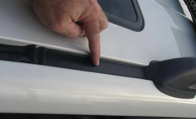

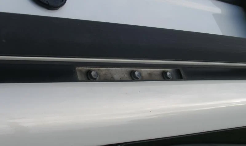

2000 LX 470 has four feet for roof rack mounts but there is another set of mounts under a black cover in between the four oem mounts. This cover has 3 bolts under it when removed.
Does anyone know if this is so you can install a 6 footed rack to an LX or are they for something else entirely?
I am getting one of the first BajaRacks for 100 series but want to make sure and working with John G. to make sure it will work before shipping. I will be taking pics today for him to see it but hoping someone had done it before and put a 6 footed rack on an LX body like mine...
there are mounts forward of the front feet of your 4footed rack that you would use for the baja rack, after trimming back the plastic insert. the cover that you see between your two feet is for the middle one on the 3foot rack.

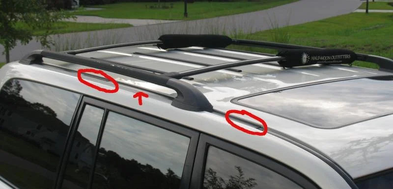

okay i found two bolts under trim by lifting slightly towards front where circled by sunroof...then there is the snap in piece of plastic where circled in rear that has three bolts under it....and guessing there is another mounting location either where arrow is located or further forward in rain gutter channel but thinking it does not make sense to go that far forward due to curve of roof and one by sunroof is enough.
I am sure it will be crystal clear once I remove roof rack and pull the plastic strips away. Thanks for all the input.
Hmm. Is there a trick to removing the plastic strips inside the rain gutter channels without damaging them?
