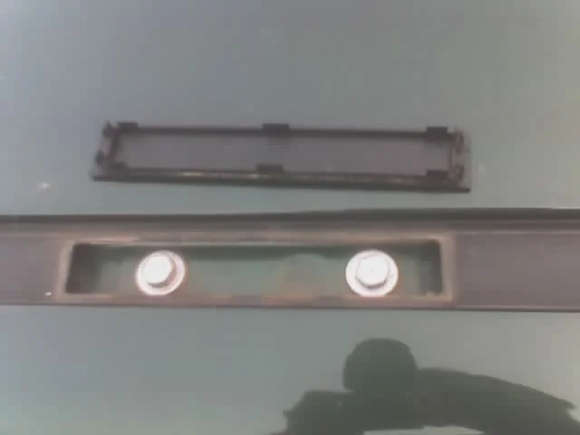

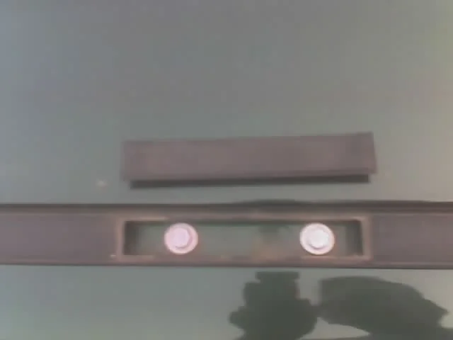

Last night I removed the rack completely. It took about 10 minutes (very easy). I went to the local hardware store this morning and bought some 8mm x 1.25 bolts that were 12 mm long to fill the holes. The only thing left is the covers needed to fill the holes in the black plastic trim. Halfway down the trim strip is a spot for a middle support bracket. I took a pic of this section so that you could see what is needed to fill in the missing trim. I'm going to contact CDan to see if he can get me 4 more covers. I really like the clean look of the 100 without the rack and spoiler. I'll attach pics in just a minute.

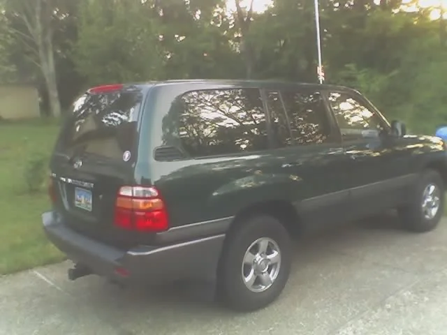

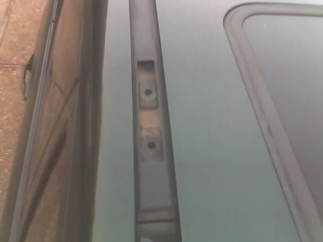

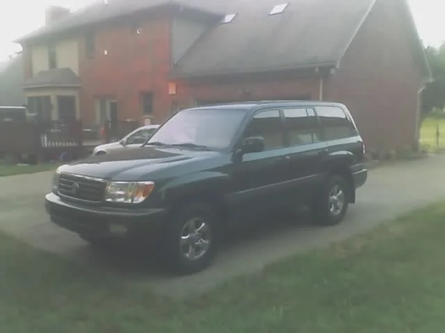

Here are the pics; sorry about the driveway shots. The first two pics are of the middle area that is not used for the rack, but has the cover and bolts available. I'm thinking maybe there are two types of racks and one has three mounting spots instead of just two like mine. The third pic is of the front passenger side mounting area after the rack is removed. The last two are just pics of what the 100 looks like without the rack, rear spoiler, and running boards. If you ever wondered what your 100 would look like with these items removed, now you know! Cheers :beer:

Good news! I just heard back from CDan, the plastic covers can be ordered separately and are $5.94 each and it takes 4 of them. I will post another pic once they are installed.

I just removed my factory Roof Rack. It was a piece of cake thanks to the MUD board.
- Remove covers (4) using small screwdriver between split and gently pry upward until you can pull it straight off (up).
- Remove 4 torx on each side and then slide the entire rack forward (or back can't remember) to disengage the t-nut like hold on the center feet.
- When removing the black strip, it is very easy if you gently pop of the rear end first. Then pop off the front and place a rag or something under the front end while you work. Go to the back end of the strip and slowly push it forward. The windows will reveal the plastic snaps that hold the strip in place. Using a small flathead screwdriver, pop each snap off as you slide it forward and it slides right off!
