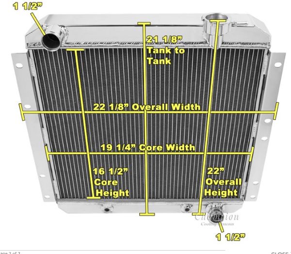

Thanks for the reply.Just as I thought I hit a wall and would be left with no other option but to rebuild mine I measure the distances between the centre of mounting bolt holes and I get approx 535 mm ? Could it be that the different size radiator (A/C vs Non A/C) is only applicable i.r.o. the FJ 40 and not the BJ #4 ?? IOW any of those 4 row/core Champion radiators with the following dimensions
Overall: 22" tall x 22 1/8" wide
Core: 16 1/2" tall x 19 1/4" wide
Inlet: 1.5" located on driver side.
Outlet: 1.5" located on passenger side.
Tanks: 3 1/8" thick
might just fit ? :hmm:
I can now confirm that the OEM A/C(575mm center of mounting hole to centre of mounting hole) vs Non A/C(535mm COMH to COMH) radiator differences in width (and thickness ??), is only applicable to the FJ 40. The BJ 40/2 diesels have the same width(535mm COMH to COMH) throughout.I have therefore decided to go with a 4 core aluminum Champion radiator ! :cheers:

The 4 core alu Champion Radiator from Leadfoot Racing
Here’s what I found, does this look like the right one?
Toyota Land Cruiser Radiator (70-80)
Yeah, that is the one I fitted.The holes all lined up etc, I only needed to trim the corners of the radiator surround/cradle a very little in the corners !
