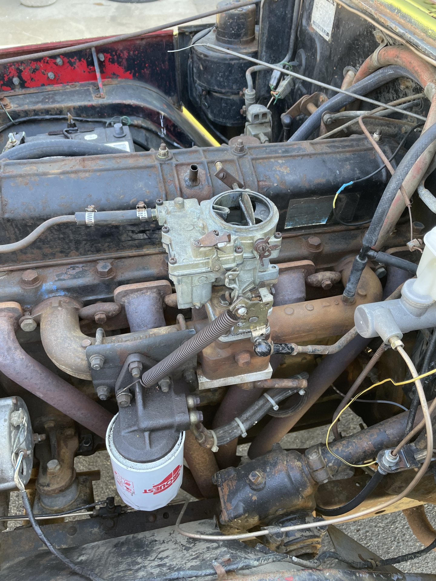

Trying to sort the LV which is a 1966. Rebuilt the carb more times than I should have thinking it was the problem.. it has the old school man a fre header/gm distributor/ Rochester 2g carb.

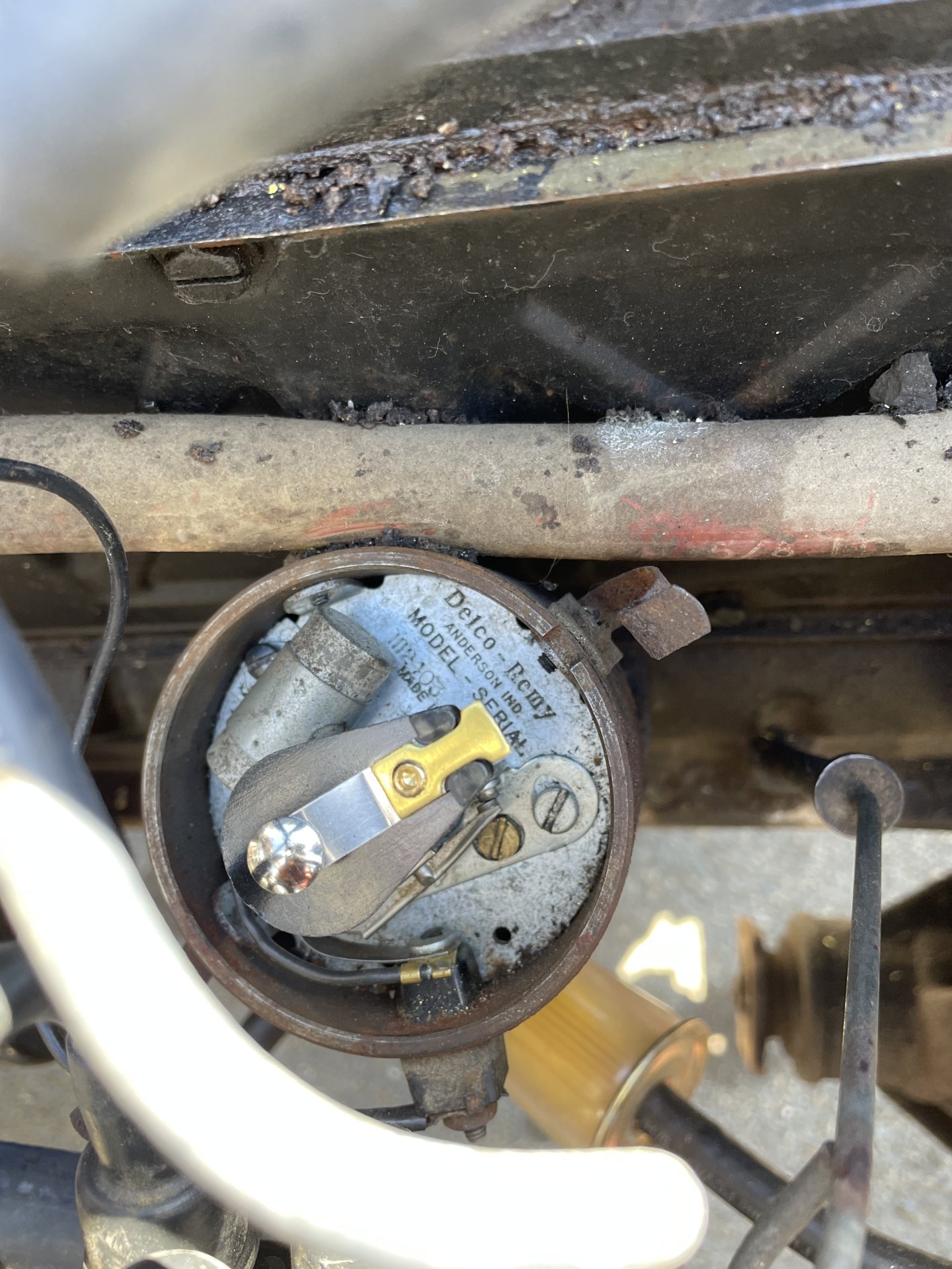

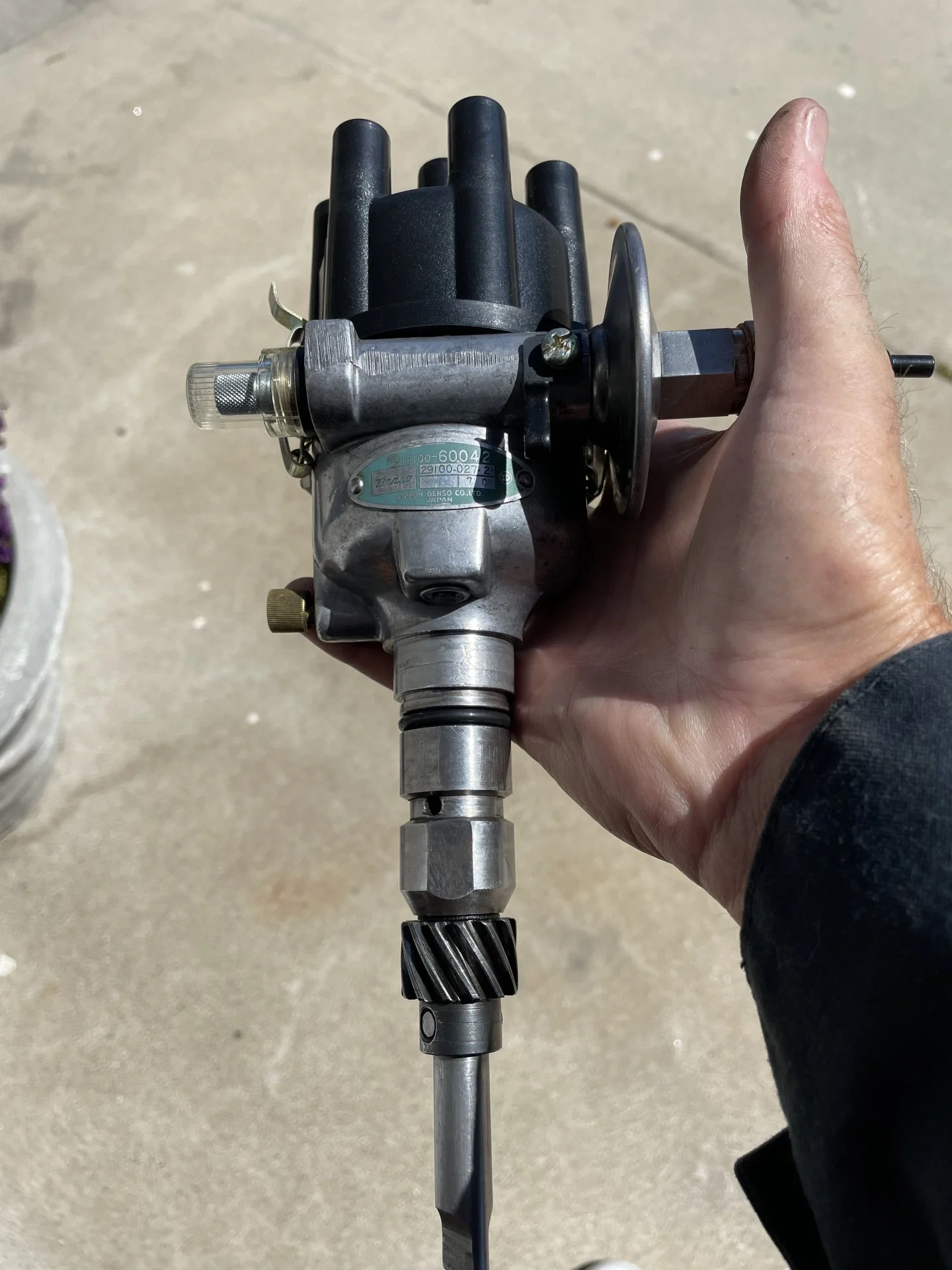

I removed the gm/delco distributor today and put in a rebuilt Toyota one. Newer(good wires from my fj60) new plugs.

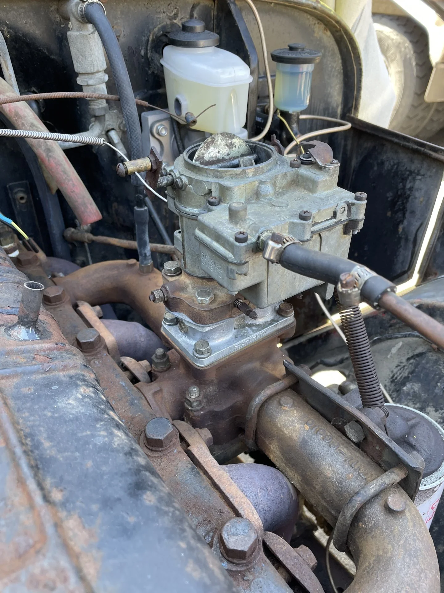

Thinking carb is crap(I know but want to just get it driving ok) the pic of carb is before rebuild…

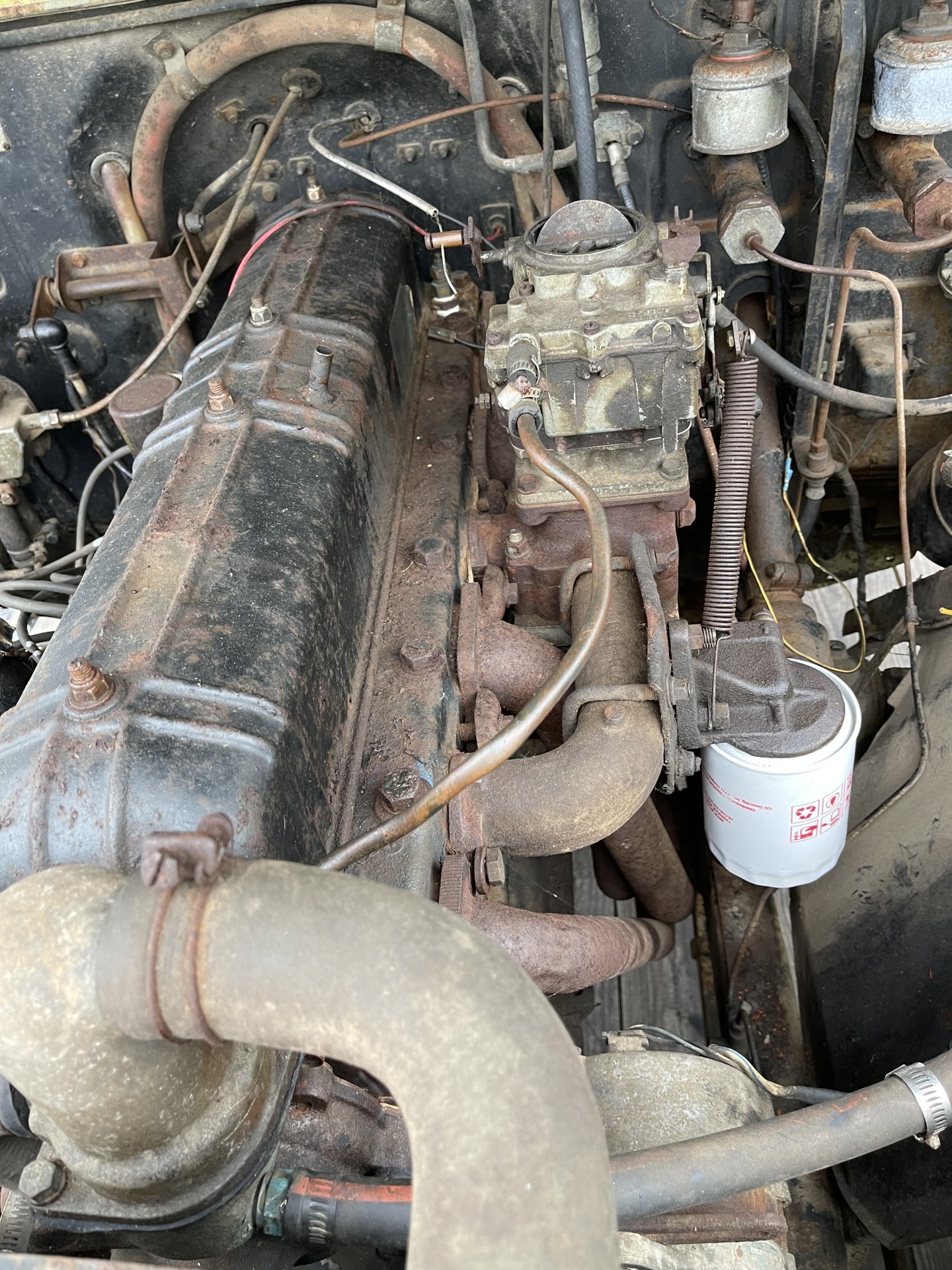

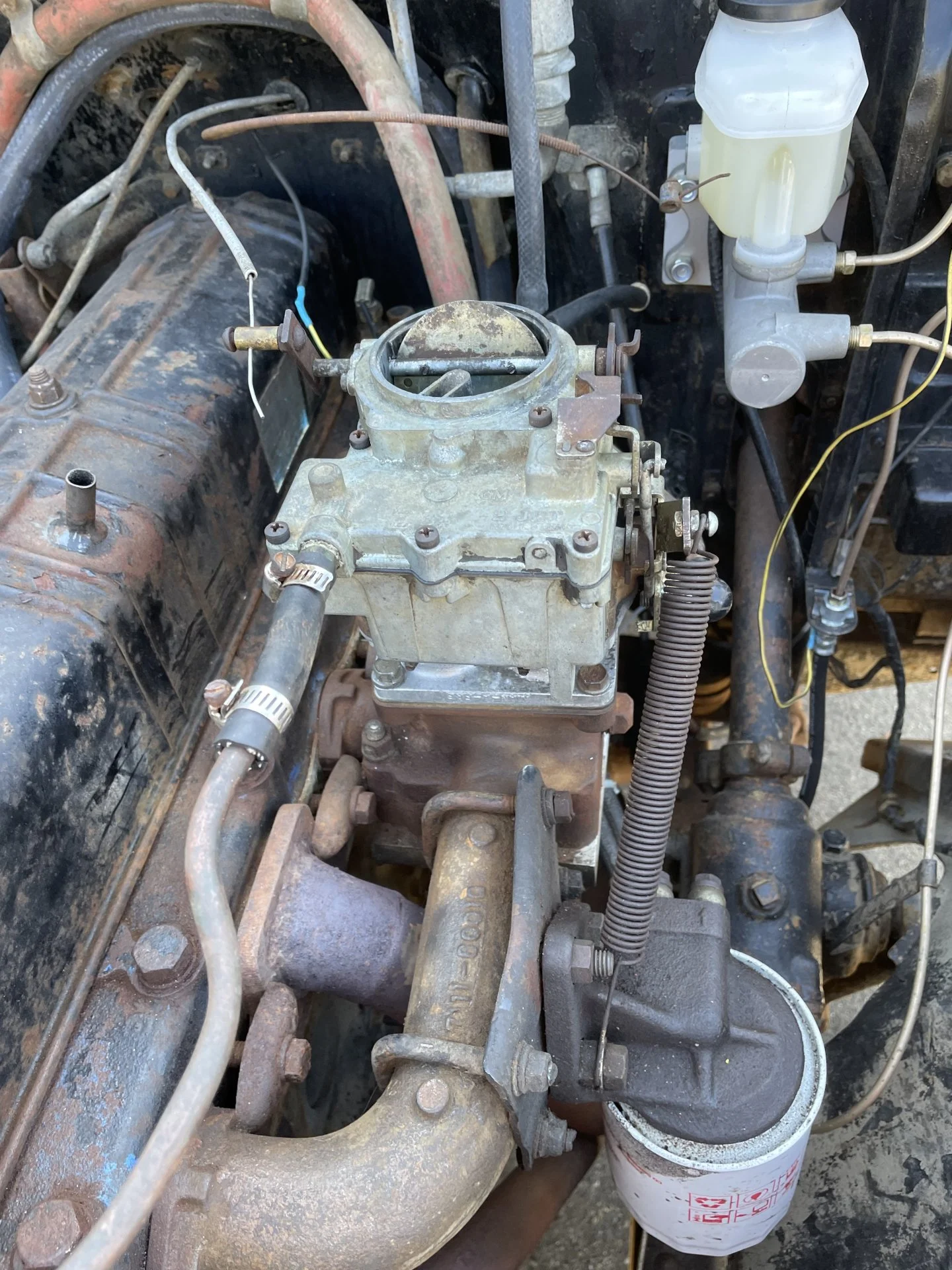

Current pic of the carb/intake, also the plugs are all covered in easy to wipe off carbon.
Yes good shot of fuel from pump. Maybe wrong jets as it was from Montana(altitude) I’m at sea level? Stumped as plugs look like and smells like it’s running rich… but you can cup your hand over the carb intake and get it to rev up better and not sputter out..?

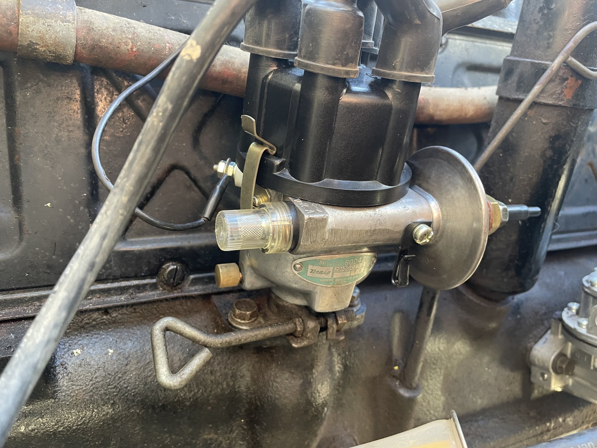

Is it possible you have the Toyota distributor set for high altitude instead of normal?
How do I check that? I just double checked the timing and have tries it at 7 and roughly 10 degrees and same symptoms

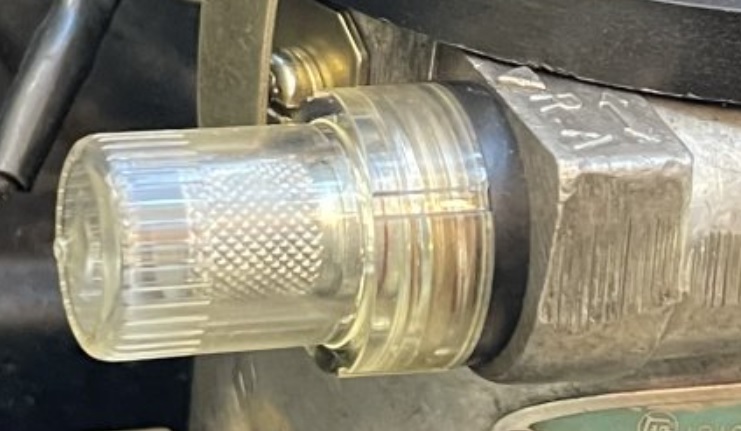

Unless I'm mistaken, the knob under the plastic cap is supposed to be turned toward the block before setting your timing. When driving at altitude, you turn the knob away from the block or toward the "A".

Your Rochester 2G is one of the carbs that has the float bowl open directly to the atmosphere, i.e. air does not have to go through the air filter to enter the float bowl. See rubber boot on top your float bowl (your 8th photo above), every time you give throttle that boot lifts up, then sand/mud/snow/filth (what ever is laying on top your carb) falls directly into the float bowl. Sooooo, that is not an off road carburetor, and since you are lucky enough to have the 2 barrel intake manifold you can install almost any other option you want. I happen to offer a fuel injection adapter for that engine, and also a dual carburetor set up for that engine in case your interest floated that way.
Understood! Just want to get it to run and drive ok then if I keep the orig motor then I’ll explore those options. I got a crappy 2gc off Amazon to see if that helped and the base was a big base not a small so sis not fit well. And ram the same that’s why I chased the distributor.
Sort of. IIRC, that knob is the Octane Adjuster, and is used to advance or retard the timing in small increments. I think that 1 revolution of the knob is equal to 1/10th of one degree in timing.
Handy for dialing in one's timing on the road.
Good eye Chase @red66toy, that needs addressing. There’s also a tee in it, can’t tell where that goes or is just plugged.
The vacuum line for your 4wd system coming off the manifold looks super cracked at the top. Vacuum leak maybe?
Old pic. I replace that and have tried it with the new line as well as capping it .. same result. Sprayed starting fluid all around the intake and carb and no idle change.. back to thinking it might be carb issue.. anyone know of a cheap carb that will bolt to the base where the 2g is? Don’t want to keep throwing good $ after bad $..
