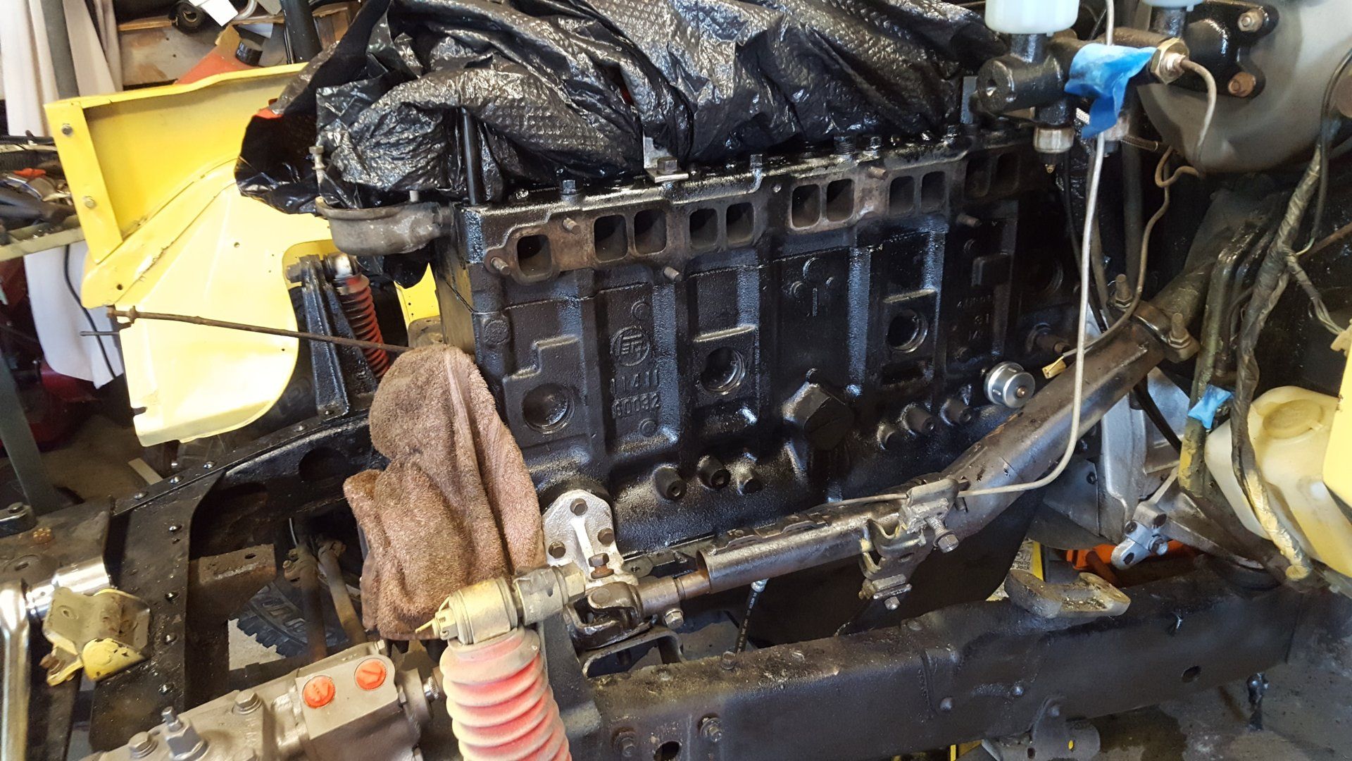

Attached is a picture of the oil on the head, the short block was just re-built (yeah that Sux).
The oil drained out was white. Pulled the oil pan, saw no cracks, but when the trans was being mated to the engine, the Pilot bearing was not lined up and the input shaft forced the driveshaft and flywheels into the engine block. As it was being wrenched into place, that's when I heard the distinctive sound of an engine cracking (it's very distinctive and gut wrenching). The flywheel moved so far forward that the engine would not turn with the starter.

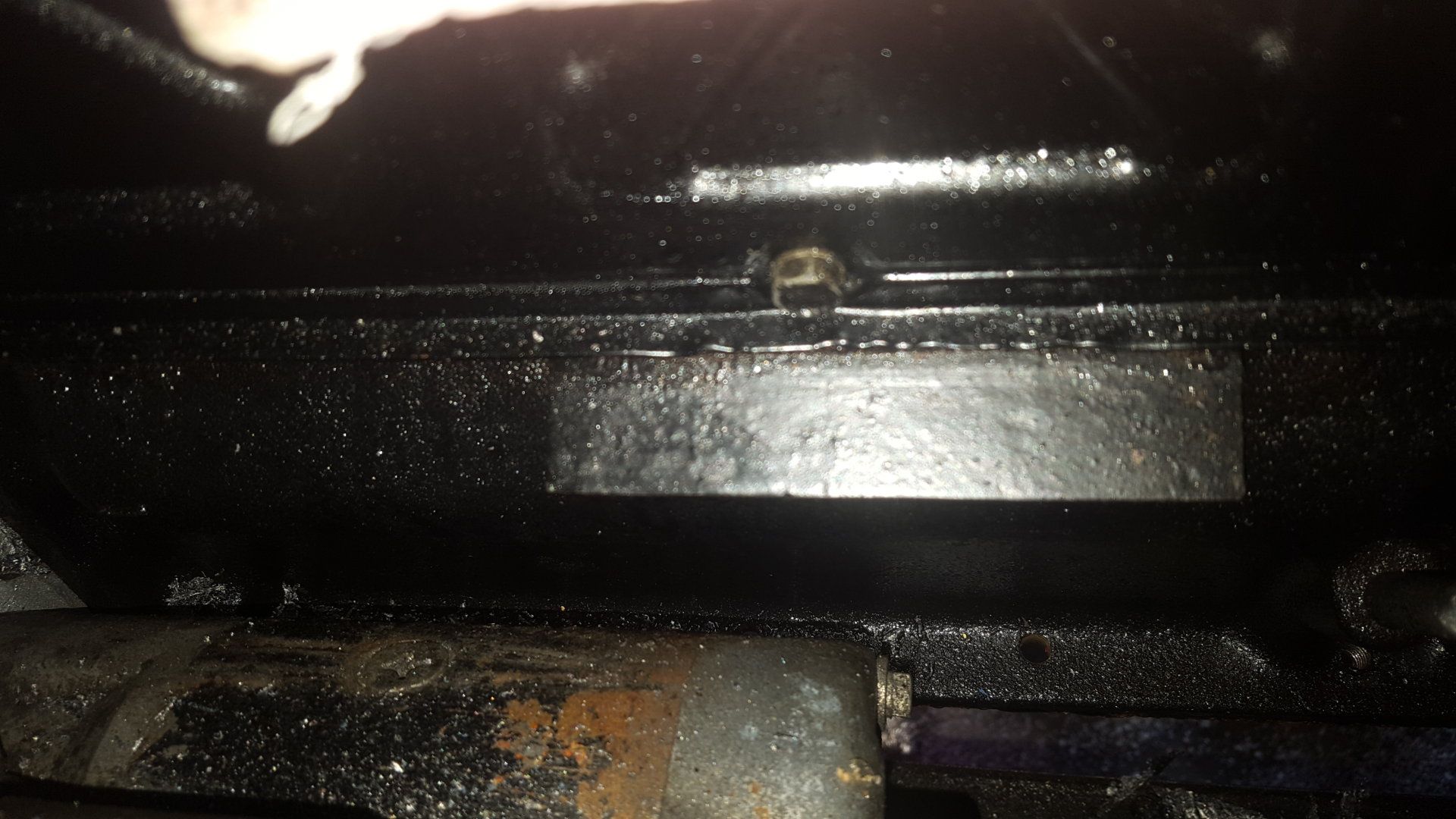

Look at the engine number rearward of the distributor, near the forward end of the starter, I'm sure it was stamped "2F" in one of your photos in your rebuild thread. A 1F just says "F" on it.
I'll checked again, the flat place in front of the starter where it should be stamped isblank. I recall in the thread someone said it was a re-casting.
Boaf.
That I have Attached. What dictates 2F other than the oil filter on the passenger side? Just curious.
Bob
I stand corrected, the picture I saw in your flywheel bolt thread was someone else's engine, sorry about that. Your block definitely has the newer oiling system, but could have been the transition F engine. I don't know from casting number above. The last few months of F engine production the oiling was redone like the 2F. So that makes more sense if the original F engine died and was replaced later by Toyota they used the last production F blocks, but I think they would have to replace the head with it, so it may have been a complete engine replacement. Heads oiled differently also.
