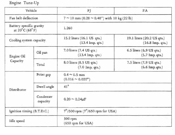

I'm upping this thread because I'm surprised to see numerous posts stating that it's not good for the engine to go lower than 650rpm idle speed.
Actually the 1971 F engine FSM states the idle speed is 500rpm (except for the US but I guess it's for emission?).
Even the 2F FSM states 650+-50rpm (except ECE and US....) so should be fine to run at least as low as 600rpm?

So, why not following Toyota spec on a F engine?
