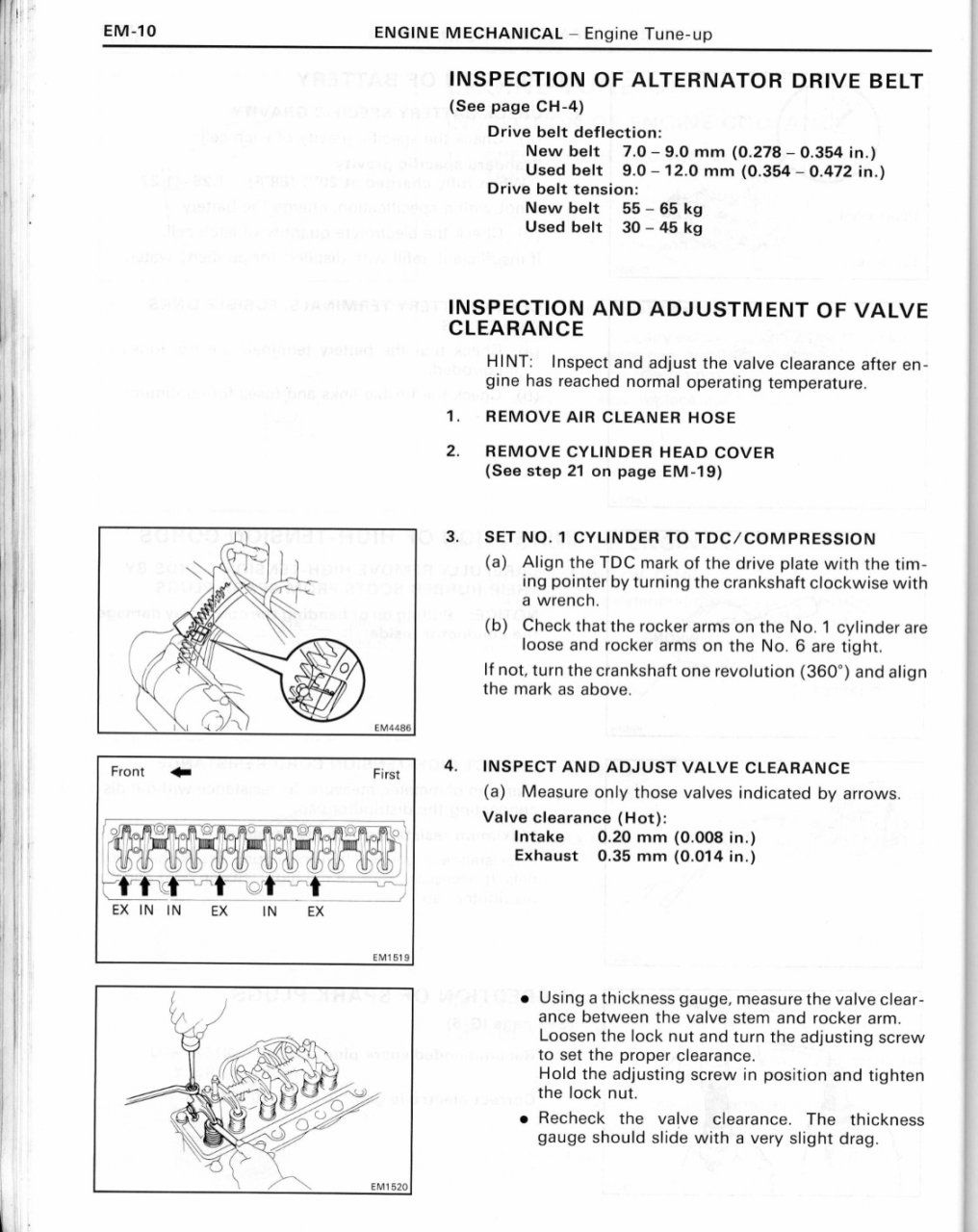

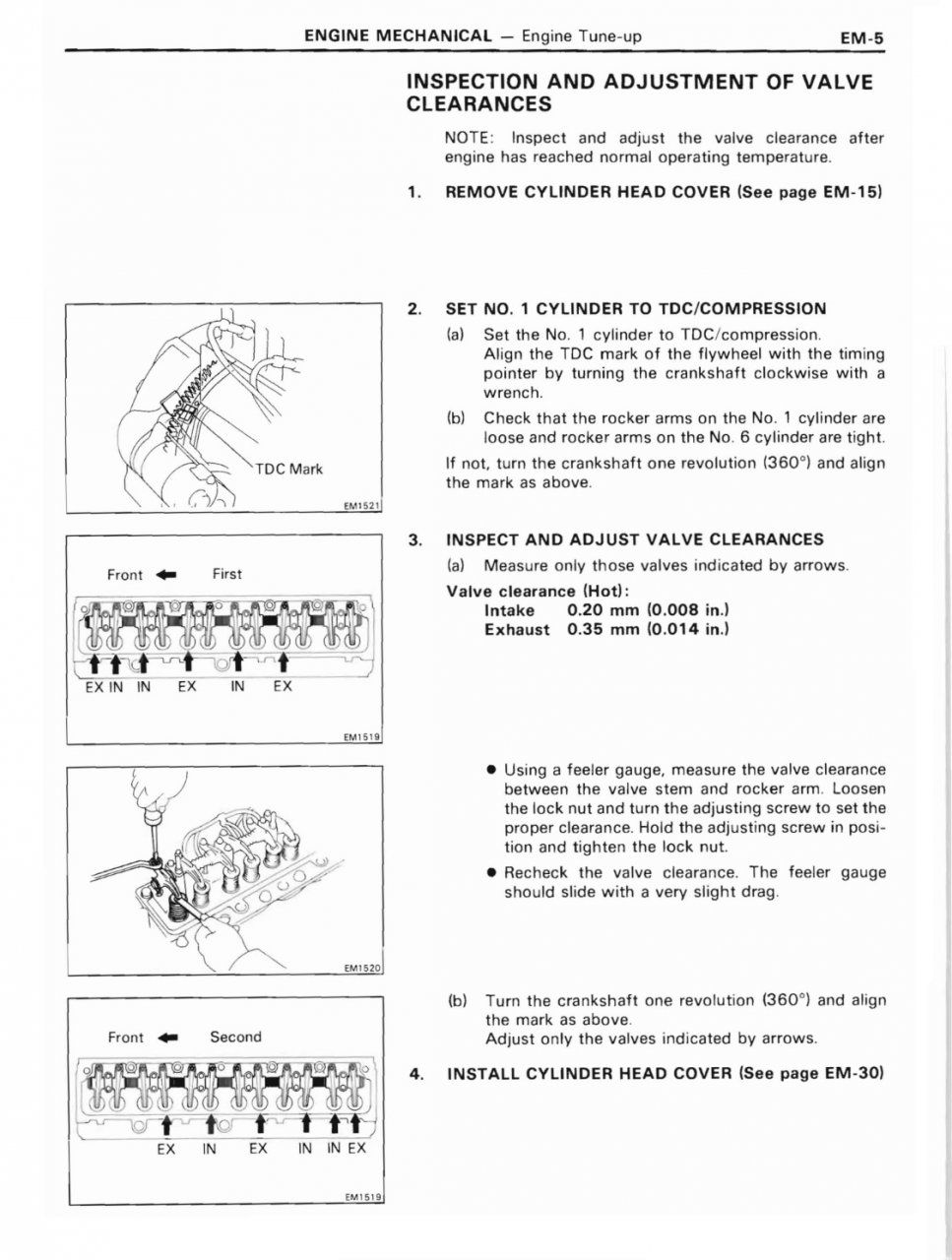

The 3F and the 3FE FSMs recommended checking valve lash at TDC with the engine hot and off. The 2F FSM recommended that the lash be checked while the engine is idling. The valve trains on all those heads are virtually identical.
Therefore it can deduced that the valve adjustment methods detailed in the FSMs were recommendations, not commandments and either method is fine.
Just to add to this, the 3FE valves on the 3FE must be done with the engine off. To access the valve train EFI components necessary for the engine to operate must be removed.
