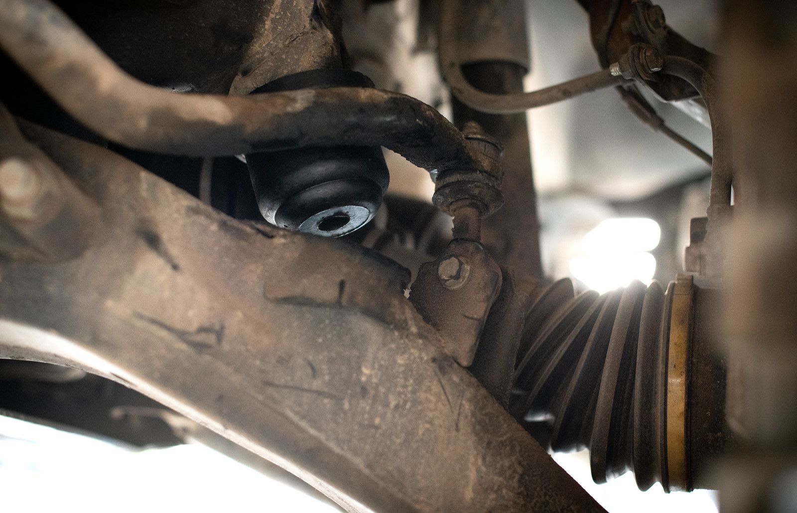

I have two Timbren bump stops mounted on my front lower control arms and have had zero issue over many years of bombing around. Can't tell you how many compression hits the spressoWAGON has had...but it all works. Now, remember, like many other rigs, my suspension is all custom (except for the front LCA). What works for me isn't necessarily the ticket for another rig with different UCAs, shocks, etc.
It all boils down to cycling a given suspension and fully knowing where the extended and compressed bottom out is and then working backwards to protect the ball joints and/or shocks. The Timbren bump stops are cheap. The best would be to have a true adjustable bump stop but the space limitation for our IFS system is a real limitation for hardware. I would love to have a much more progressive compression bump stop that didn't result in such an abrupt stop...ala OEM or Timbren as discussed here.
Yes, I'm also running Timbren frame mounted bump stops on the rear suspension to protect the shocks from compression hits. But, again, you need to cycle your system to fully know WHERE the compression limit is and then work backwards (via compression limiters...) to protect the shocks in this example.

Ok good deal. I have Carl's old truck that he set up himself so I should be good too. My setup has the Icons with CVDC, Nitro UCA, and I have 2 Timbrens on each LCA as well (4 Timbrens in total up front). I haven't had any issues with my ball joints. Thanks for the help.

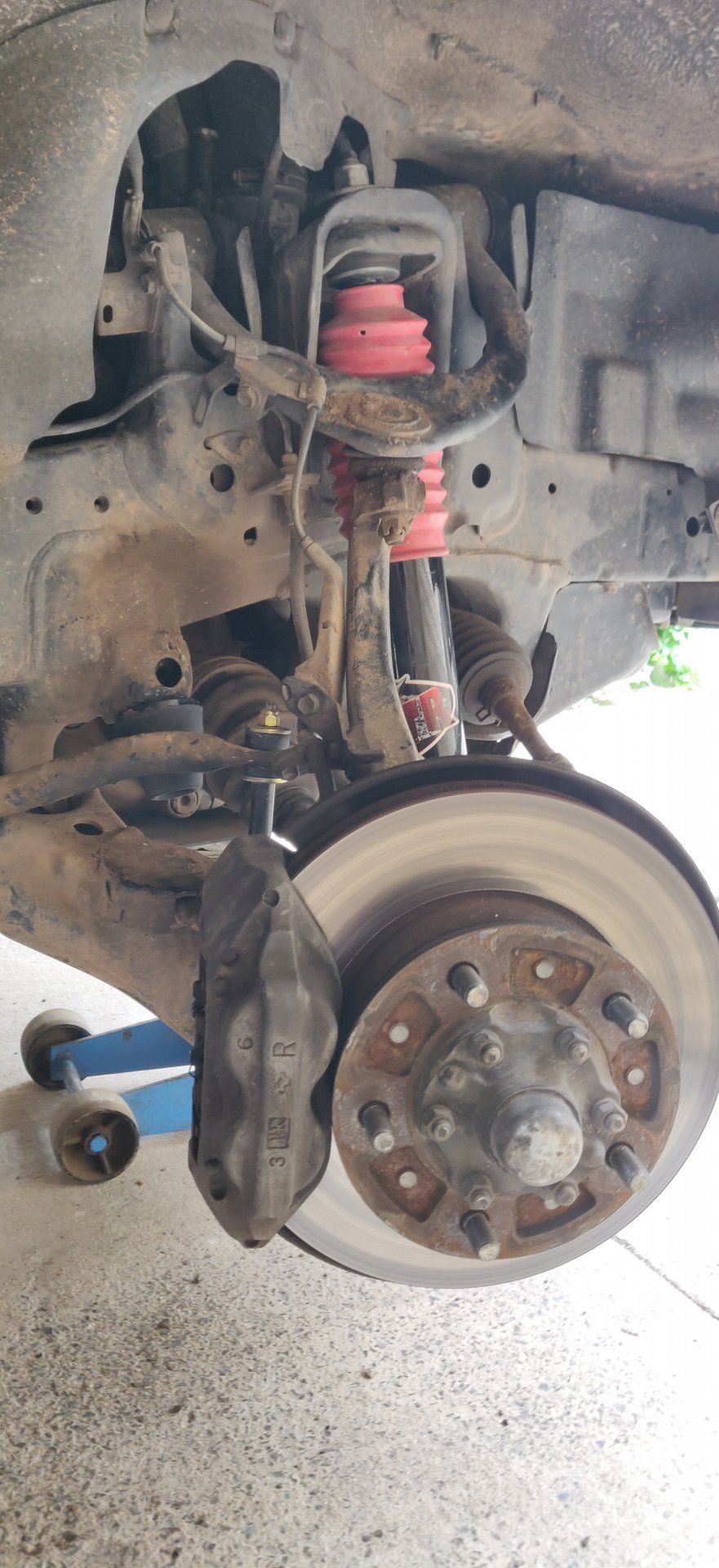

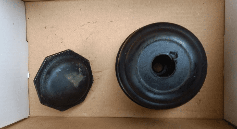

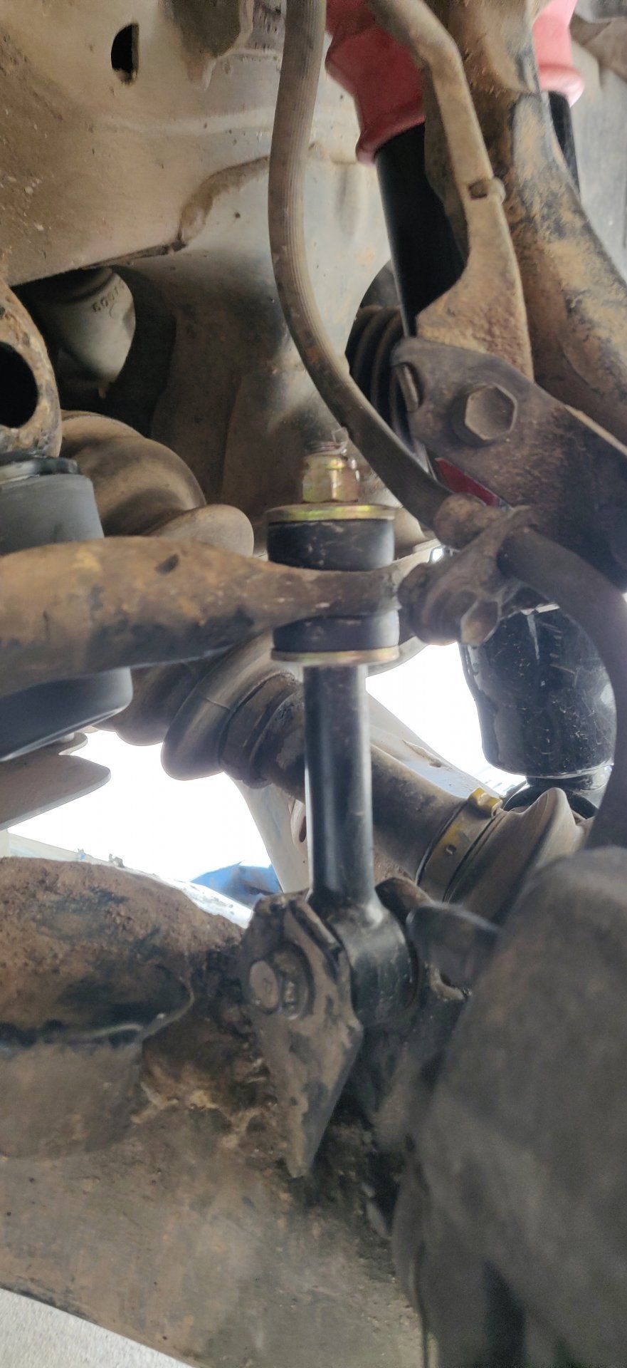

I got my Wheeler front bump stops in yesterday and put them on, these things look huge! One thing to keep in mind is this have way more give if you will then the stock ones so they are not going to limit upward wheel travel as much as they look like they will. I will get them out on the trail soon and report back how well they work for controlling 35's. I also ordered the 1/4 inch spacer to throw in also.

I'm liking the front bumpstops so far. I have the Wheeler front bump stops

I got a set and put them on yesterday. On road has a stiffer, more responsive suspension feel but not rough. Off road has a smoother response on hard bumps and has taken most of the harshness away. So far I’m pleased with them. When I finally upgrade to a swing out style bumper and heavier springs I may move to putting on rears.

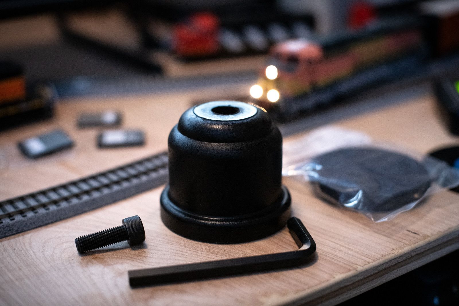

Just installed a set of 4 today. I have a set of Timbrens for the rear. So I will be running both brands.
I found a trick to ease installation. I took the hex head cap screws and wrapped some double-sided tape around the threads just below and touching the bottom of the head. That allowed me to screw the cap screw into the bump stop so it would hold tight. Then I was able to spin on the bump stop with the screw into the mounting hole and run up the threads to hand tighten. After that, it only took a few turns with the enclosed Allen wrench.

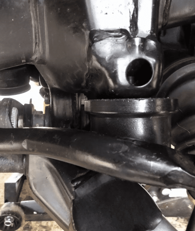

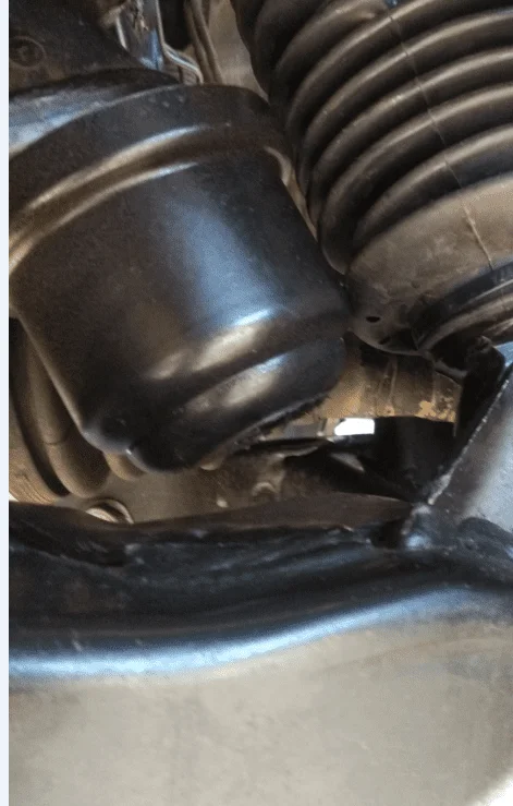

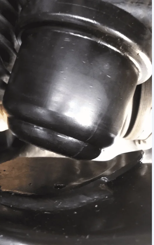

Regarding the wheelers front bumpstops: Did you happen to measure before & after up-travel? Any idea how much up travel is limited?
I don't have specific measurements. I can say the opening is very close at normal height with a 2" lift.
It would be interesting to take some chalk and rub it on the LCA contact points to see how far the mount touches.

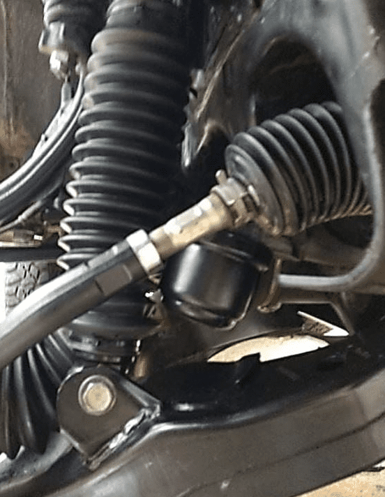

Oh.. I just found this thread. My results are on par with the information provided in this thread. I have nothing new to report other than I like it.

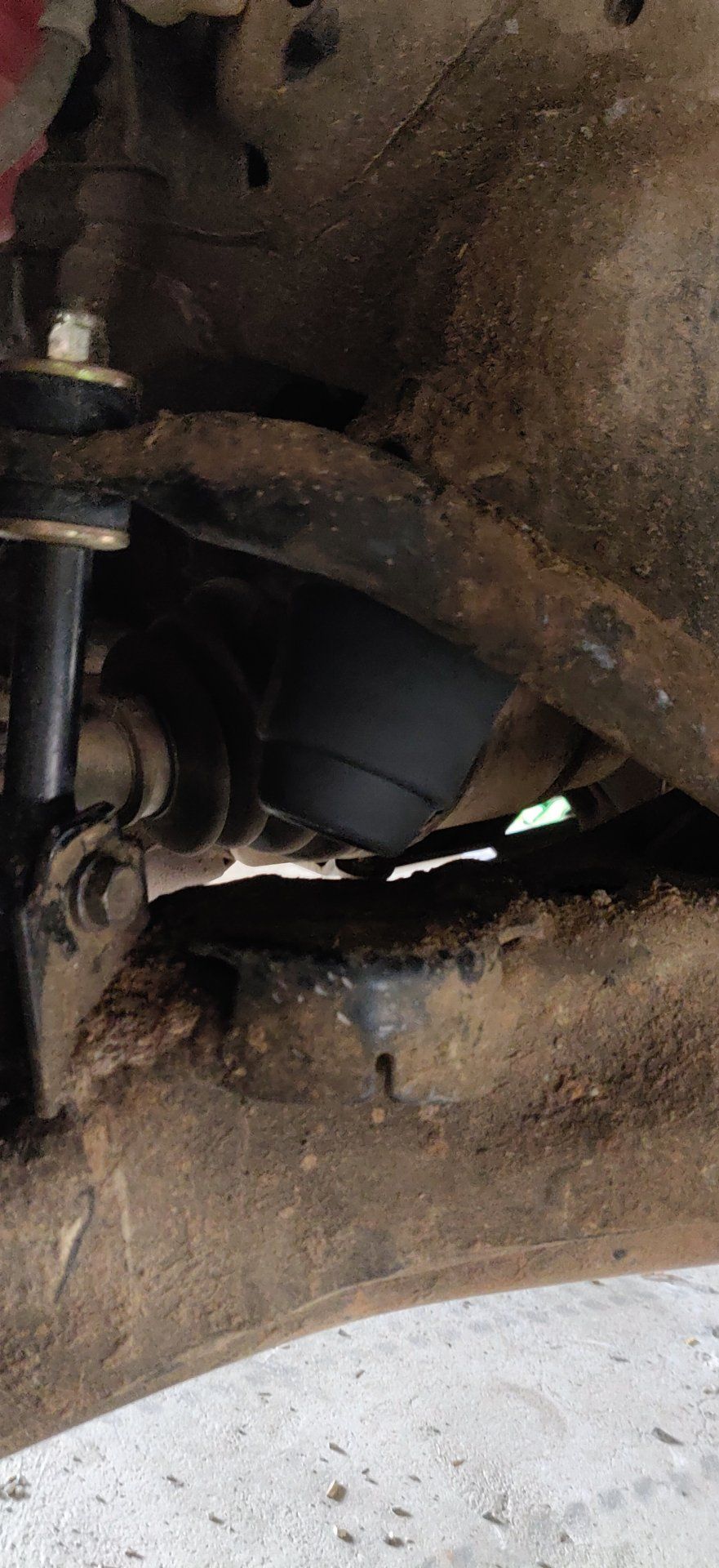

Sorry didnt get a chance to clean all the mud from my last outing.
But here are the Timbrens installed in the rear:
compared to OEM lol:
