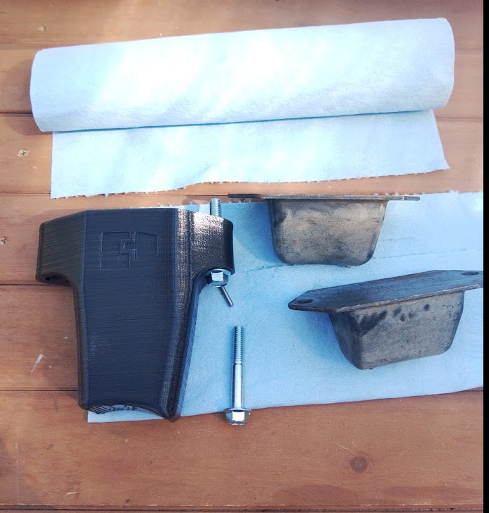

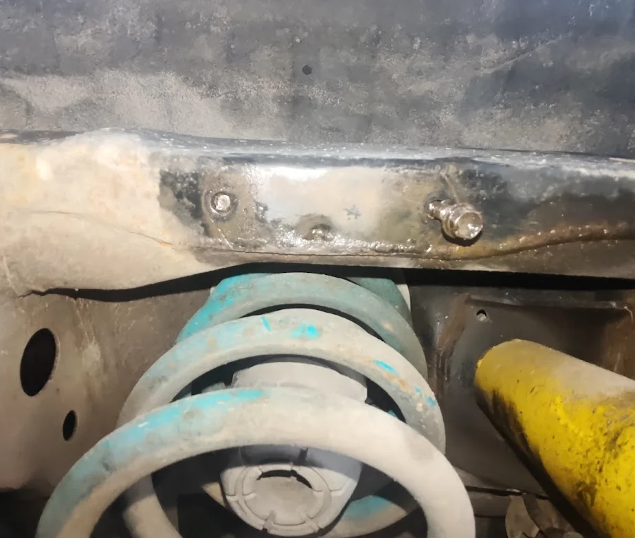

Check out the OEM compared to the extended rears. Oh and remember, don't be an idiot like me and rush. Soak those old rusty bolts in the rear, crud in the frame has made them delicate. I snapped 3 of my 4 bolts before having to pay someone to repair and install my originals back on lol so I never did get the rears installed
View attachment 3777961View attachment 3777962
