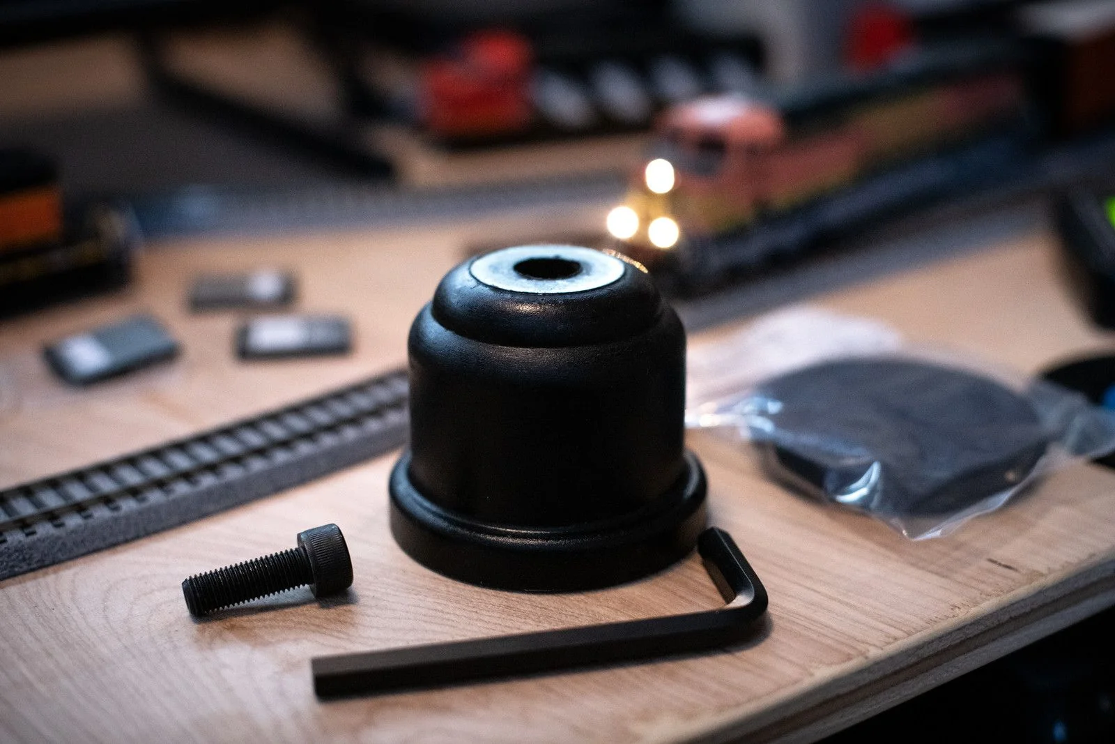

i ordered my timbrens for the rear, but those duros look like they might work for our fronts. I have some amazon "universal" bumpstops on the way and i am gonna experiment with a couple of them.

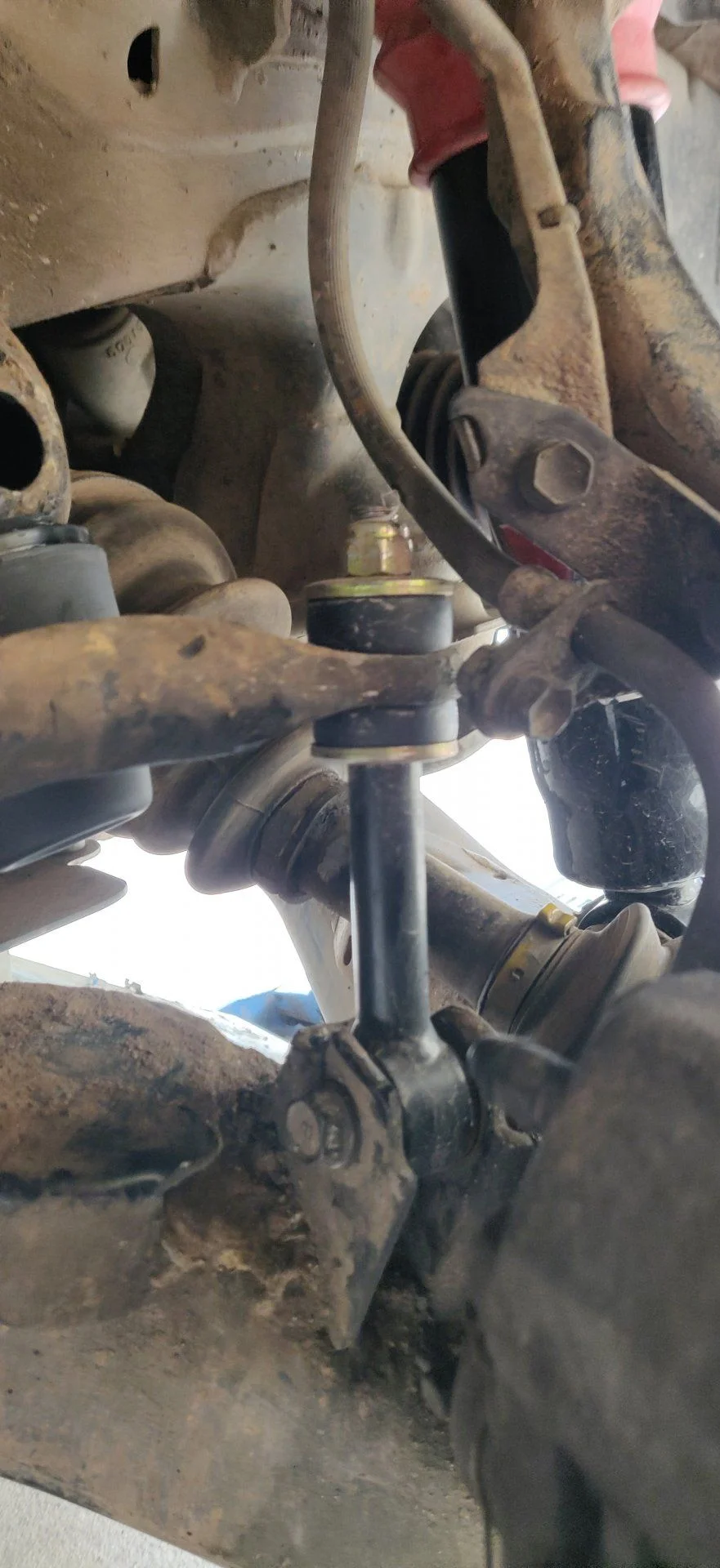

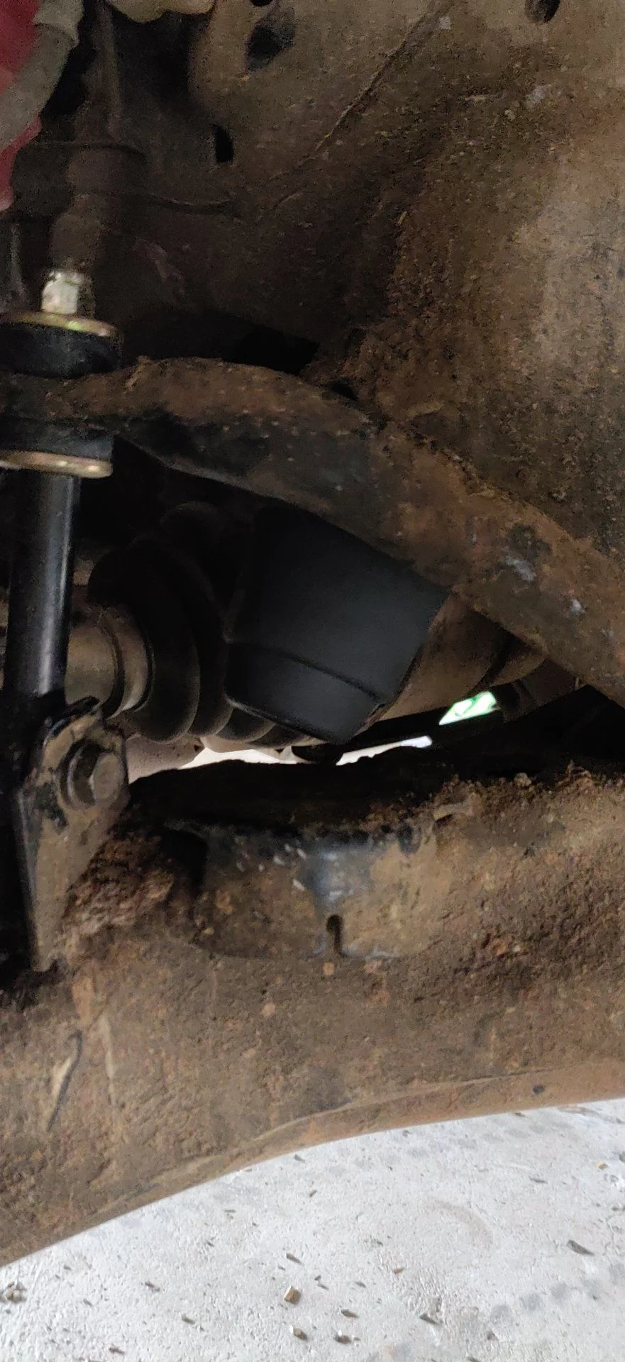

But here are the Timbrens installed in the rear:
compared to OEM lol:
Those look really good, grab some flex shots next time ya go out and let us know how ya like them, good stuff!
