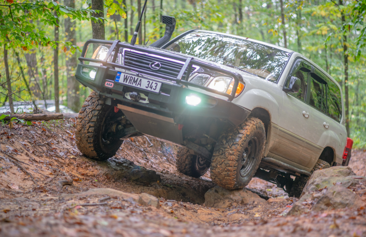

I'm running dual Wheelers in the front. As you can see from the wear points in the picture, both are engaging at the about same time.
I do have extended length Trail Tailor end links front and rear with an additional inch of droop in the front that is provided by the shocks.

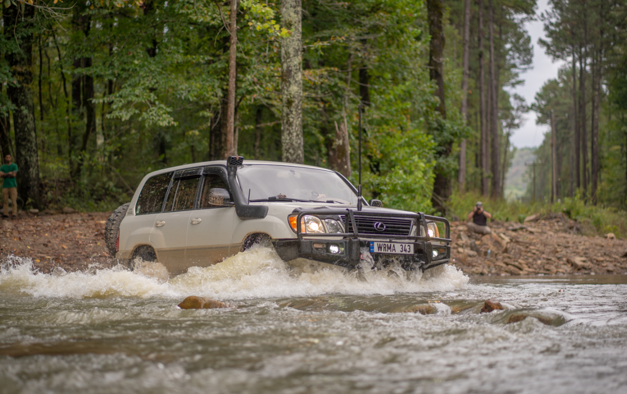

The front bump stops come in handy during water crossings when I'm driving over a water covered rock pile that I can't see.
That's where the front suspension takes a lot of unexpected hits.
You can see the rocks sticking up out of the water in the picture below.
As you can see in the picture, the extended bumps don't engage on a crawl over. Its to soften the blow and help with control when you land on the other side.

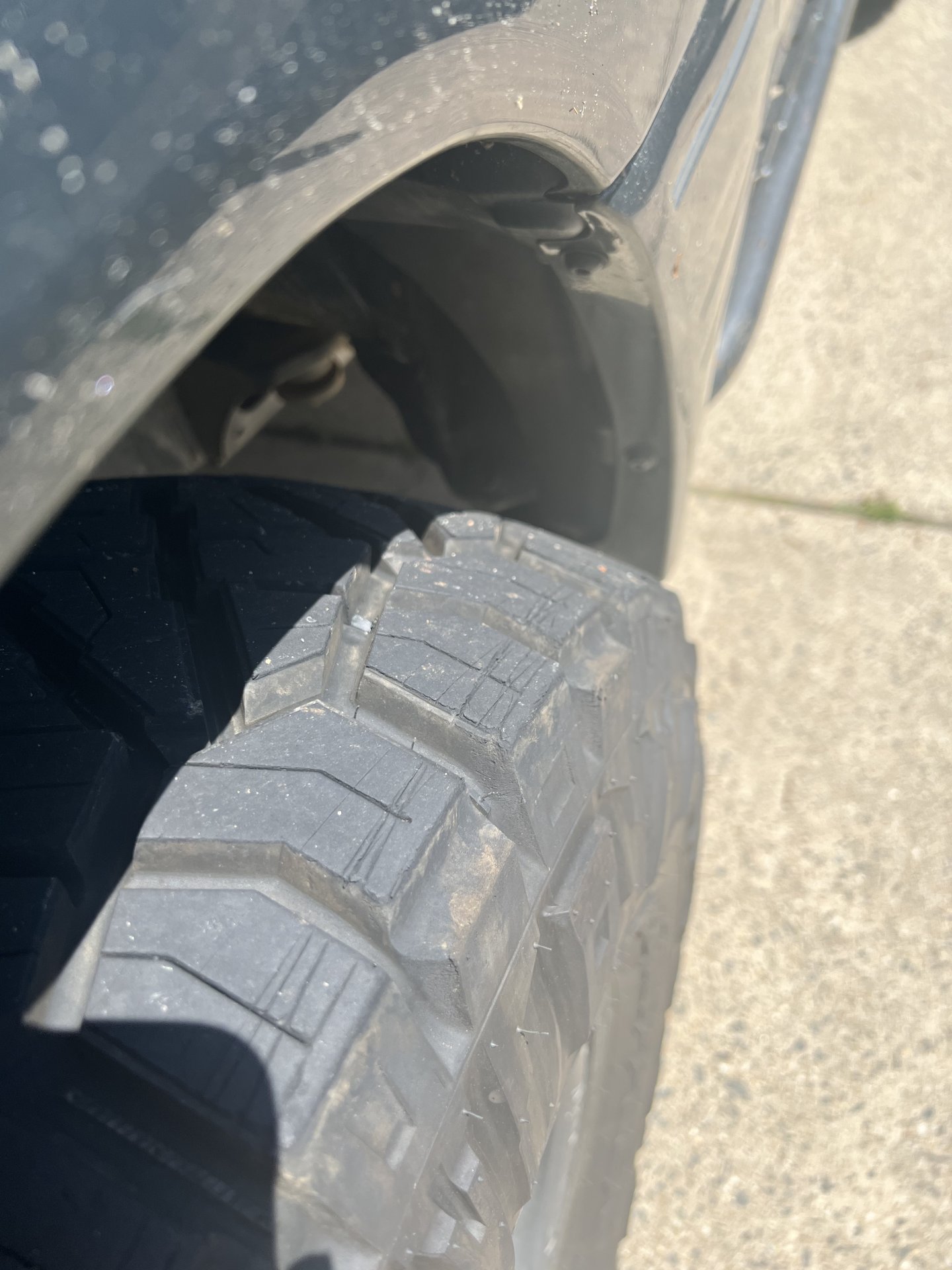

So with just one of the bump stops up front, they don’t quite do the job. These are SCS F5 wheels. This is after some very hard testing. Under normal off-road conditions I didn’t experience any rubbing or slicing. I think I’ll add another pair of stops to the front and see how that goes. If that doesn’t work, we may roll the fenders a bit. Just reporting back with some real world testing.
I’m running dual bump stops now and there’s been no change, the suspension will still compress enough to allow fender rub with this wheel and tire setup. This is all going to be pretty dependent on ride height and what shock you’re running, but I wouldn’t look at these bump stops as real solution if you’re worried about rubbing fenders. It happens in the fast paced stuff with hard hits. The video posted above is some easy crawling, it’s doubtful myself or anyone would be compressing/using the bump stops much if at all in that situation.

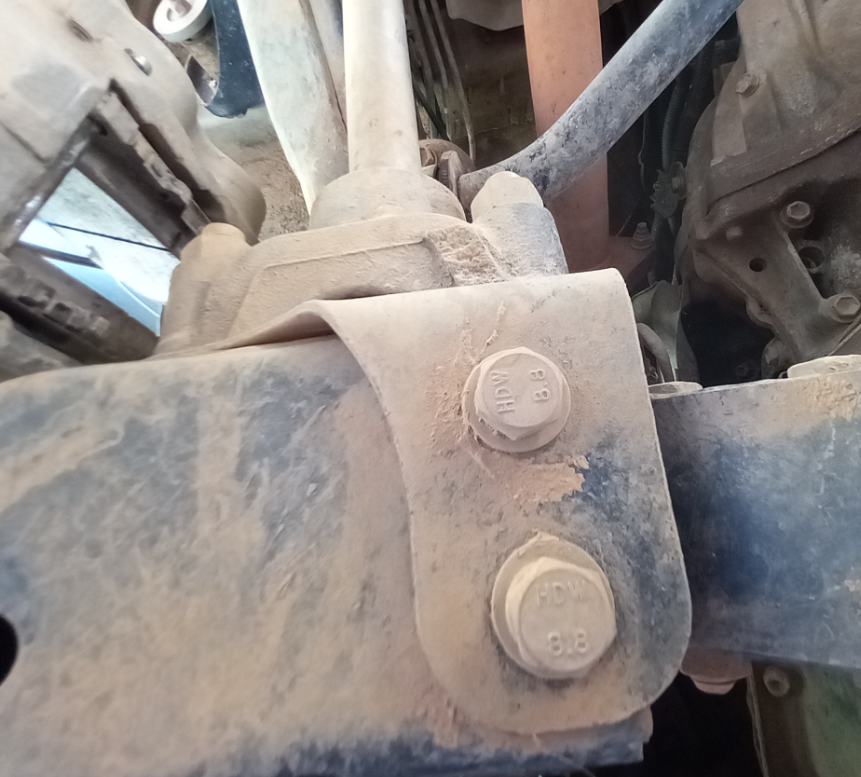

Replacing bump stops with Perry Parts. Fronts went well but all the bolts on the rears snapped. I don't have power tools so I just got my wrench on there and the heads just twisted off. Lots of crud in the frame maybe rotted them out and I'm never patient enough with the PB
Anyway, it seems like if I remove the rear tire I've got enough clearance to get a drill in there , hopefully.
So what's the technique here ? The bolt is super rusty so I doubt I'd be able to extract it back out . Was thinking just drill right through it and then re tap ? Maybe have to tap a larger size but hopefully not because I'd have to modify the bump stop for bigger bolt.
Shoot that may not work if it's just a little welded nut I side the frame .

If you have enough of the busted bolt sticking out, weld a nut on the end. The heat shock will generally free it and it'll spin right out.
If that's not an option, a long soak in penetrating oil, I'm talking spray it a couple times a day for several days running, then go at it with a left handed drill/extractor. If you're lucky it'll spin free, if not then you'll eventually drill it out. Then you'll have to deal with the damaged/missing threads, but there's options there too.
