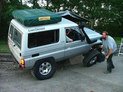

The truck looks great Bruce. I can't wait to see it in action.
I can't say I miss the frantic last minute pre-trip wrenching - I had enough of that a few weeks ago getting ready for Rubithon.

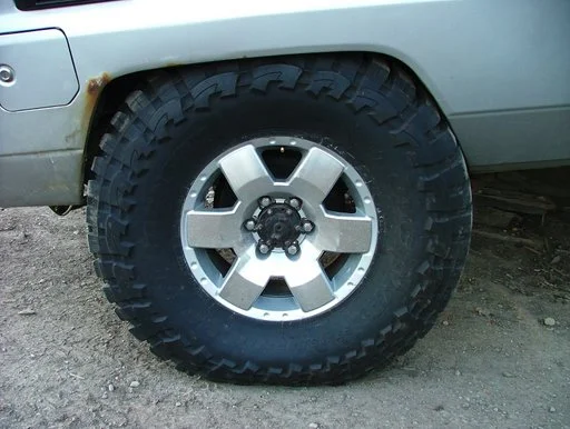

FWIW, I saw the Toyo's in action on the trail and I noticed they have a much more "open" tread pattern than the MTRs. Still I'm not sure anything short of a hover craft can clear some of those AK bogs.

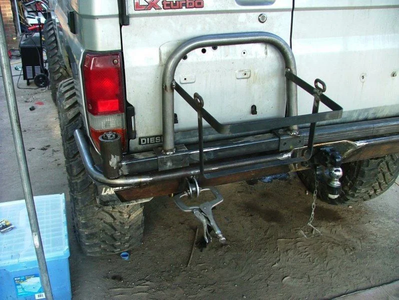

The weekend went really well. The list is now whittled down to the items in red. The big items are rear brakes and shock mounts. Also, missing from the list is exhaust. I'll take drop it at the exhaust shop tomorrow for a nice straight piece of 2.5"

Run 1/4 plate though bumper form frame done
weld additional plate beside for d ring mounts done
Tire carrier
weld spindle to bumper done
build carrier using 2x2 tubing done
Fuel can carrier
build carrier using 2x2 tube and flat bar done

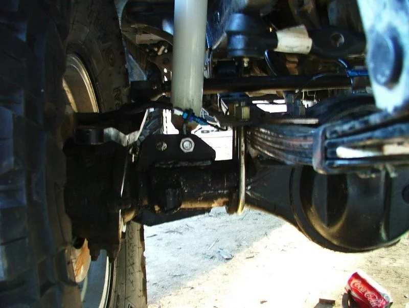

You're right. The stock shock towers have to go. They are crappy anyway, I busted them off my BJ70. I'll make some hoops out of 1.5" tube. The axle is going forward about 2"
Here's the hoops.

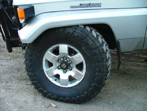

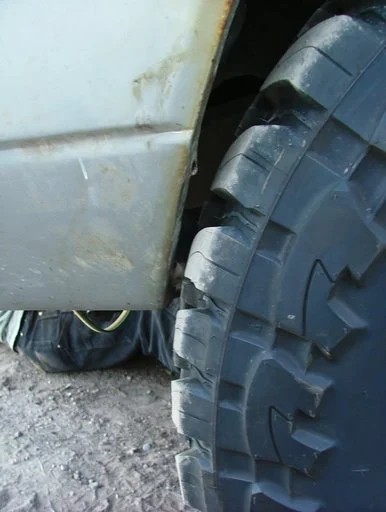

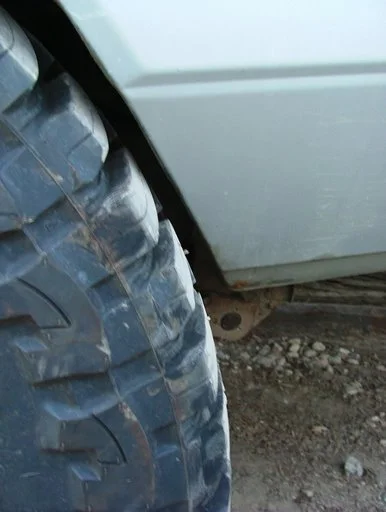

Well, surprisingly no rub on the lips of the wheel wells. A bit on the inside of the tubs and, as expected at the front of then fender on the inside. Mr Toyoda planned 70s perfectly to accept 37" tire and not a 1/4 inch more without trimming.
