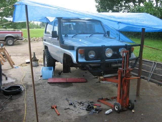

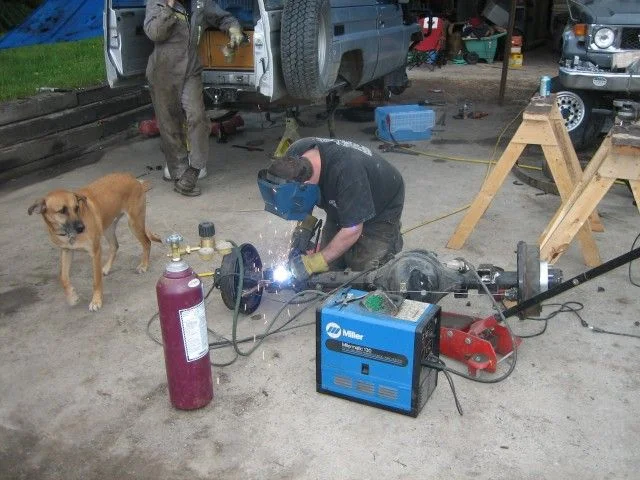

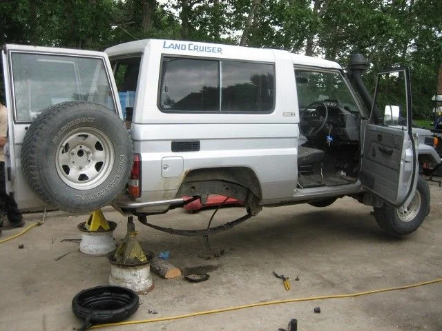

I got a bunch of help yesterday and we were able to get the axles in. I've been looking forward to this part for quite a while now and I'm really glad to have that heavy work done.
The side panel constuction starts tonight. They will flip open for access to the wheelwell space. Hopefully there will be room for a yellow top optima and an air top webasto down there.

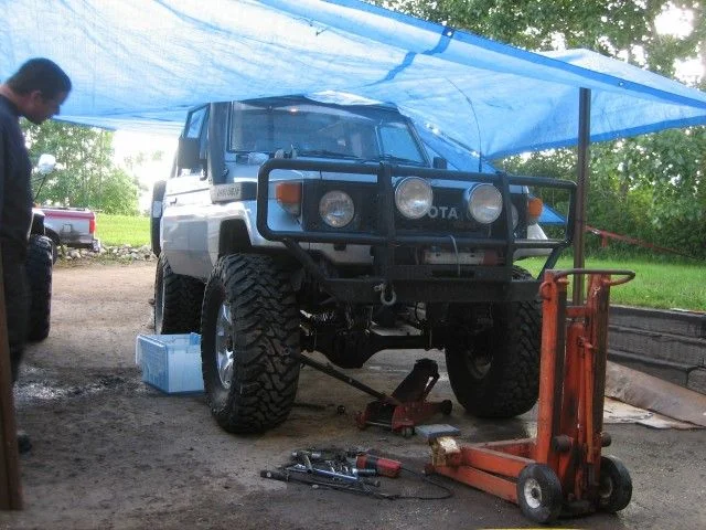

From the last photo it looks nice and low. Did you de-arch the front springs at all?

Your doggie needs a pair of welding goggles.
Yeah, it was storming out and he's got a policy to be within a meter of me when its lightning. I guess he figures I'll get struck first because I'm taller.
