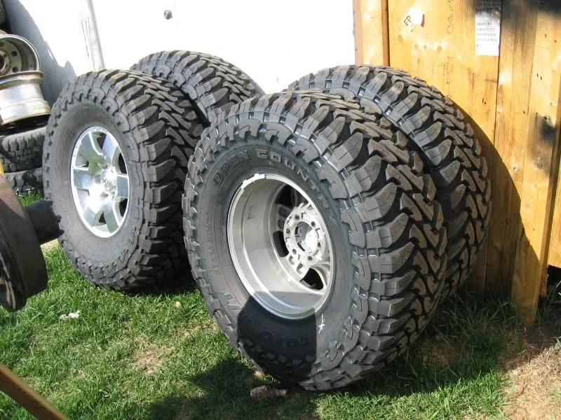

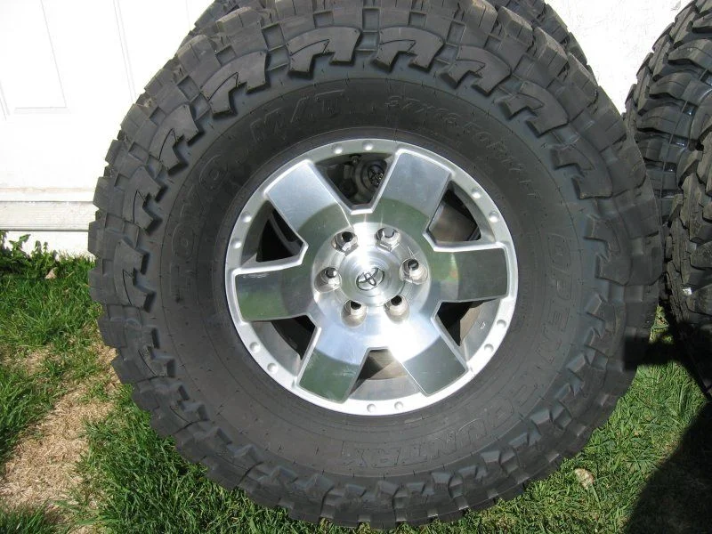

I guess its tnme for an update. I've been working on a lot of stuff but haven't really finished anything in the last few weeks. Today, however, I did manage to drag the bumper off the parts rig (that's now sold) and move it to my truck. I also swapped the chrome mirrors for some nice new black ones. I painted the grill black as well. I think the truck looks much better now.

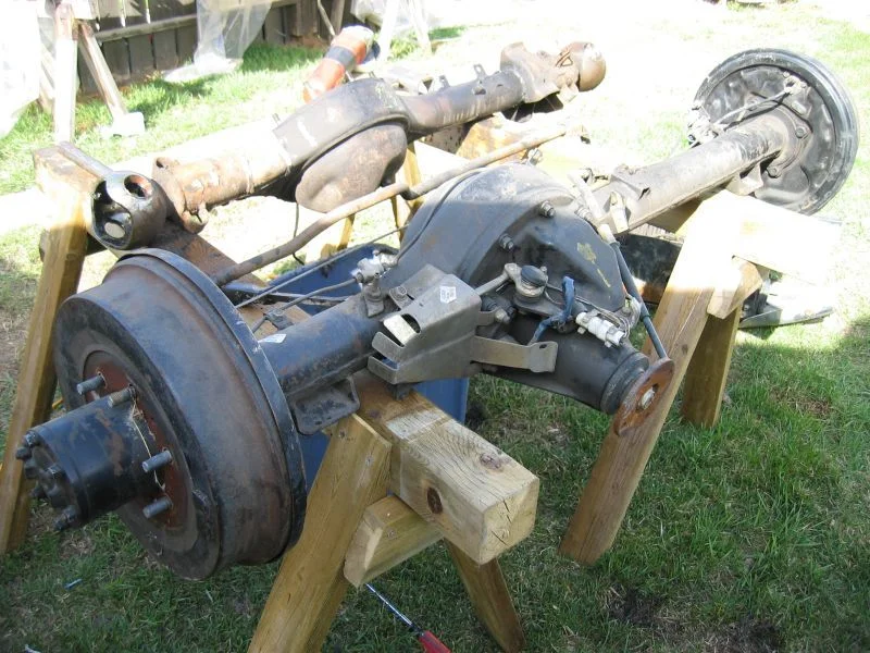

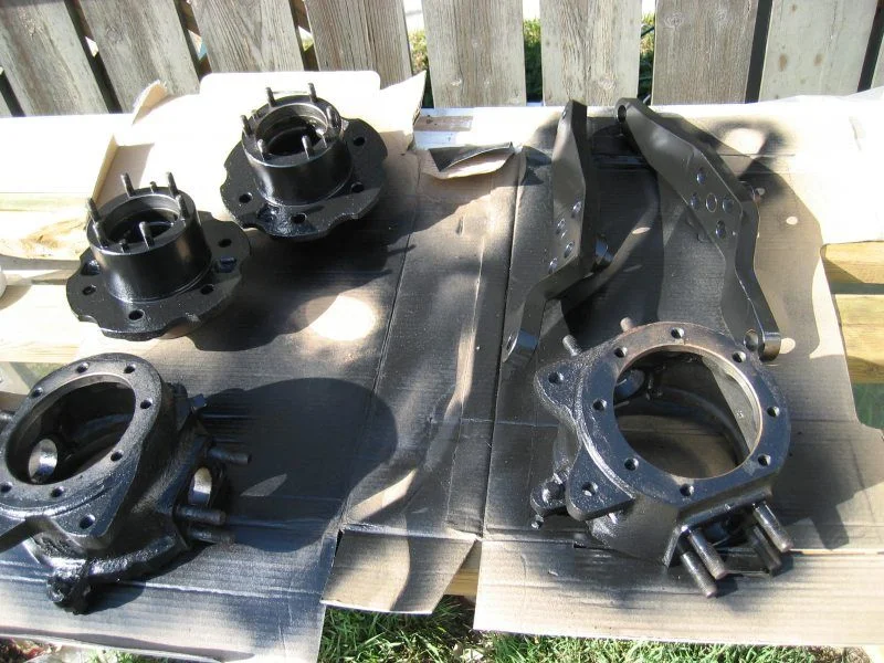

I have been working on the axles. I stripped the front and painted some of the parts. I hope to have the perches gussets and shock mounts on tomorrow. and then I'll reassemble them. I have all new bearings, seals rotors calipers etc.
Anyway heres' a few pictures.

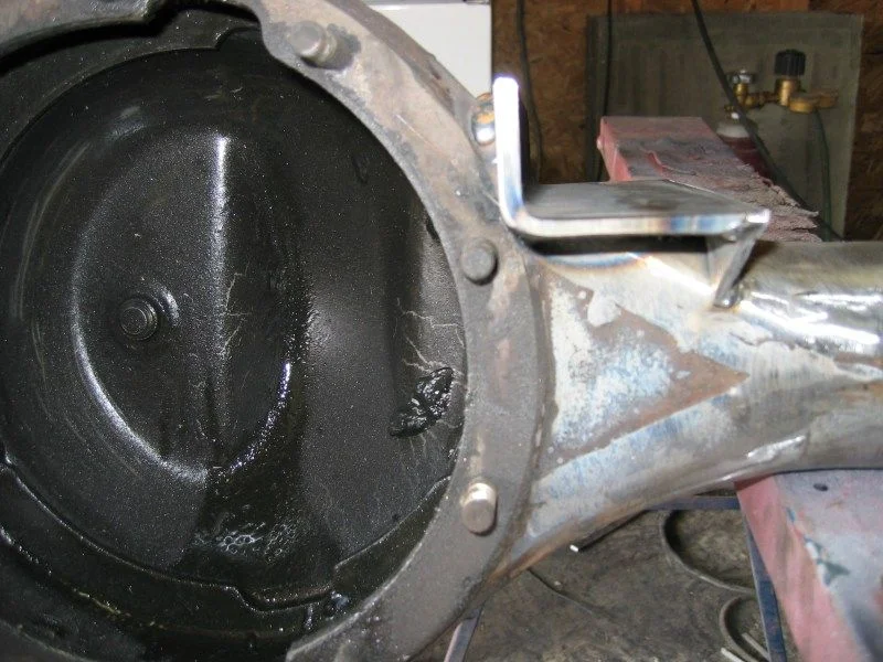

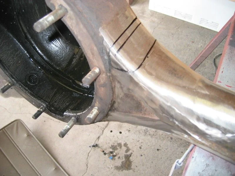

I did a bit of measuring and realized that I can do this springover on 60 series axles without outboarding the springs. Since time is tight, just fabbing mounts on the housings and dropping them on the bottom of the leafs is preferable in spite of my previous pontification about four links and airbags. That'll have to be a project for another year.
I was able to hack a chunk out of the housing and insert a piece of angle which will form the spring perch.

Hey Bruce, not doing a cut & turn on that housing?

Kuddos Bruce, not sure if its been done before, but like anything it may have been, just never seen it on the net.
Nice fab work.

Yeah, Rob I'm not the first guy to put 60 axles under a 70 or 40 but I have no idea how they did it. This is my idea of how to keep it as low as possible.

I nearly started turning the housing today but decided to try it as-is first. Peter managed to run his unturned by clearancing the u-joint a bit before he put the Toybox in. I plan to add a Toybox soon too so I'd be willing to run limiting straps until then if I need to.

Do you think cutting the housing like that would work for a 40 series too, or would you have to cut further, making it impossible?

You might find it easier to use bolts instead of U-bolts and thread into your perch/plate, or add nuts where possible.
A C&T would give you the added benefit of a better caster angle.
