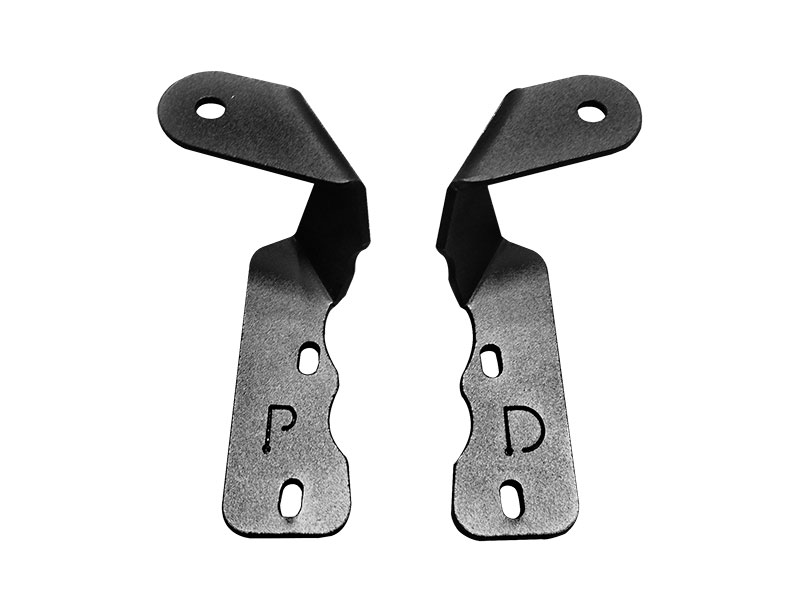

What do you guys think, would there be a market/interest for these light brackets? And more importantly, can it work on an 80 (not near my truck to check)?

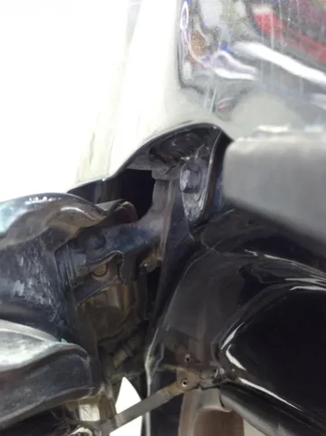

Not to say it can't be done, but to do it fashionably, and functionally I think mounting to the hood hinges would be best. Installation would be kind of tricky for one person, and those without confidence in their wrenching skills, but I could make a set easily enough.
I don't follow. These 4Runner brackets mount to the hood hinges, not on the pillar. I would think they could be made exactly like CBI's brackets, but for the 80. If only CBI gave two craps about the 80 market, we could have all these cool parts from them too :cheers:

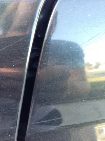

Well there is a bolt for the fender you could tap into. And when you open the door that area frees up it doesn't pinch. I know it's only one bolt but I'd imagine if you could work something out to where a few bolts would have to come off between the fender and cowl and make a solid mount there and it would basically stick out near the mirror.

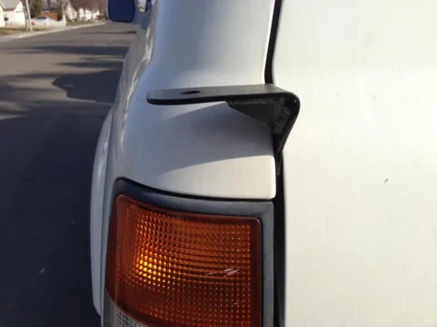

It's definitely doable. If there's enough interest I could fab up a set and see what you guys think.
I'm thinking somewhere in the neighborhood of $100 a set for un finished steel, and probably $180 for black powder coated. Both prices before shipping.
