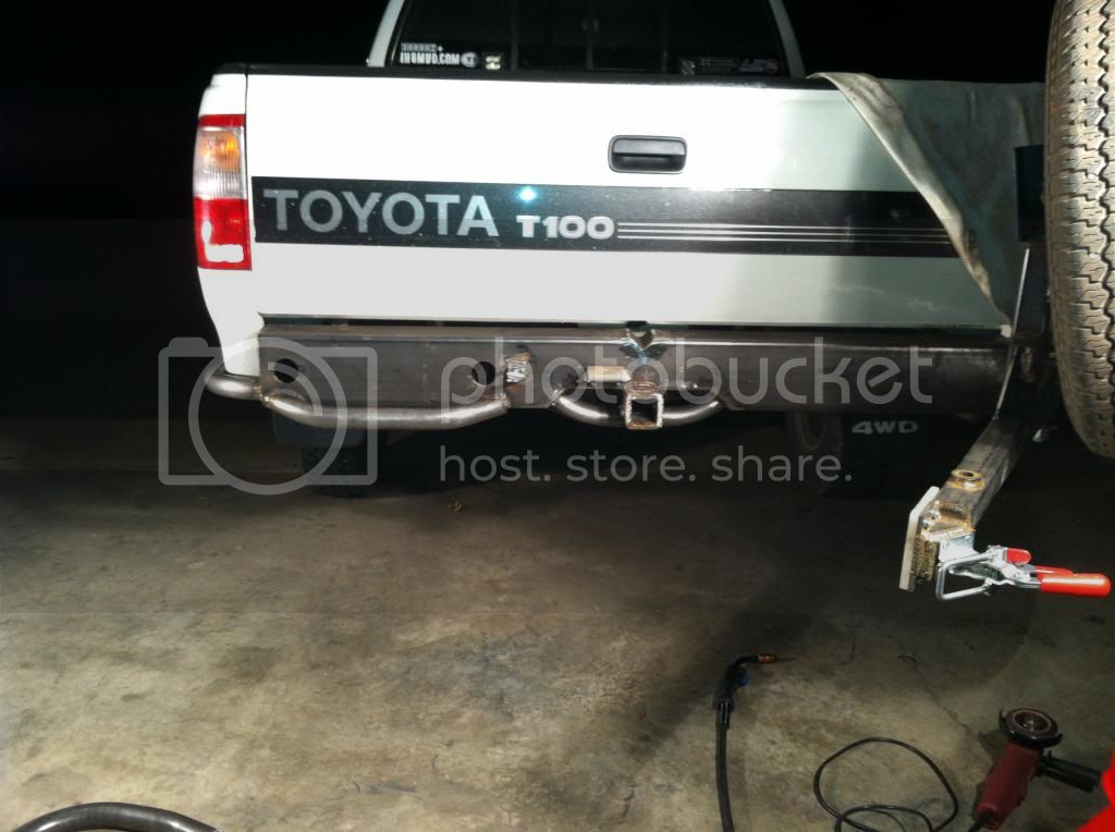

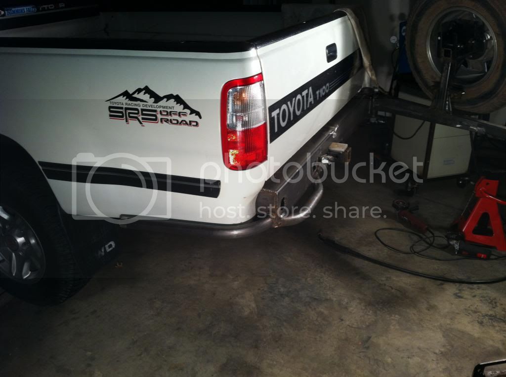

Got the tube bent at Revelation Fab in Chapel Hill. The owner is a perfectionist and I'm very glad to have the opportunity to work with him. He allowed me to stay and talk (annoy him) while he bent the tube and welcomed input throughout the process of measuring and bending.

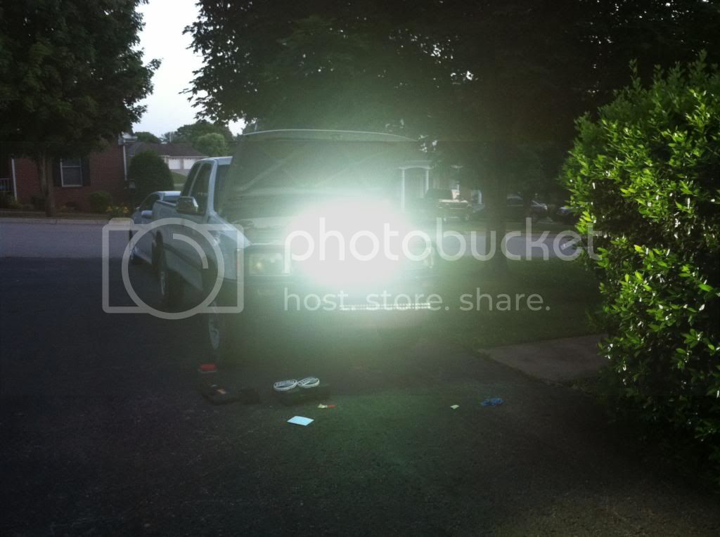

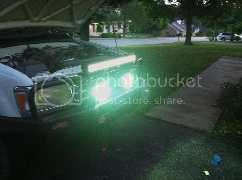

The past few weeks ive been slowly working on a new battery tray so I could mount one of these aux panels https://forum.ih8mud.com/threads/auxiliary-fuse-relay-panel.352802/ nect to the battery. Its powering a 30" LED bar and the hellas on the front bumper. Its also powering my bed lights and will power another 2 sets of LEDS when i finish the bumper and trailer Im now working on. No pics yet.

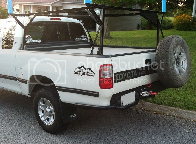

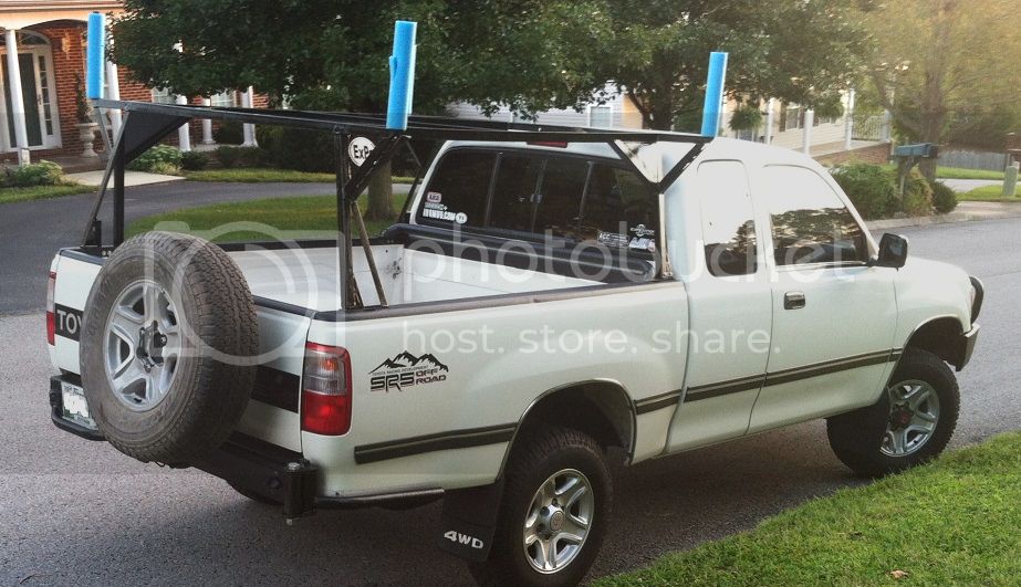

My friends and I went kayaking in Nemo, Tn. last weekend and so I built a kayak rack for the bed to give us a little more cargo room. Its made form old bed frames i had laying around. total invested was under $50 and its sturdy enough to be an anchor point for my hammock.
I modified the bed bar mount so it can still stay in full time and the rack will bolt on and off of it. it worked well.

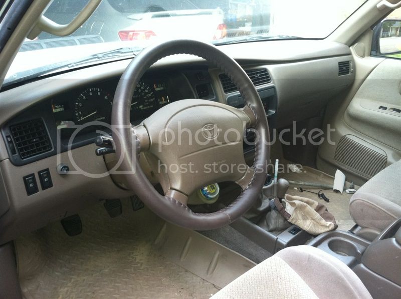

I searched around for a steering wheel cover that matches oak interiors without much luck.
here is a comparison of three colors of wheelskins. Im going to go with brown. Its a little dark but a closer match than what they call "oak"

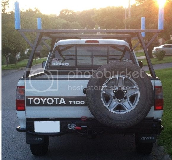

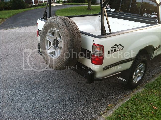

Finally!!!!! Front, rear and kayak rack are done and coated. I learned a lot, cursed a whole lot, and figured out I'm way too slow to ever make money making bumpers for a living.
rear:

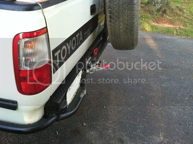

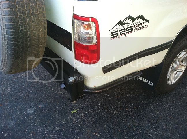

today i stuck some rubber diamond plate pads on the bumper.
And this is the brown wheelskin cover installed.
