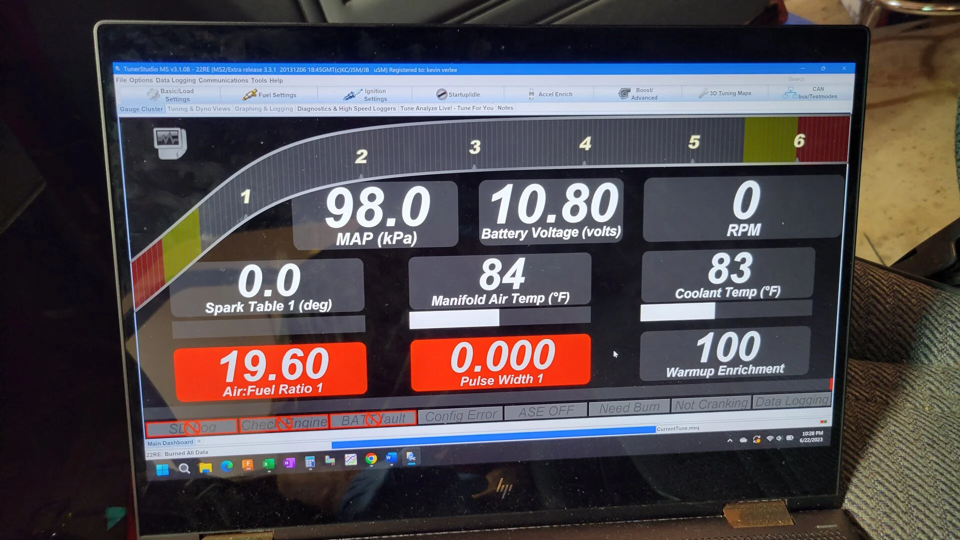

10F started after adjusting cranking fuel. WUE was decent and it warmed up at idle without any throttle input from me so I should be good to go for the winter months.

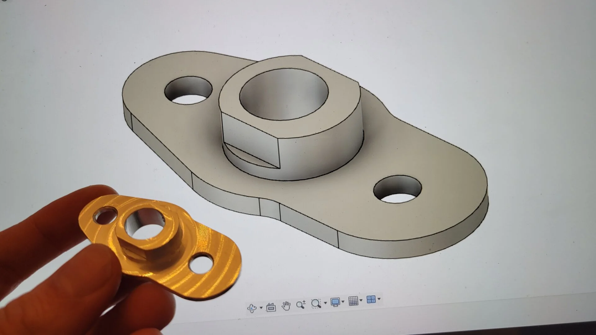

Locate and weld Tial BOV flange

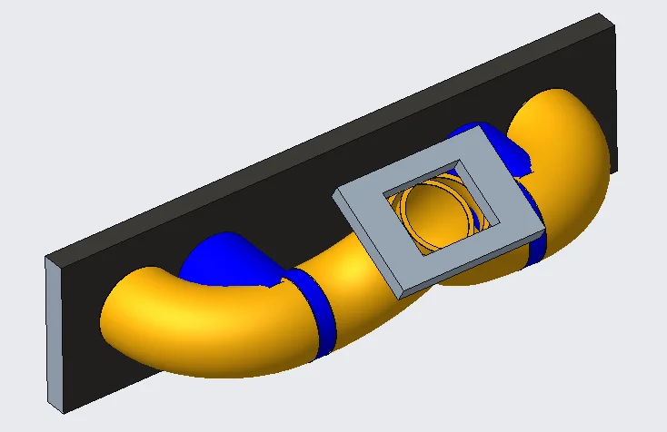

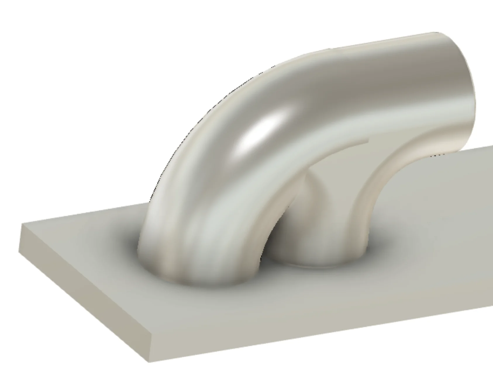

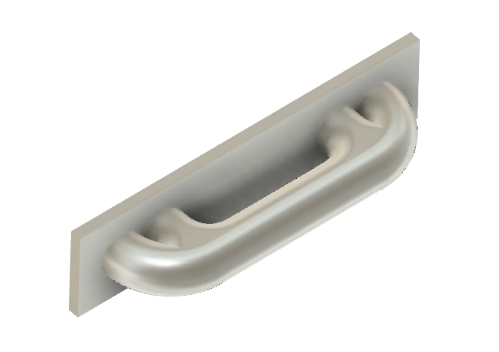

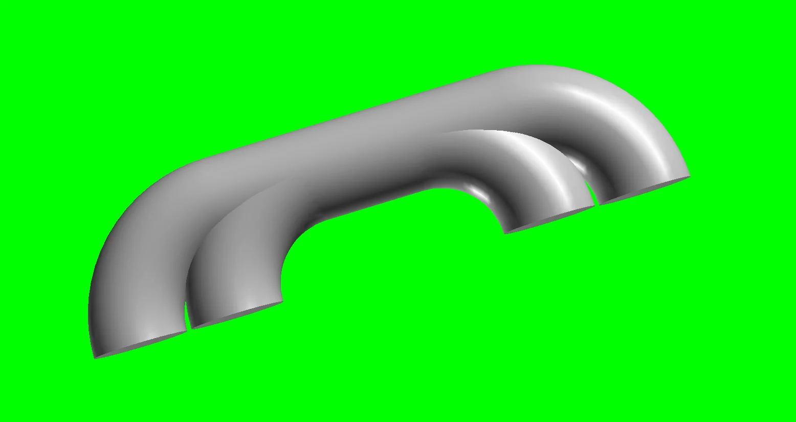

Having fit and welded my share of mechanical pipe over the years, I was a bit intrigued with your manifold challenge there. Played around in cad and came up with this, fwiw.
4x std radius 1-1/2 90's and 3x short fillers.
My attempt with notching the T's ends up looking very similar. I will probably ditch them and go with 90s or just straight sections on 2 and 3.
Stubbing out of 2 & 3, while it might be the easiest way out, falls far short on the cool factor IMO.
I'd stick to the fttg route if possible. Just my $.02.
You're over estimating my ability to fabricate. I think this is my final concept, 4 90s and a few straight sections

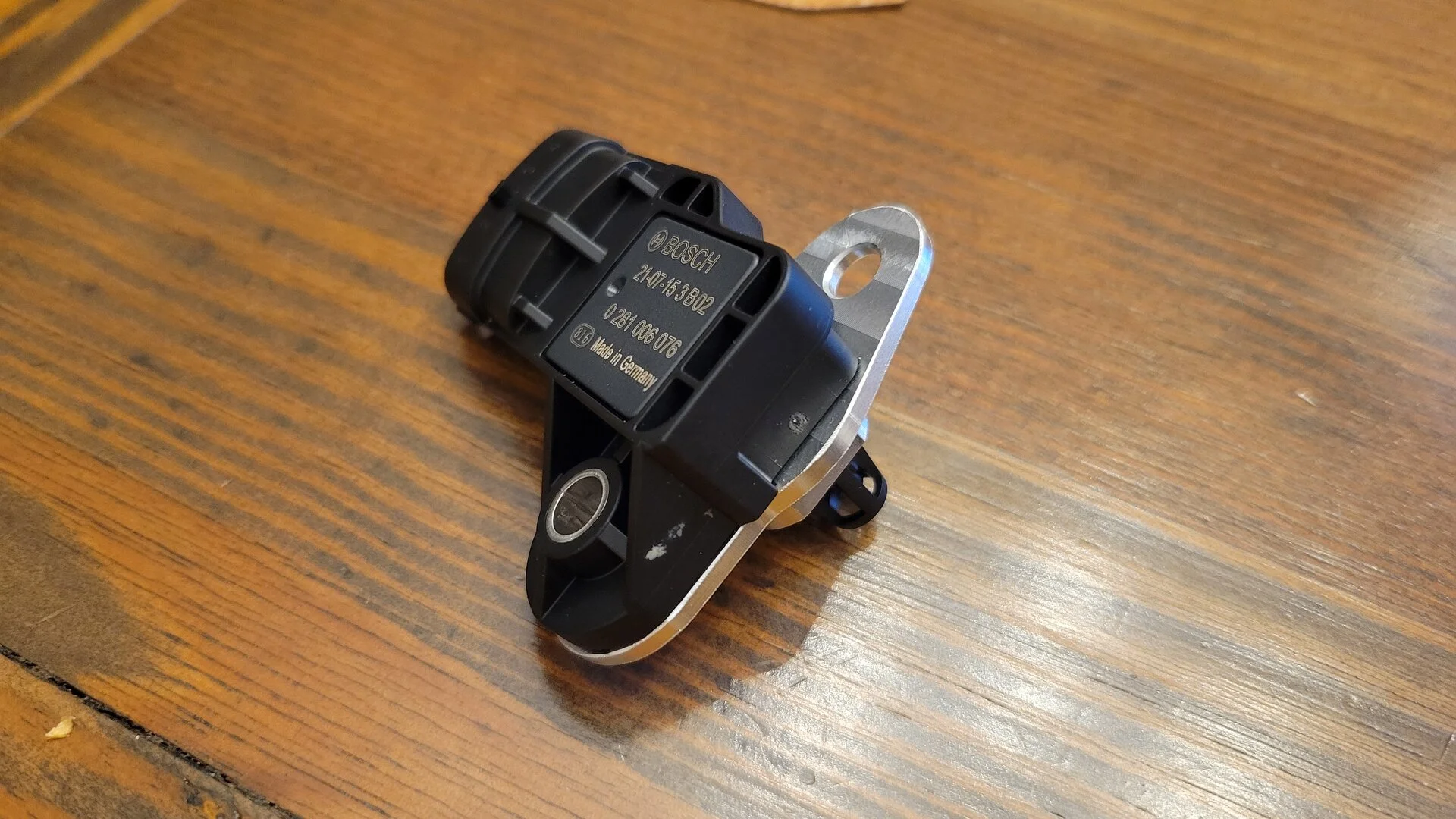

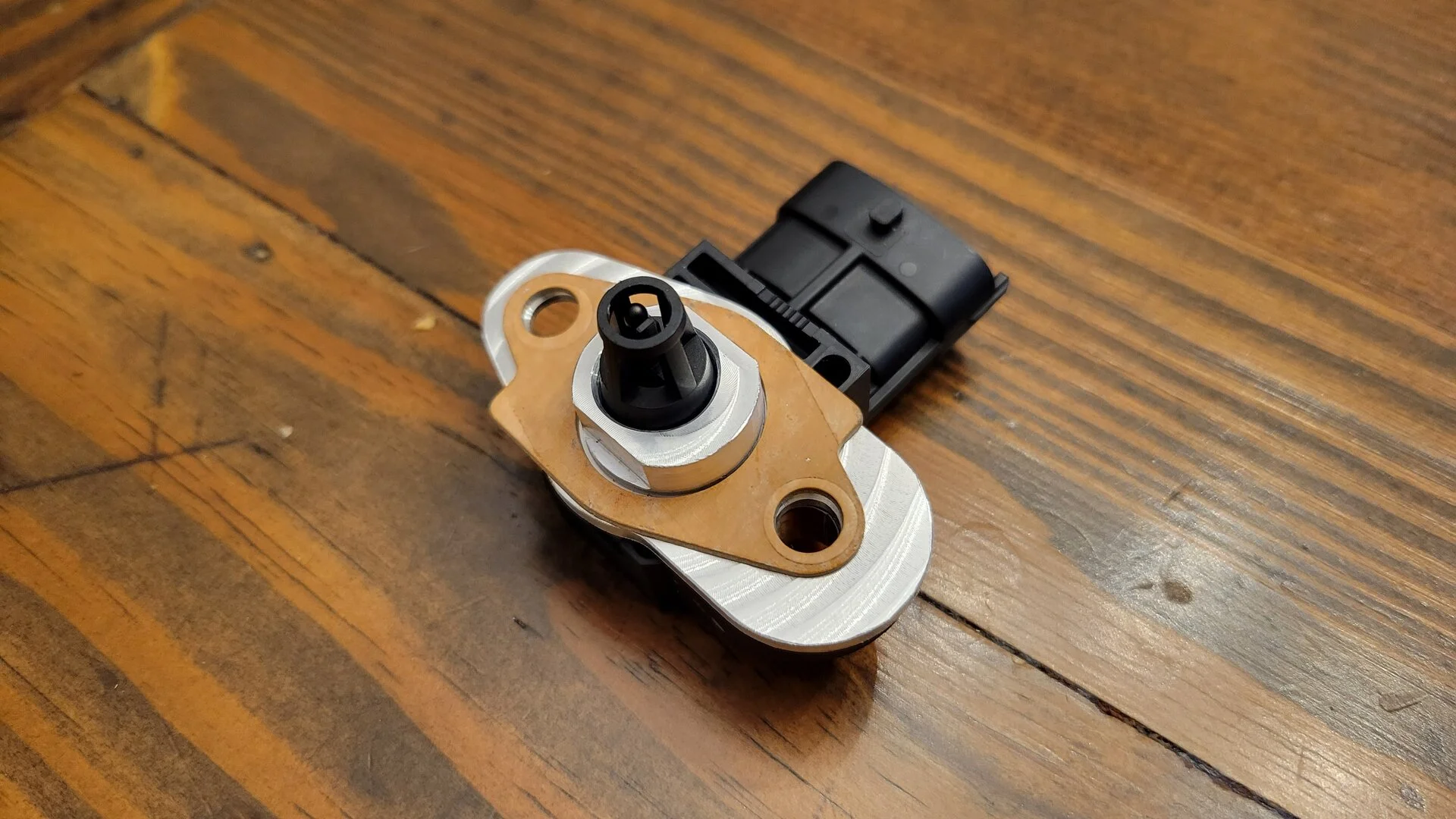

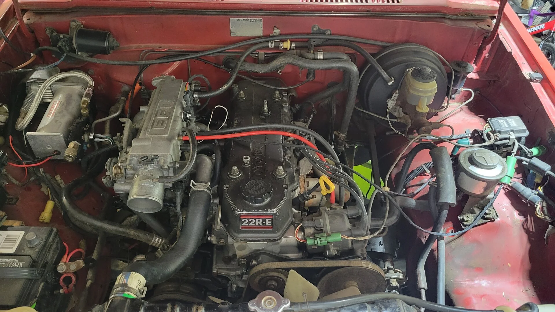

Purchased a bosch TMAP sensor to remove the AFM and am switching up injectors from low impedance 750cc to five o motorsports high impedance 550s. Couldn't get the low pulse width at idle and cruise to reliably inject.
Going to clean up some wiring and fuel before tuning new injectors NA again prior to putting the turbo on
Millpwr project to get the bosch temp and pressure sensor into the intake manifold and remove the factory AFM. Turned out pretty good

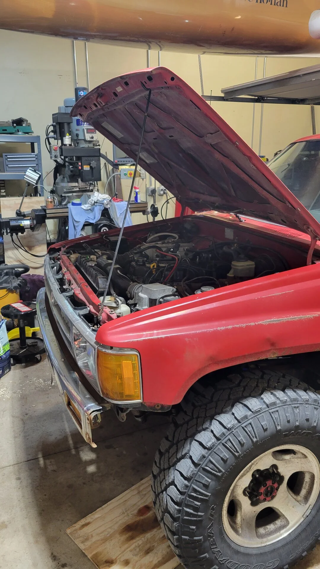

The pickup is finally back in the garage...

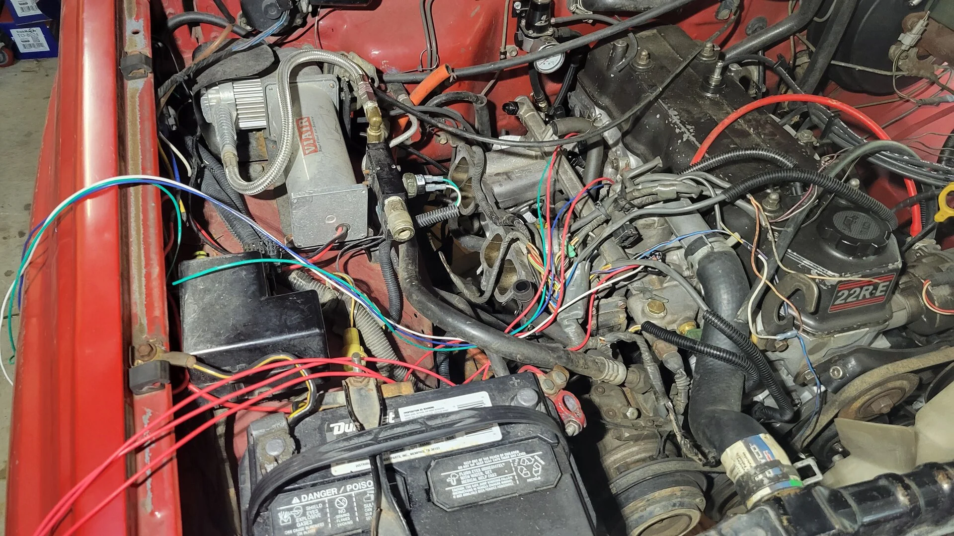

Wire bosch TMAP and remove AFM
Wire high impedance 550cc for sequential injection

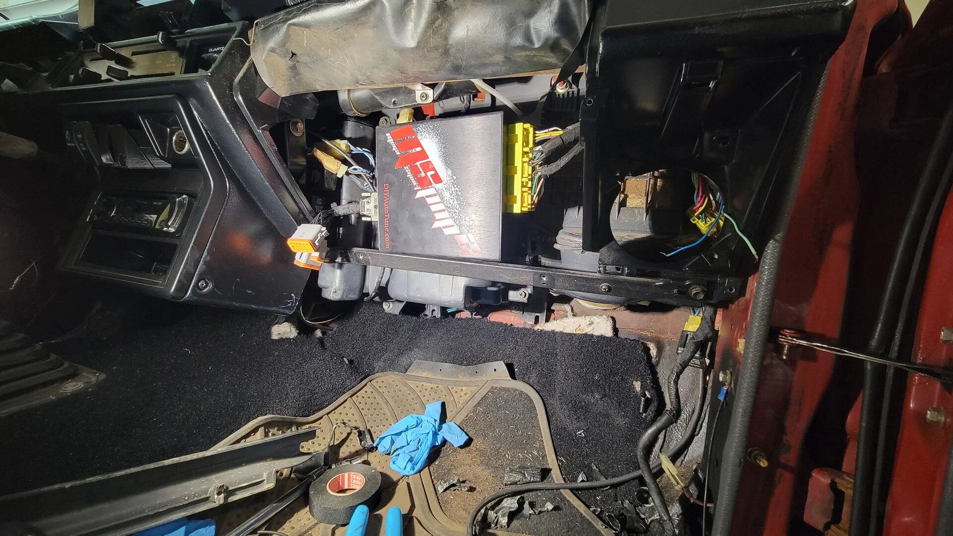

Mount megasquirt under the dash

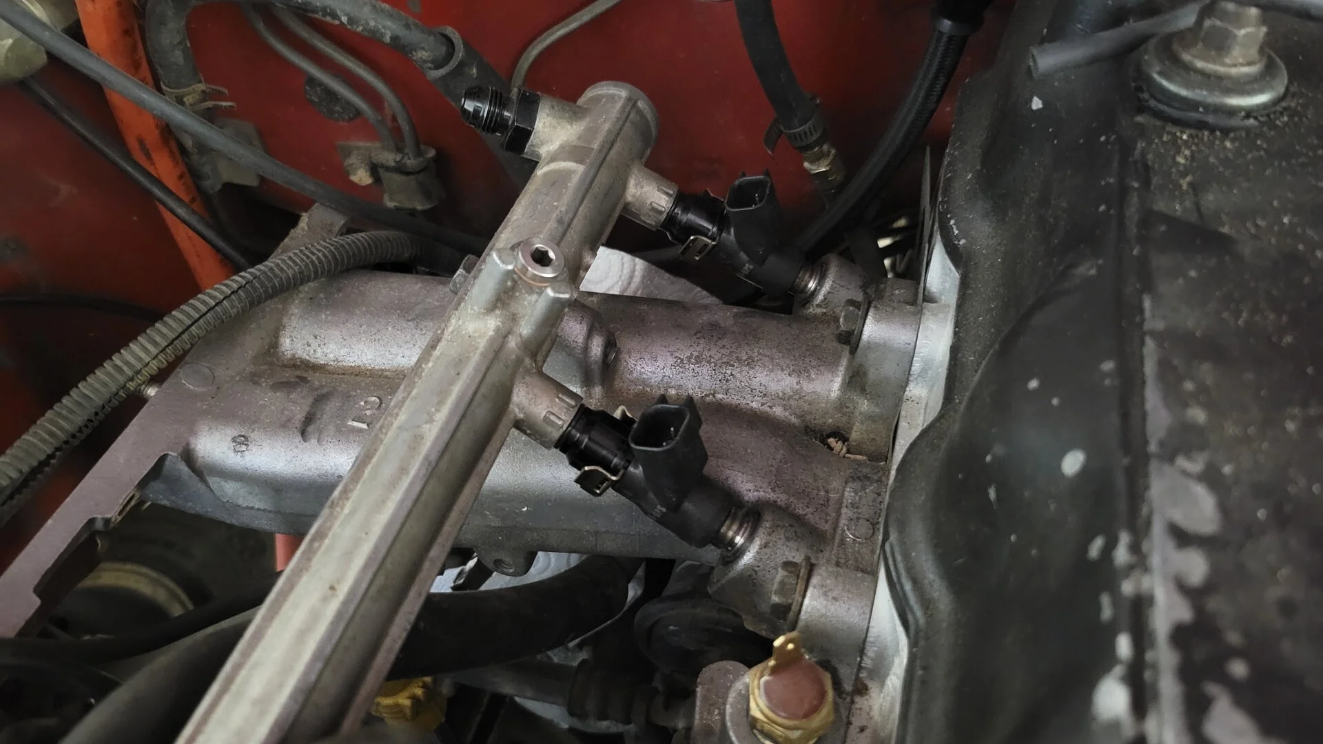

Removed low impedance 750cc.
Installed high impedance 550cc 'black ops" from five-o.

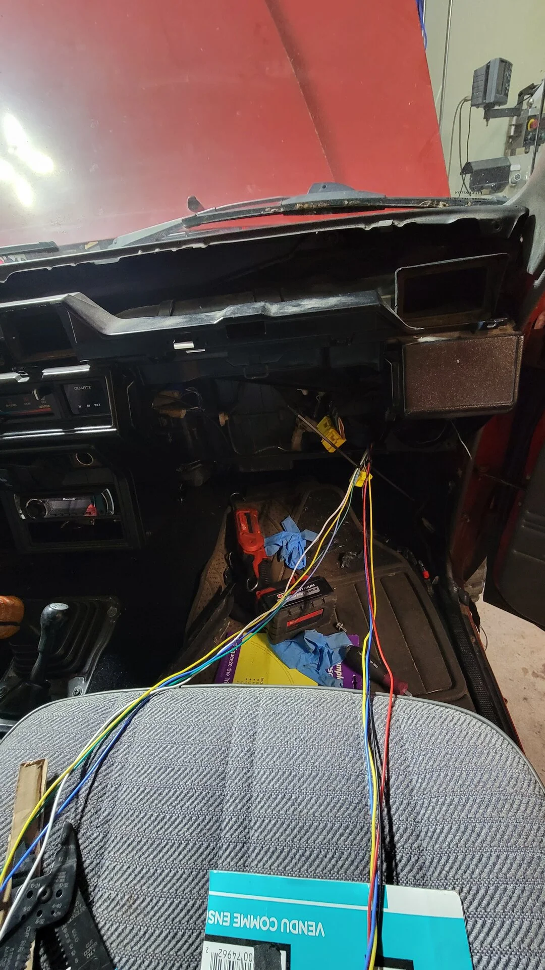

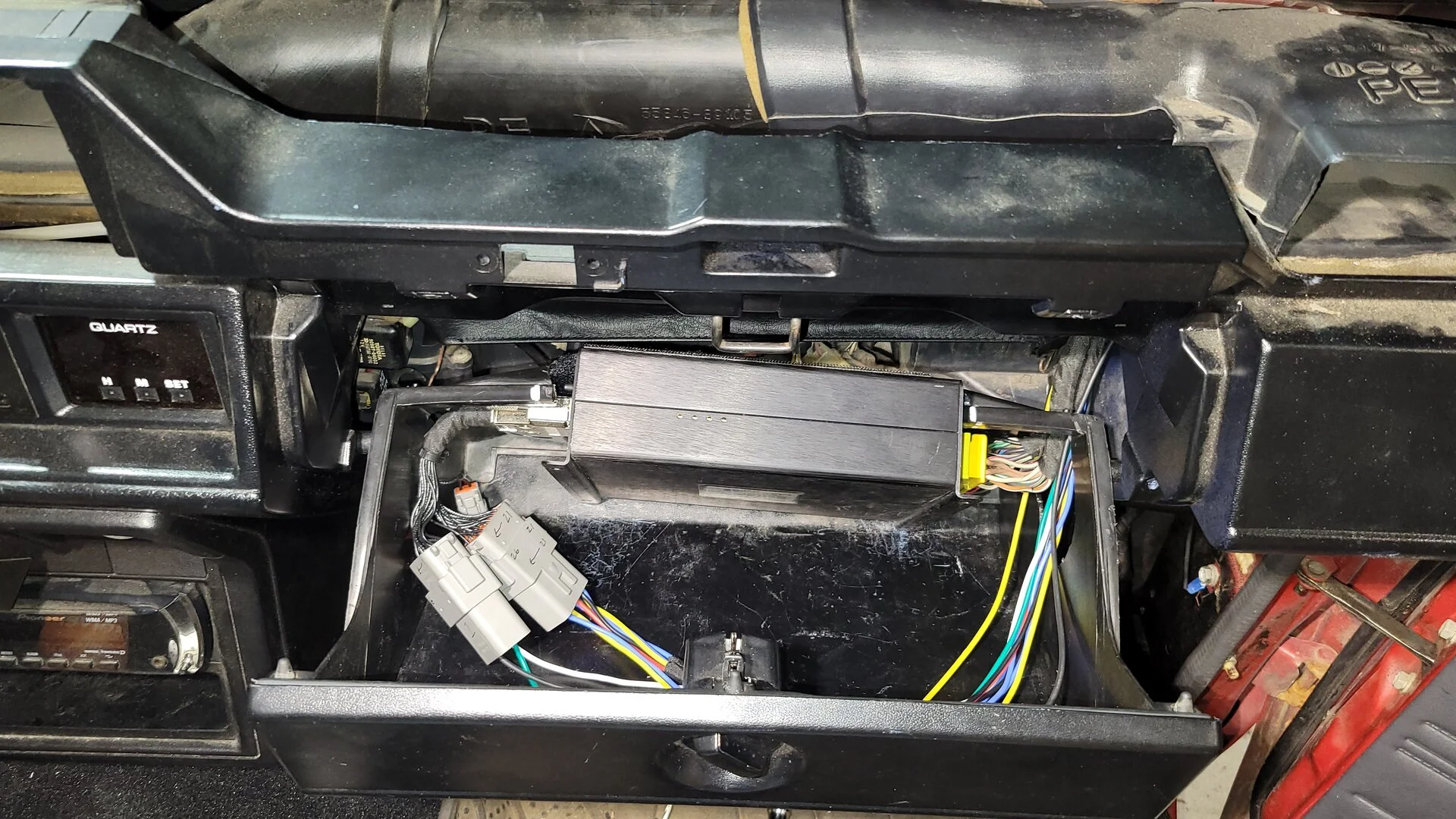

Relocated wiring to behind the glove box, just need to work up a MS mount.

MS set up for sequential inject using the ABCD ports on the rear options port. I'm told from DIY autotune support that the 22re distributor picks up both cam and crank signals wrong information... so all you need to do is run individual wires and remove jumpers inside the MS board to convert batch to sequential and add a cam/crank sensor
Also setup for external MAP instead of the internal map/hose and set S1 in the down position to let MS control the fuel pump when deleting the AFM
5 - off
6 - inj d seq
7 - off
8 - inj c seq
11 - off
14 - off
17 - external map
S1 - down, afm delete

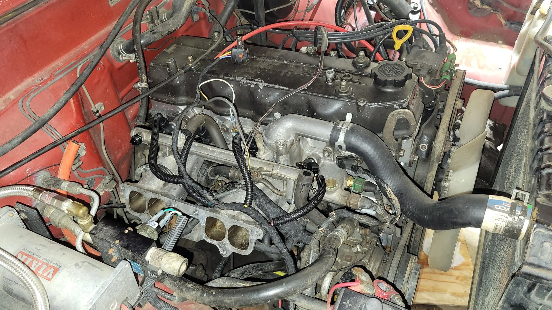

Intake manifold back on and AFM jumped.

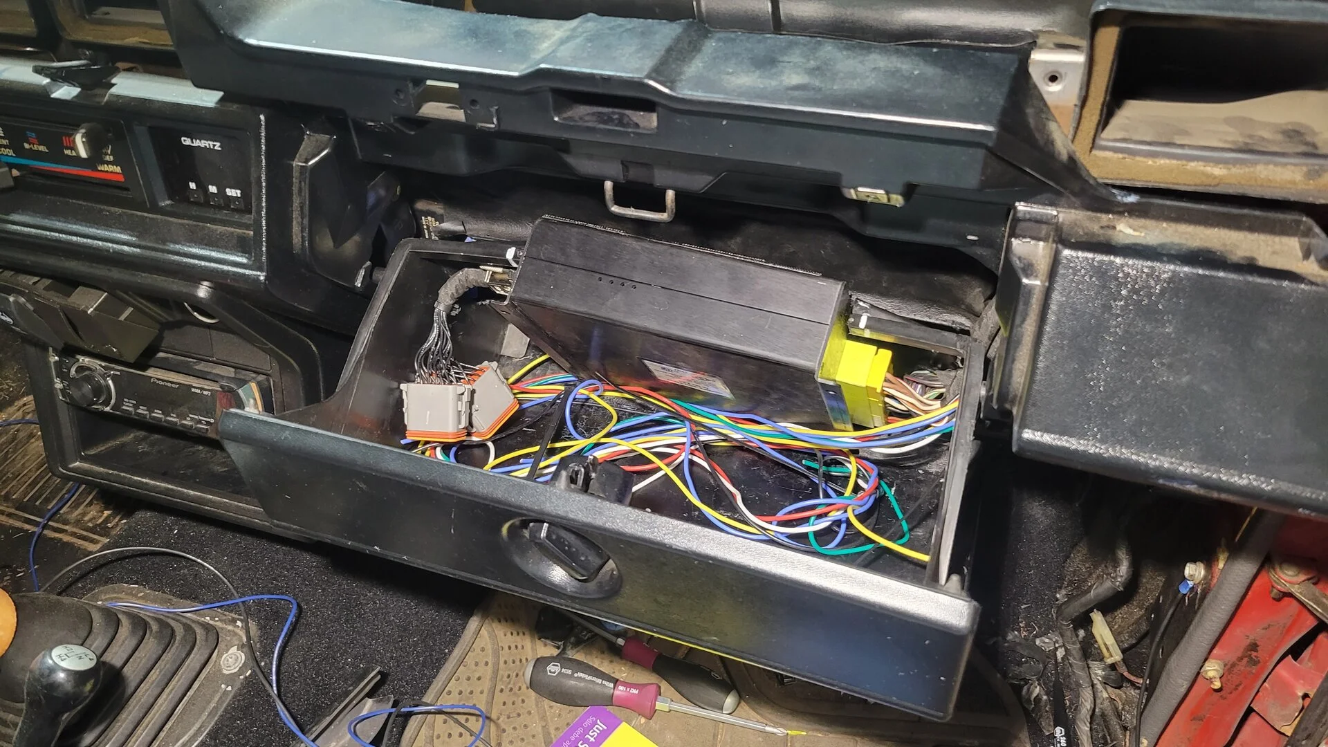

Went with glove box hacking and velcro for ecu mount. It's really hard to unstick.
