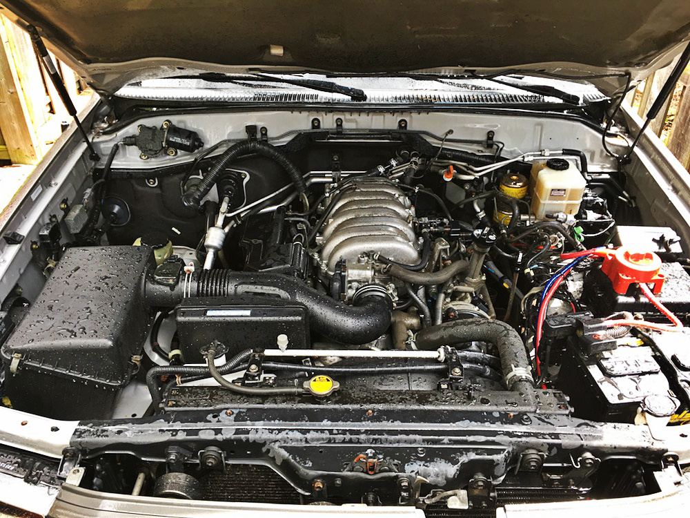

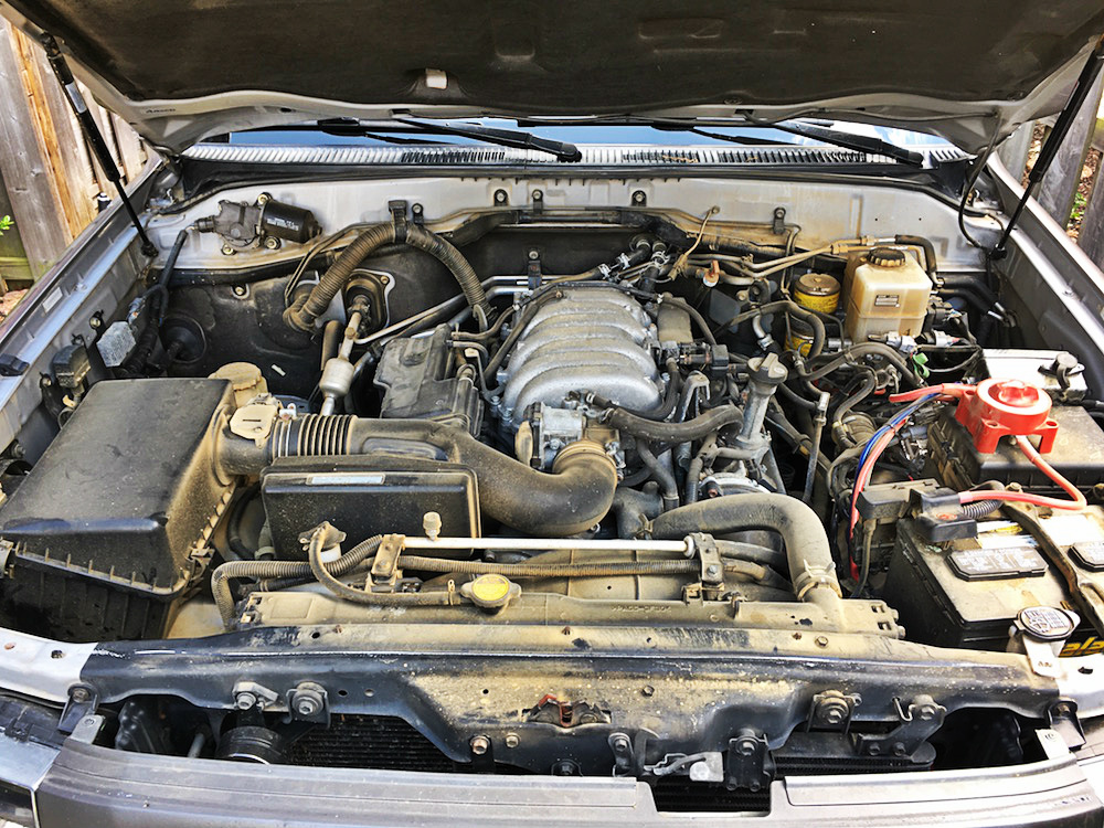

I'm not too concerned with a clean engine bay, so I grabbed a can of some foaming engine cleaner at AutoZone and sprayed / rinsed it this afternoon. Super easy and the engine bay is much cleaner. Not show-room clean like some of you guys, but I'm happy.
Before:
After:

That turned out amazing. But what's going on with the radiator upper support. Looks like the paint came off.
Thanks - just the difference in lighting between wet areas vs dry (drier is wet, lighter dry) - no paint was removed.
