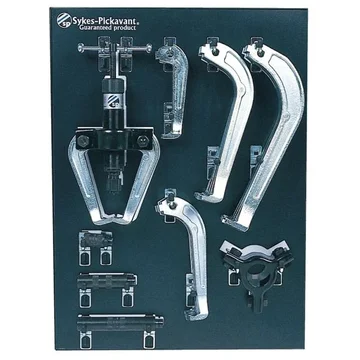

Mine came off obligingly with penetrating oil (repeatedly sprayed on the spline-joint for a few days before the attempt) and then using a Sykes Pickovant hydraulic puller:
