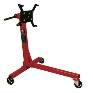

All I will offer is to NOT buy one that has only 3 wheels, or the front 2 wheels are really close together, like this one:
Very unstable, they tip over very easily, then you'll have a heavy engine laying on the garage floor (or on top of you).
You want the wheels to be as far apart as possible.

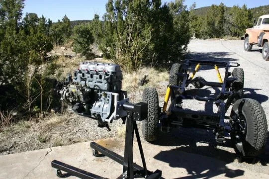

To that end.... (this is just a 3B on it, very easy for it)
It's an Omega rotating engine stand. the gear drive for rotating is AWESOME. With a non-geared stand (my other one) an assembled 2F is too much for one person to safely rotate, but this one can do it all day long safely.
I really don't know what I'll do with the other stand, because this one is just too much better to use in every way. You can find Omega brand stuff relatively easy (you can get them from Tool King shipped to you), and lots of heavy truck shops carry it as well.
