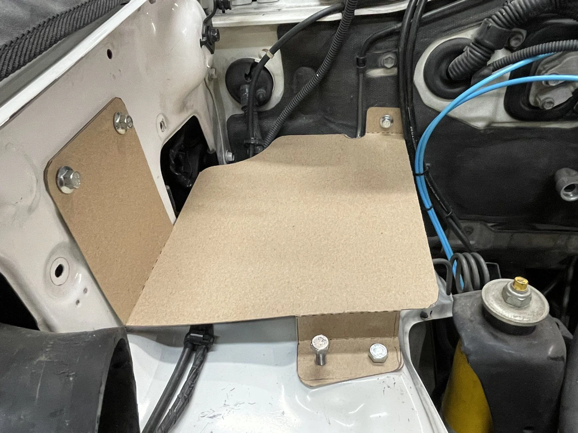

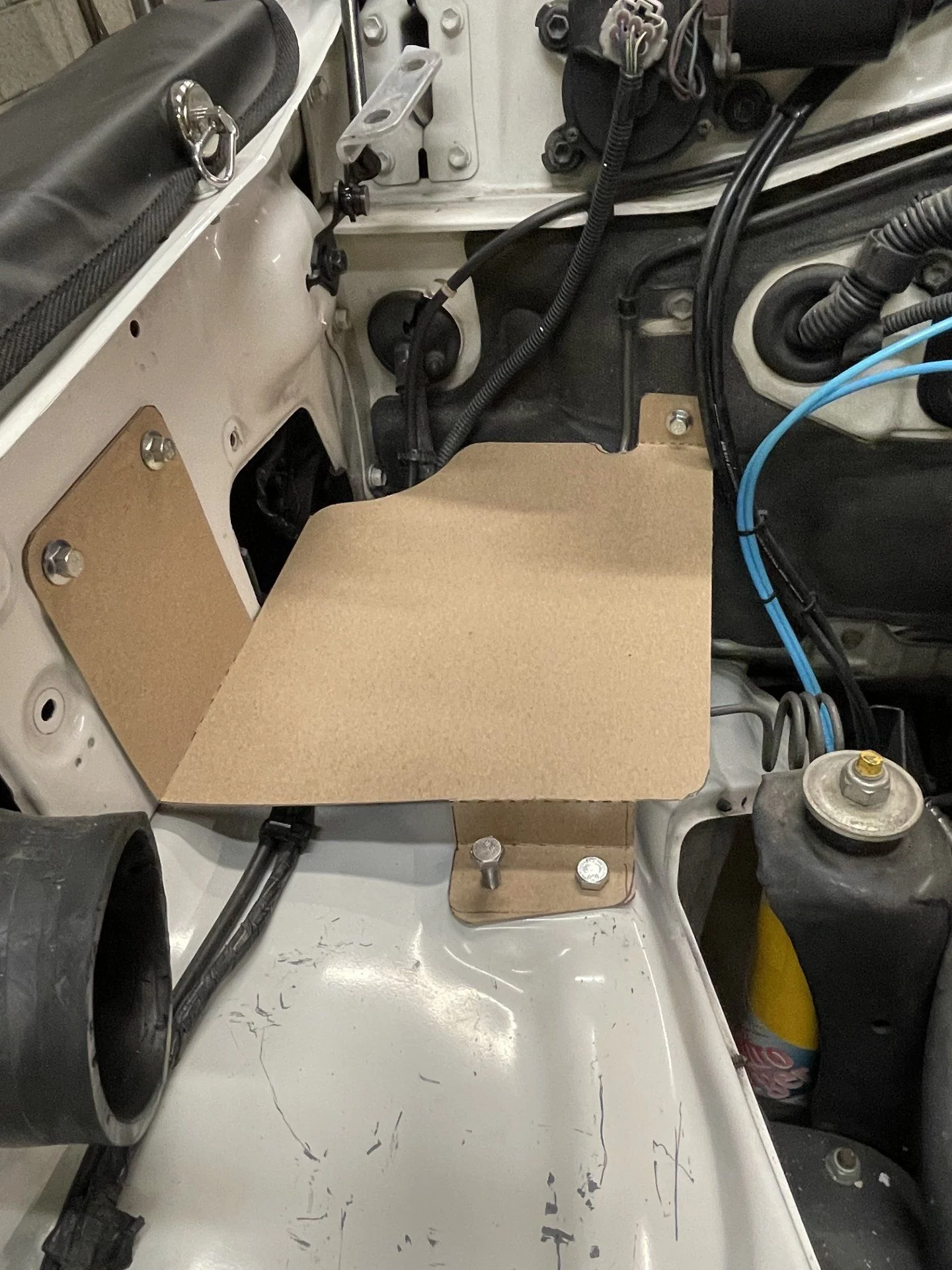

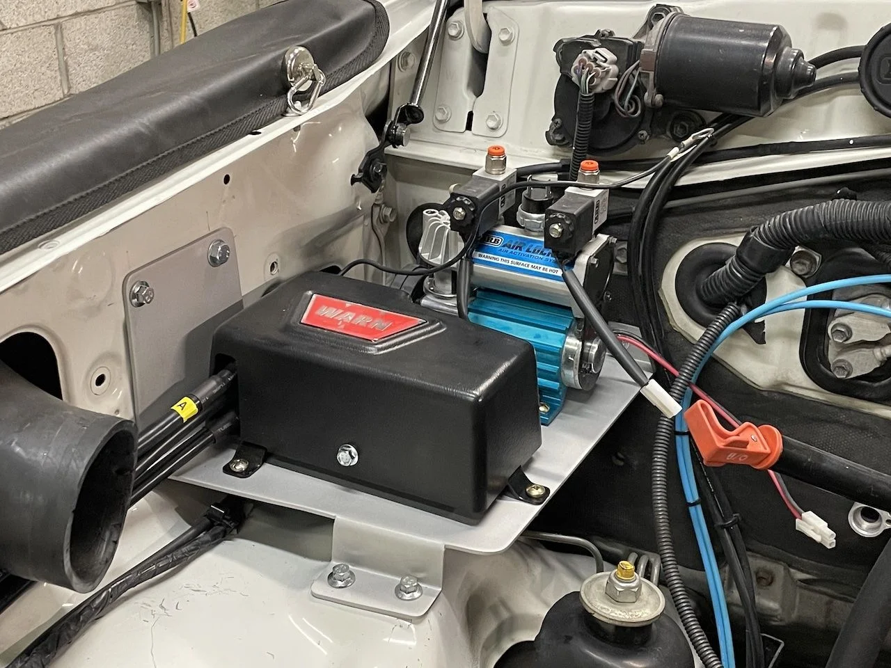

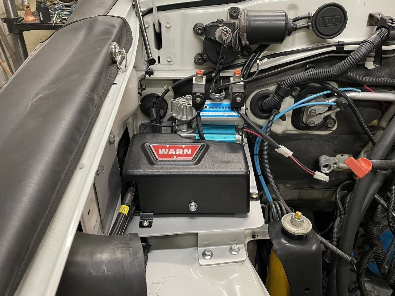

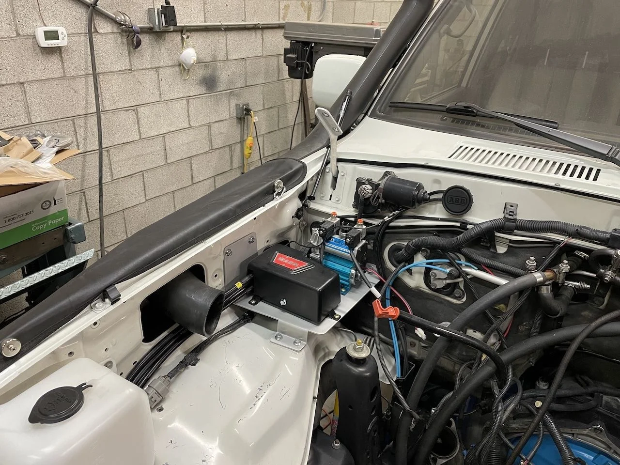

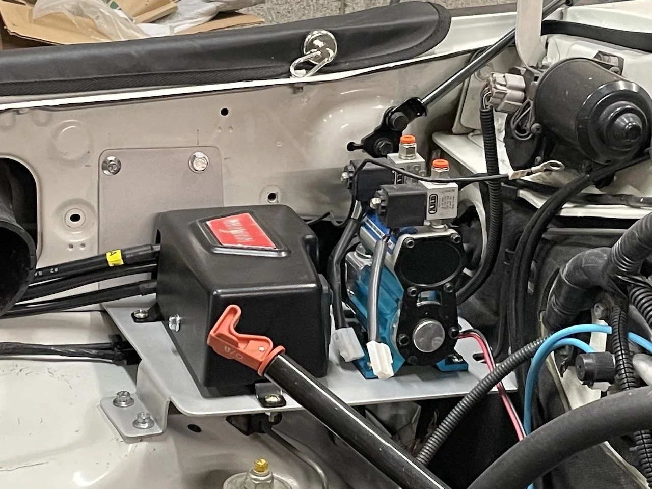

I need a place to put my remote Warn winch controller. I could not find a good place so I looked online for options. Found a place in AU that makes a shelf, but it is too big and may restrict the airflow to cool the V8.

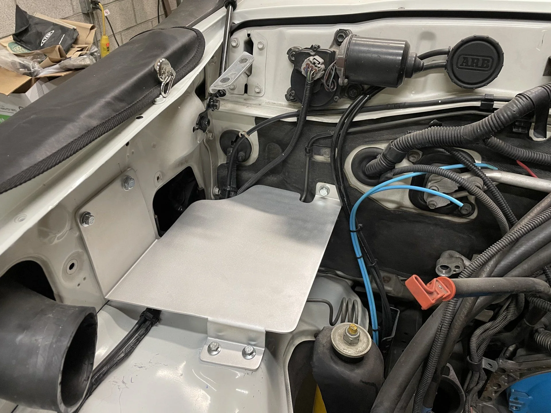

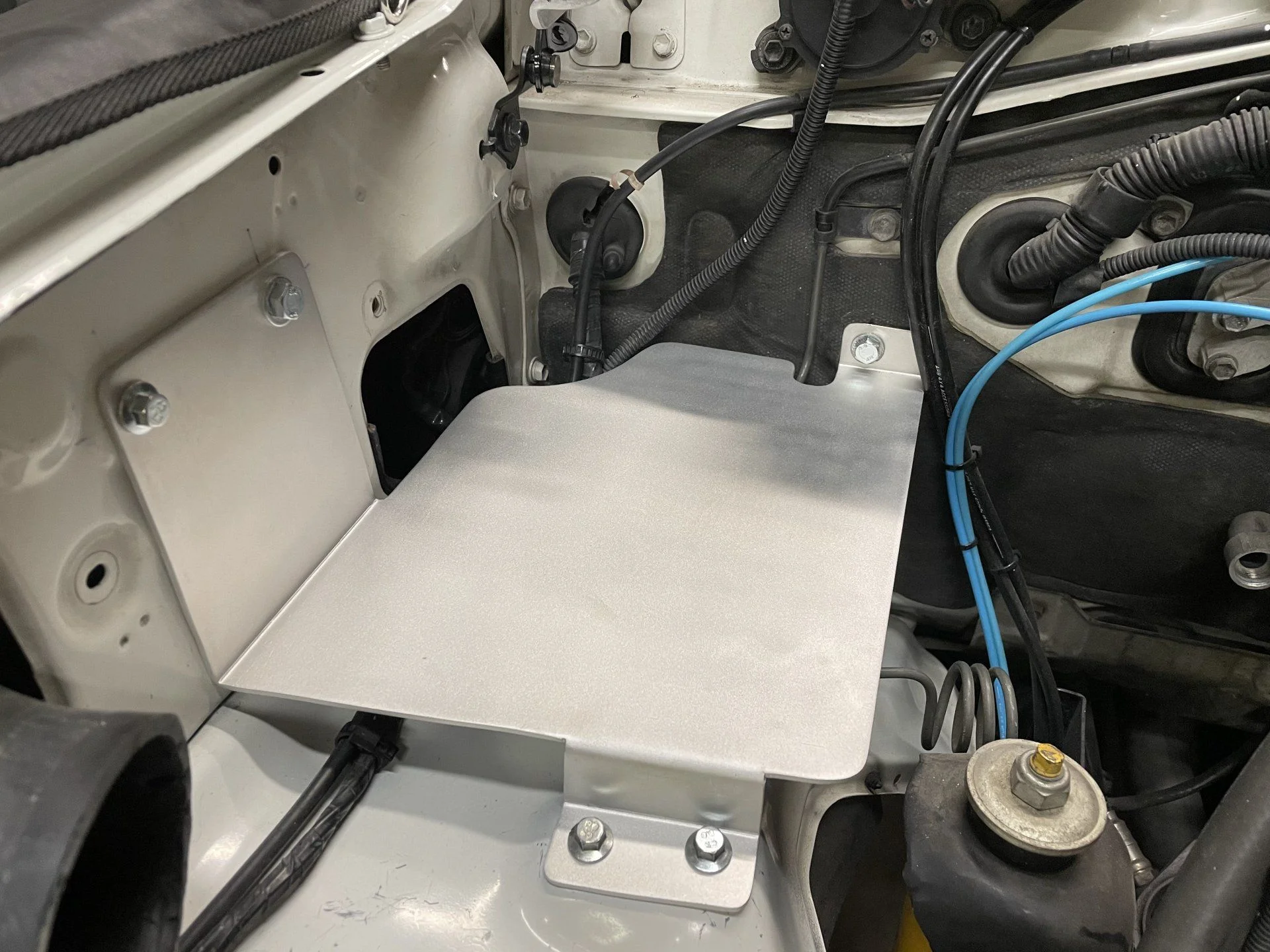

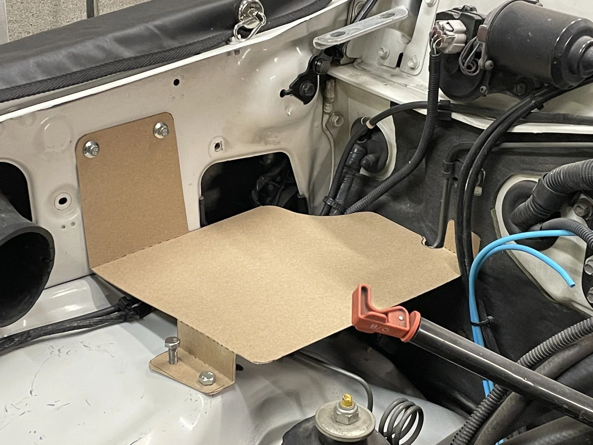

Decided to make my own. Mocked up a cardboard template and about to start cutting one out of 1/8" 5052 aluminum sheet.
Considering making a CAD model and having them laser cut if anyone else wants one. I'm thinking they would cost about 50$ for materials/cutting.
Let me know if you are interested. They would be raw aluminum, ready for paint or powdercoat.

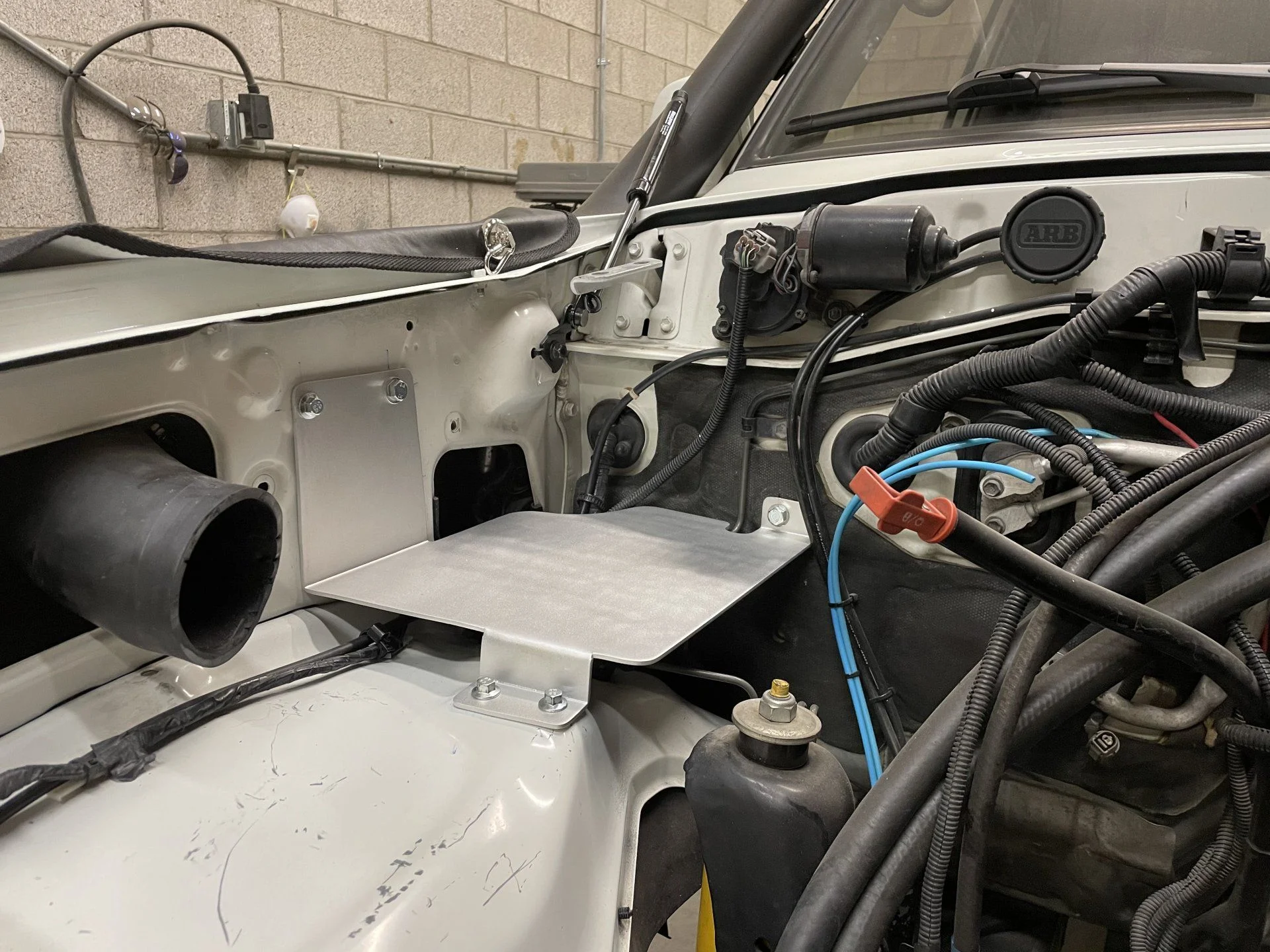

Would a factory air box still fit for those without V8 engines?
Yes it will still fit. It has a tab that goes underneath the rear airbox bolt, which will lift the back of the airbox up 1/8" of an inch. Should not be enough to matter.

I had to rework it slightly to make it fit. The AutoCAD drawing needs a few updates. If I get (5) folks interested I will send it out for cutting. That should bring the per piece cost down to about $40. Otherwise I will just make the template available and everyone can cut their own.
I would have loved this if I didn't have to relocate my windshield washer fluid reservoir to that location to fit my dual battery. It looks great!
I ordered a smaller (replacement) fluid bottle that I still need to mount. Trying to make space for a dual battery but just have not gotten to that yet.
So @mtkreitz this prototype is a one and done?
Looking that way unless I have other folks interested. I would need to remeasure my template, update the AutoCAD drawing and have them laser cut. Just too much to do if there are not enough folks to make it worth while.
