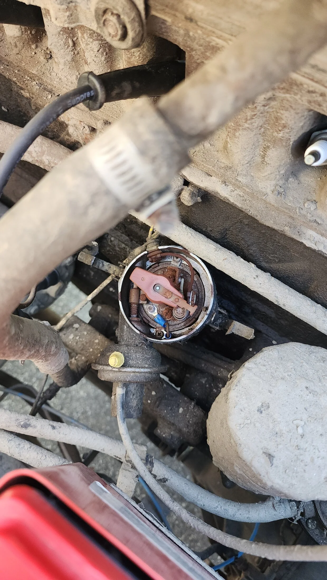

Desmogged '76 FJ40 with an Aisin Carb, Took off my distributor cap to find this.. I think its time to get myself one of these electronic distributors...
Have been experiencing some issues where Ill get some misfiring at idle, misfiring and backfiring at lower RPM on acceleration, and then all of that clearing up at higher RPM. The vacuum advance must not be working properly or something at those lower RPM's, and I can see why it might not be! Been looking all over for a new distributor, considered the HEI DUI swap but have now heard bad reviews on them (like when they get wet for example). I thought it was a carb issue but it seems like more of a timing issue. Not sure if any of the onese being sold 10ish years ago are still available, but I have found some similar options on Amazon.

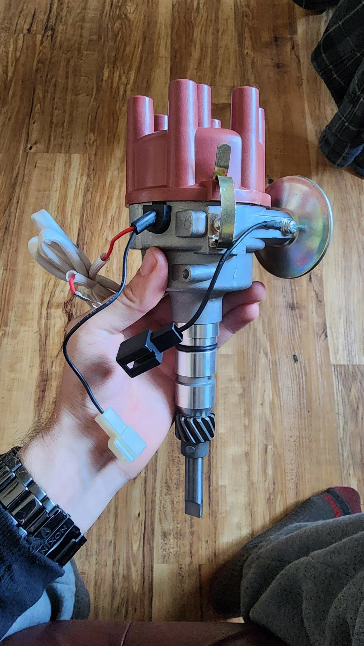

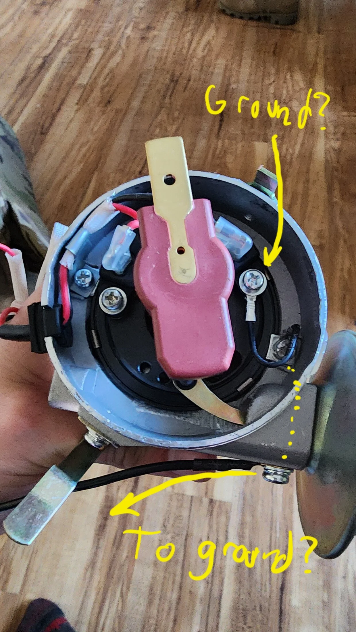

My amazon electronic dissy arrived today, looks quite similar to the ones you used to sell. The only think im confused about is the black wire with black connector coming off the body of the dissy by the vacuum advance. Anyone know what this is for?
