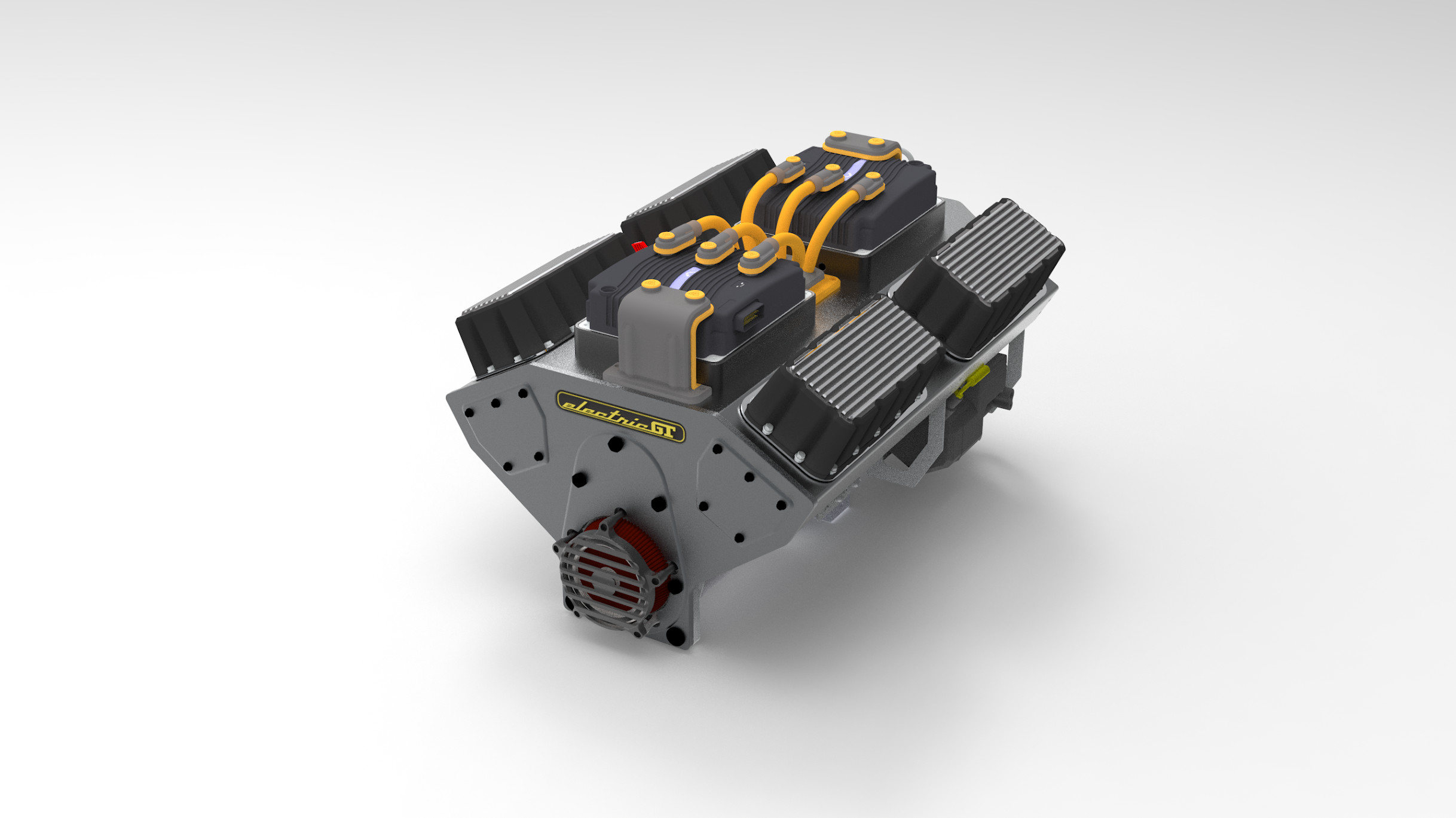

Thanks for tapping in to the thread Salmon Man:)..... The "crate" as we have designed it has optional abilities for accessories. But more importantly, It contains Dual Motors (Love Joy connector and Billet motor coupler), Dual Controllers, the Contactor Box (Think HV power panel/control panel), the BMS brains, a 6.6 kW on-board water cooled Level 2 Charger, a cooling system for the controllers, (this build) and Electric AC Compressor, 1000 watt DC converter (EV "Alternator" for 12v system), Billet Adapter plate, Motor Coupler, (and a clutch assembly). We used 3 AC-51's in the Ferrari project and it benefits from the higher RPM (@+1000)... but the AC-50s have more torque and pair well with the builds battery module. We put in electric power steering separately and also have an accessory shaft that could run off the motor if needed..... Then there is the HV wiring harness, battery enclosure, Battery side BMS, etc.... It will be relatively easy for the average shop guys to install...... but not an "economy" solution... at least not yet:).

Technically yes..... Either current configuration could work as the base AC-50's provide close to 80 power specs. The H9's w 240HP/340ft/lbs would be nice:)...
Adjusted & re-engineered renderings came out nice. Build up is coming along.... some cool parts came in on Friday and the 3-D printer doing what good robots:rofl: do! - More coming shortly....

Would you still be able to run the accessories from the front plate? (Ac, power steering and so on)

Lots of options. Electric or belt/Aux. Some Electric accessories are modular. We have an ac unit built into the “block” on this one. We could also run via an accessory shaft on the front end which is hidden currently by the “filter”. Power steering has been installed on this rig too. Electric.

I assume you've built regen into the brake system? Also, I'm not seeing a brake booster yet. Will you have a vacuum pump to operate the booster?

Thanks! We clearly have the 60 series in the sights:) E-Crate is modular and has options while the battery “module” will vary by model&range req. Our systems include fully programmable regen as well as electric vac for booster if not an electric booster. We aim to capitalize on OEM where feasible. Upgrades always possible.
