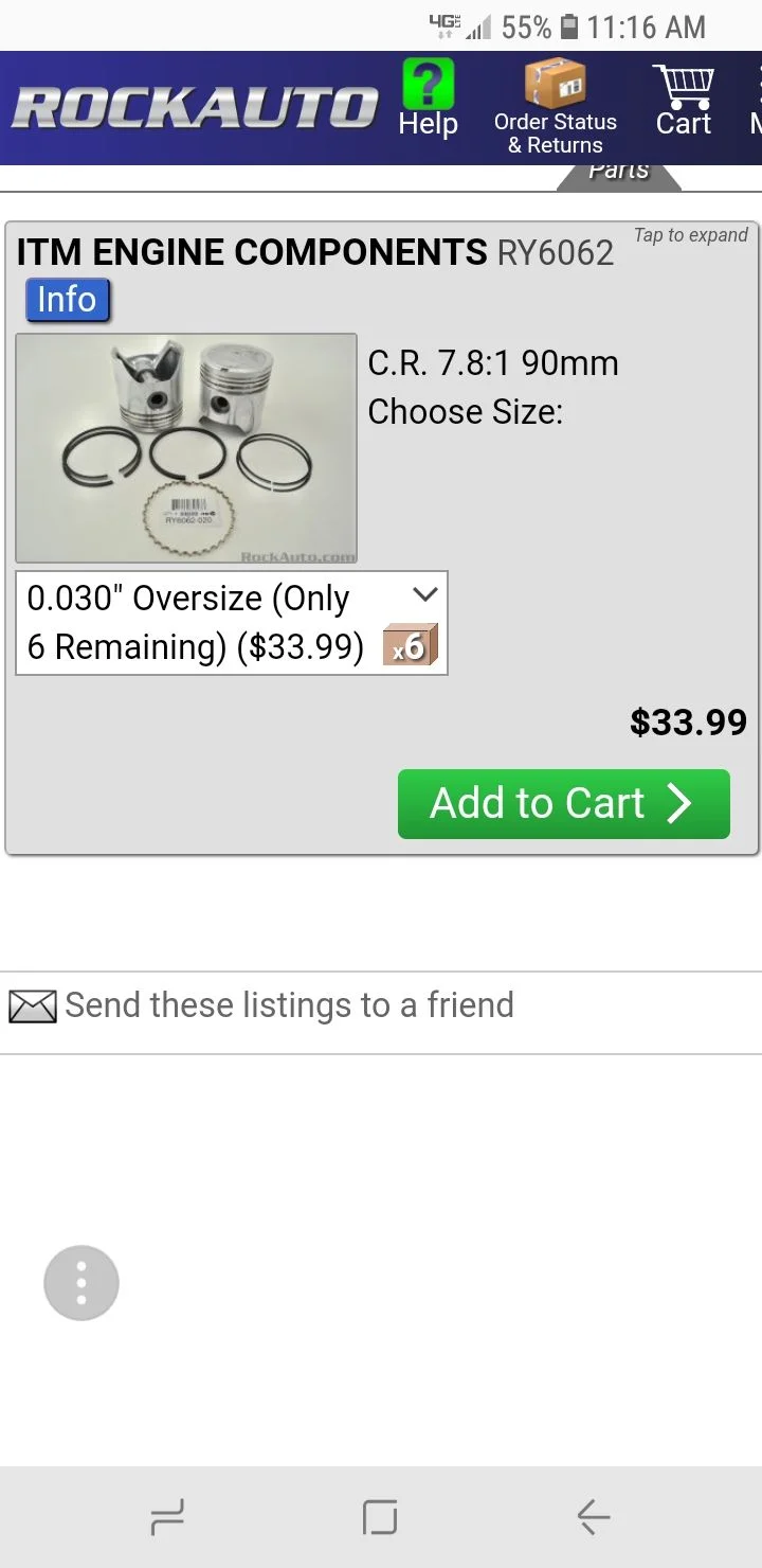

The F.5 pistons were still available last year from ITM. Heres rockauto. 6 in stock .030. $33.99 each
