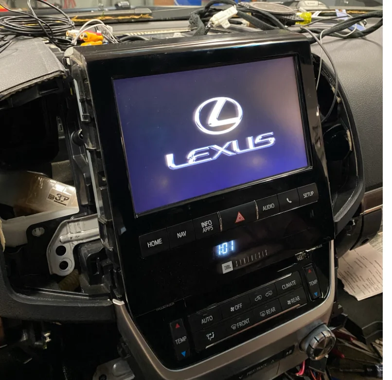

Weird. Never seen a Lexus logo.
@seajeff had posted about it in our conversation shortly after we all got our new EC units. It obviously isn't a huge problem, just something that's a bit odd.
