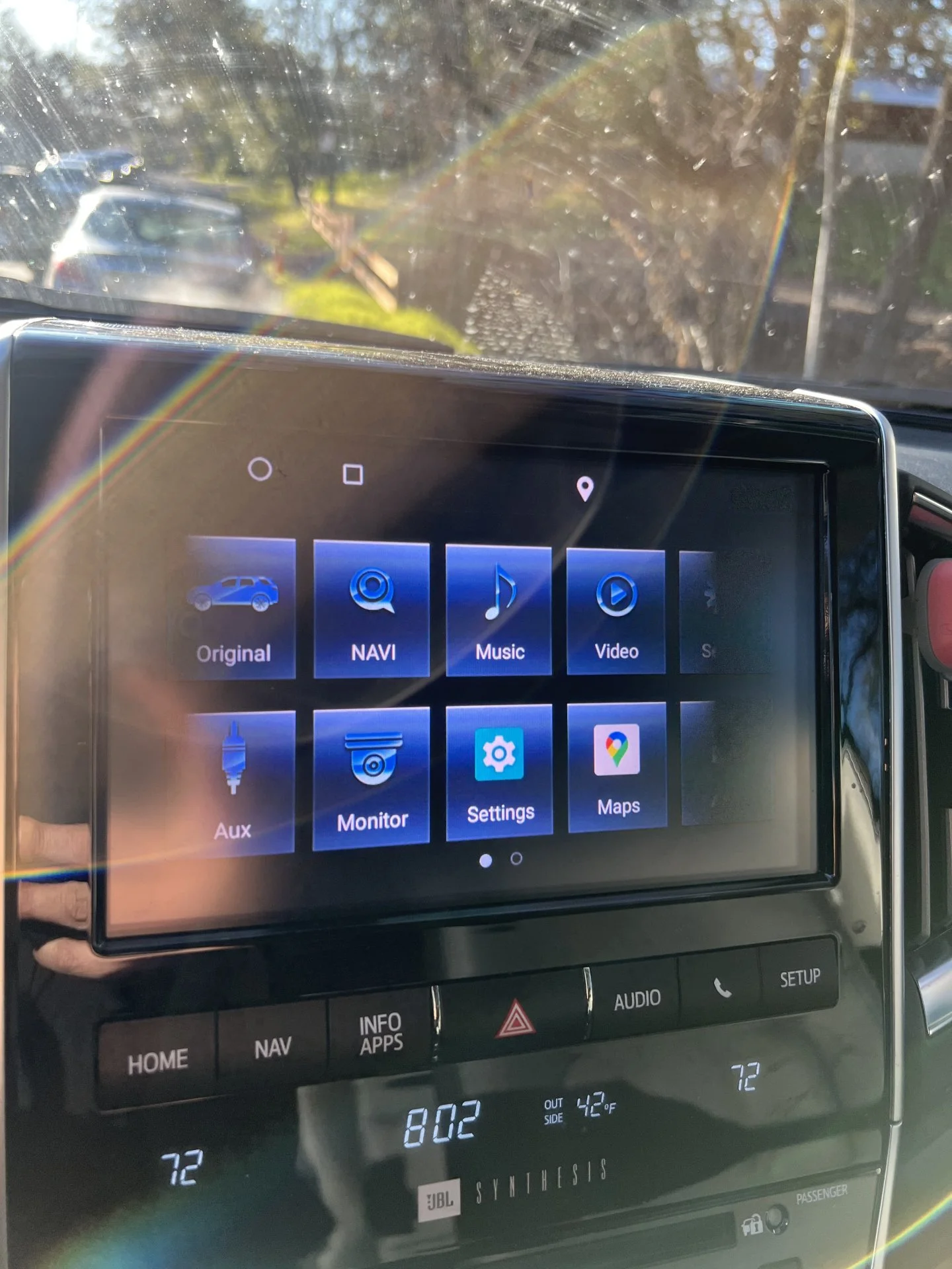

I did something wrong then lost carplay icon. Does any know what is the name of the app that can install?
Is the icon just missing or does CarPlay no longer launch automatically when you start the car up? If it's the former, you probably just deleted the icon from the app launcher and should be able to get it back by swiping to the next page and tapping the App+ button. If you managed to completely uninstall the app, you should probably contact EC Offroad for advice as it isn't an app you can install from the Google Play Store. It's possible you just moved the icon to the second page of apps by mistake.
