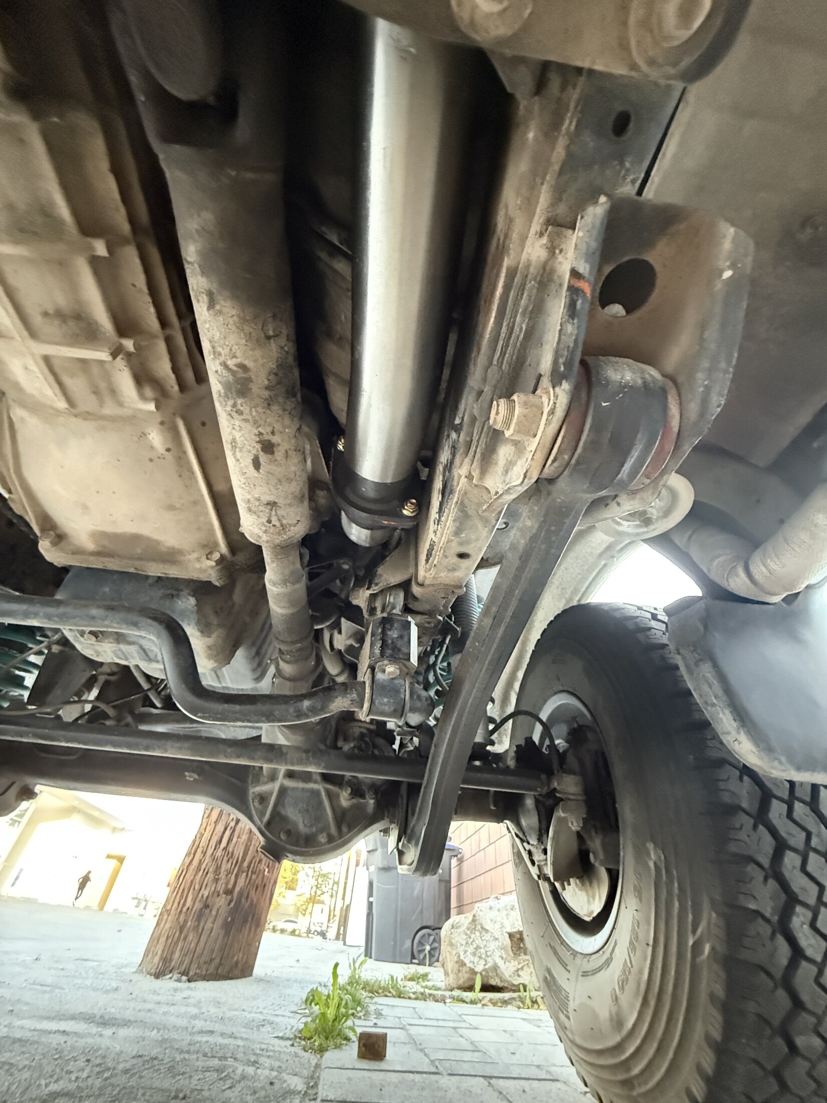

NEW EXHAUST!
Installed the Manta Stainless 3in exhaust system on the 80. I preciously had the PPD system, which was fine, but the quality of the Manta is far superior. Seems like thicker walled tubing. I love the cerakote at all of the joints. Most notably, the routing is better because it runs within the frame rails from motor to tip. I went with the medium noise level and it sounds amazing! Not too drony on the highway, but nive and throaty with the windows down.

Like the exhaust, looks like it fits well. Do they have a North American dealer or did you have it shipped from AUS?

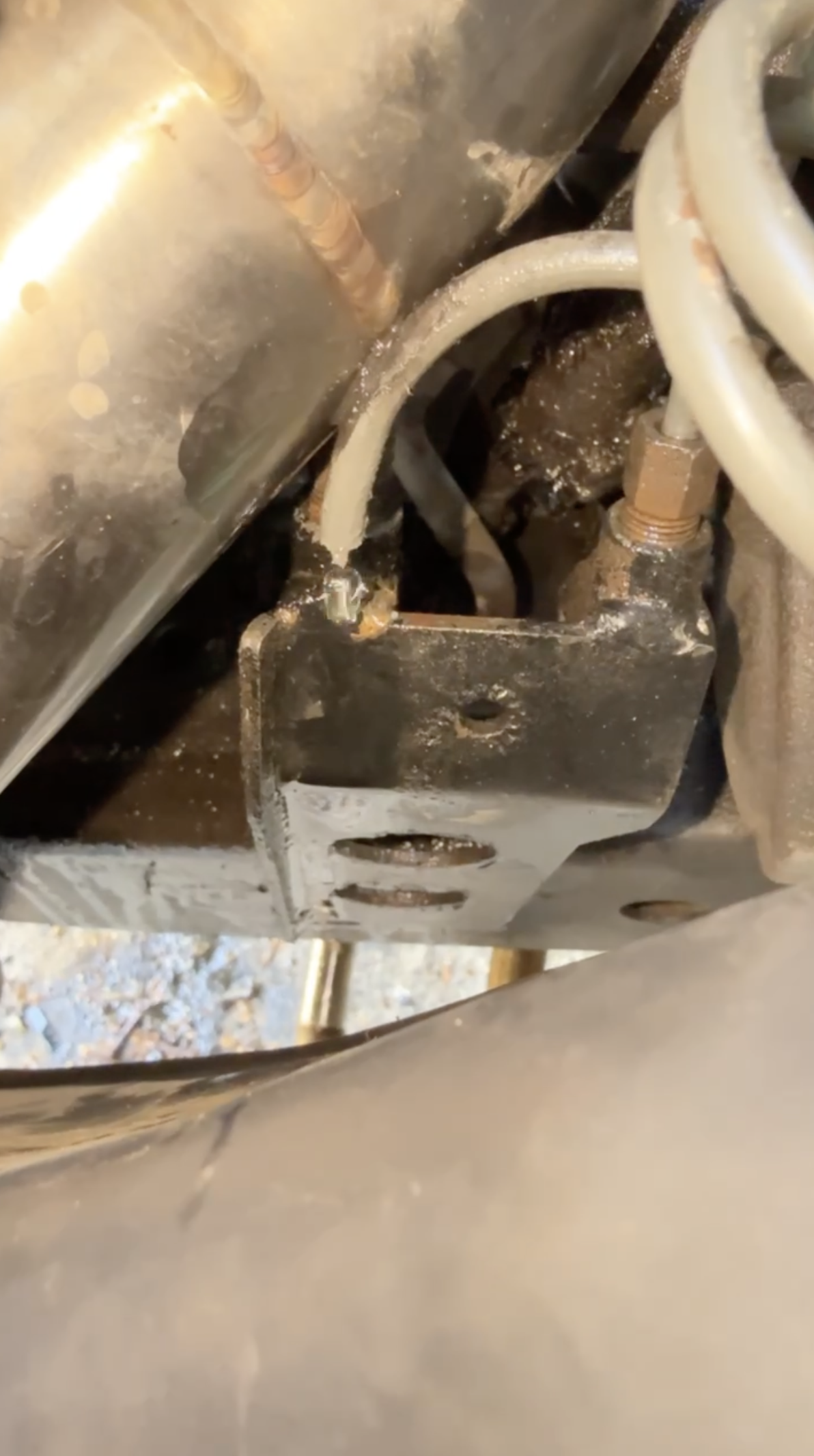

What i ended up finding was that the intercooler piping was resting on the brake lines that attach to the bracket near the power steering box. Over time, the stress has cracked, and eventually, completely sheered the line. The line that broke went to the drivers front brake.
I was lucky to find an m10 x 1 plug in my intercooler piping (where a temp gauge could go) so that i could plug the brake at the 'T' under the master cylinder. I then JB welded a brake fitting shut to replace the fitting i borrowed from the intercooler. I was able to limp it home 4 more hours with this fix.
Once home, I bought the tools and supplies to make my own custom brake lines. I felt I could shorten some runs and simplify things a bit... so i did. I used TIG rod to mock up and design a line before bending the Copper Nickel line. Everything is working great now, but I am planing to upgrade the Booster, master, and front brakes with Powerbrakes. Stay Tuned!
I am aware of this, the PDI manual says to take the bracket and move it but unfortunately the steering box is very close and the bracket can't be moved. How exactly did you route the line ?
I fully deleted the bracket and the lines doing forward and just made new lines do straight down from the master cylinder

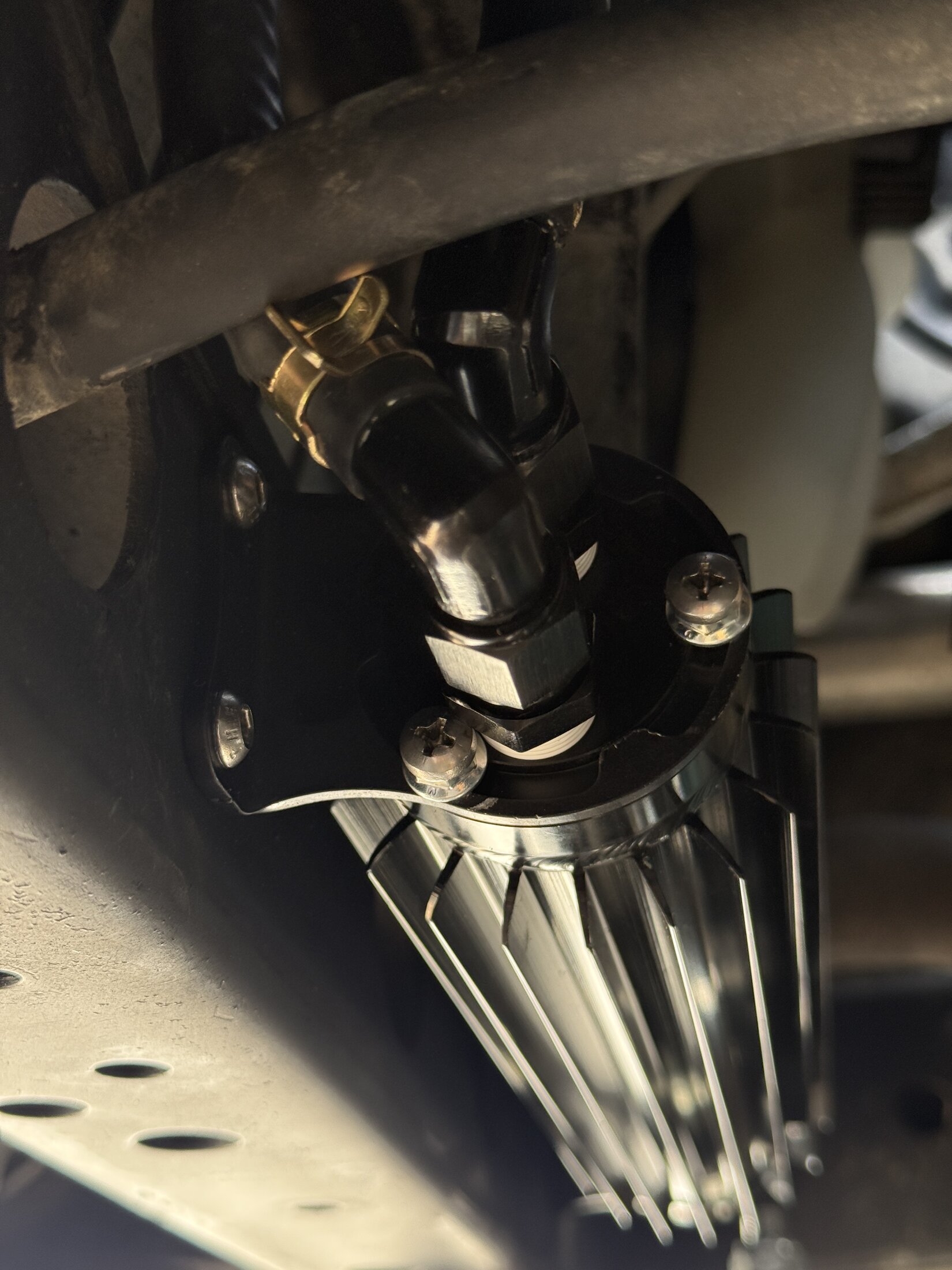

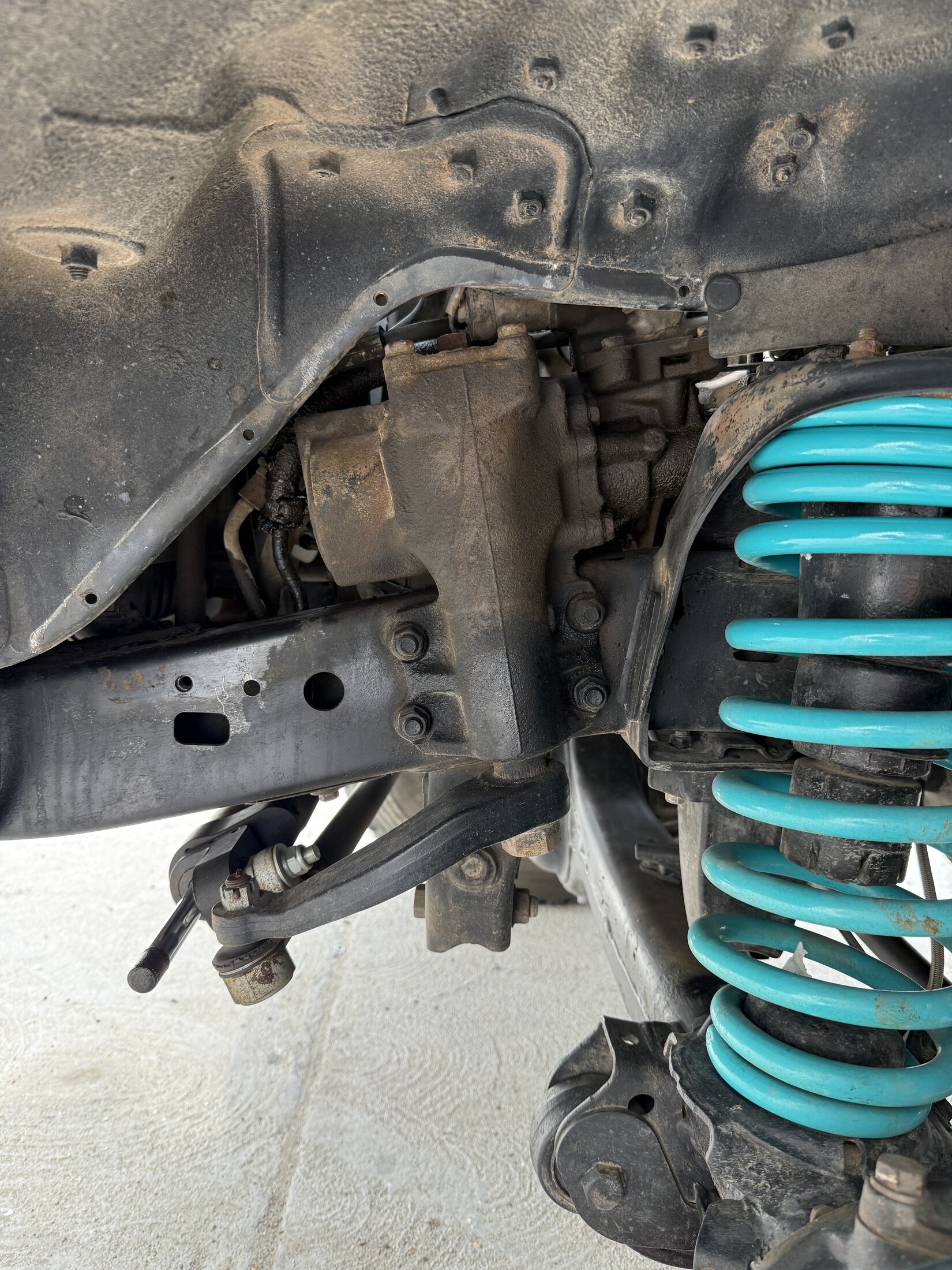

POWER STEERING UPDATE (UPGRADE)
I sourced and installed a brand new OEM 105 series box, new OEM 105 series high pressure lines, and I upgraded and relocated the cooler to behind the crossmember:
I cleaned and painted the frame with MRO Flat Black, which is a new favorite for OEM powder coat finish looks.

Why you didn't brace the mounts around the steering box which tends to crack frequently. Would be great time to do that when all is out.
