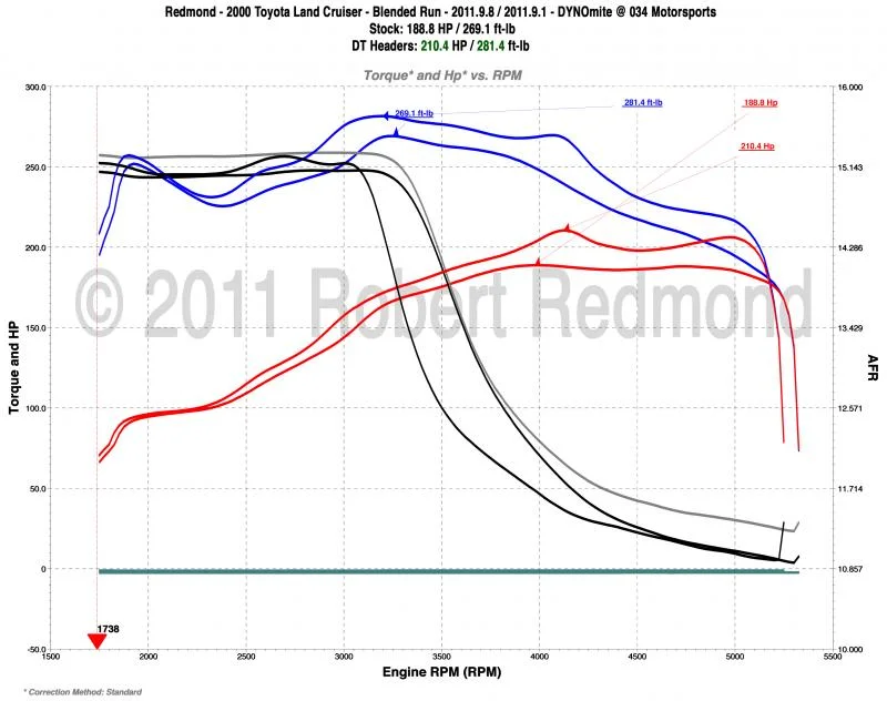

Awesome results - 20+ HP and 10+ ft/lbs torque - you should be able to feel that from the seat. Any change in gas mileage?
Too early to tell but it looks promising based on instant readout from Scan Gauge.
Kinda confusing about your adjustment to the initial run.
Sometimes when you do a run you 'll get anomalous results if one of the variables change, like maybe the truck hiccups or the operator changes throttle input etc. The initial run (as often is the case) was reviewed for the best result we could get. Upon further review it was discovered that out of the 10 runs the high number was anomalous and didn't fit with the other 80% of the results. More over it was unlikely the LC would only have a 10% driveline loss, especially in light of it's 146k miles. To put it simply we threw out the high result because it was not in character with the real world or the other control land cruiser on hand.

Muchas Gracias Roberto Rojo.. 210 is a pretty good number, works for me. I'll concur there is a noticeable increase in all-around power, little better response, and a touch more "staying power" on grades. thanks again for the efforts here, really cool to have some numbers to back up the seat of the wallet/seat of the pants results. :cheers:
How did the one anomalous run throw the initial curve so high? If there were 10 runs wouldn't that be less impactive to the overall average? Or am I misunderstanding how the average is calculated?
Thanks for the time and effort Rob! Not trying to knock your efforts at all, just trying to better understand what's in the numbers.
Edit: I guess I'm also confused at how the dyno could be erroneously high in the first place. Dynos can only measure wheel torque, right? HP is just a product of torque at RPM - straight math. So for the HP number to be erroneous, either the torque number had to be off or the calculated RPM was off. Trying to figure out how either could be high? Could it be caused by an open center diff doing funky stuff on the dyno between the ends?
The torque value/curve has been essentially consistant in all runs which is what the red flag was to begin with. It's hard to say why it happened and I think in the scheme of things it's not important. Today was 3 runs all with the same results.

If you look from left to right, you'll see there is an increase in both power and torque starting a lot lower than 4k. I wonder if there is an opportunity to reprogram the ECU to take better advantage of the headers?
Absolutely - the lower AFR curve is from the headers run. I would bet that some ECU tweaking could pull a lot more out of this thing. Thinking about testing a Cat Back system as well. This my friends is a slippery slope.

Really? Not saying that I spend much time in the nether regions of the tach, but with the autobox there's not much you can do. If you need more power for say merging uphill it's just gonna go there. And that's probably the biggest benefit to the headers - expansion of the WOT curve for events just like this. Not much will be gained on the trail...
