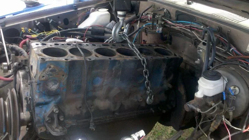

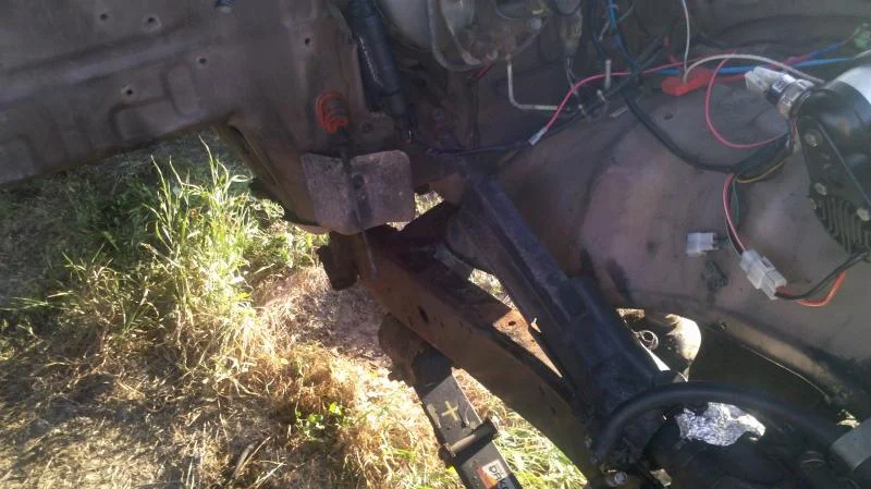

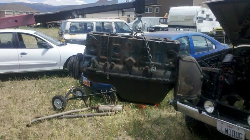

The 2F has been pulled out of the rig! Big time Atta BOY! from my wife. Pics below on the pull. That is Jake in the second pic, at his Cruizer Barnlot. His picker on the end of his truck.

couple more pics, especially the EMPTY BAY :bounce:

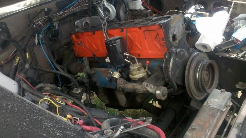

Now is the time to clean the engine bay so that working in it during the swap doesn't make a mess of you. It's a bigger project than I thought it would be. Recommend a high pressure washer if one can be sourced.
What are all the wires along the top of the firewall and the gizmo on the drivers fender? You launching the shuttle from there? :lol:
I used some fast orange degreaser and a green scrub pad on my engine compartment after I yanked the engine - turned out better than I hoped. There is paint under all that gunk!
yeah you are seeing my poor wiring habits in the open.
I have an O2 sensor and gauge in the rig for a Microsquirt controller which I may put in in the future.
On the passenger wheel well is a mess of wires to and from various relays for head lights (hi and low beam) and the flood lights on the roof, and some other items. You can also see the POSITIVE junction post. I run ONE large positive wire from battery to that post and then ALL other draws for power come to that POSITIVE post. Got the idea from a post on this site, I think from the Under $50 thread
I need to clean those wire up properly and make it look better and protect and route the wires more securely and attractively.
On the driver's well is the Air pump for the air locker in the rear.
And yes, I have been waiting to get the engine out to clean everything up. Jake has a pressure washer and he is hooking his carpet cleaning van with proper attachments to the water tanks therein for a water source for the washer. Then I need I hot day to "get wet" and clean it all.
Need to take off the gas vapor canister, vac hoses, and other stuff I won't need with the SBC, as well as the tranny and mount. Then we can grind the engine mounts off and make it all real purty.

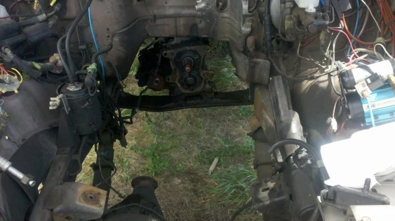

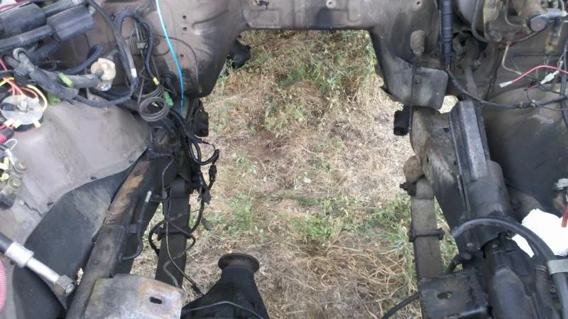

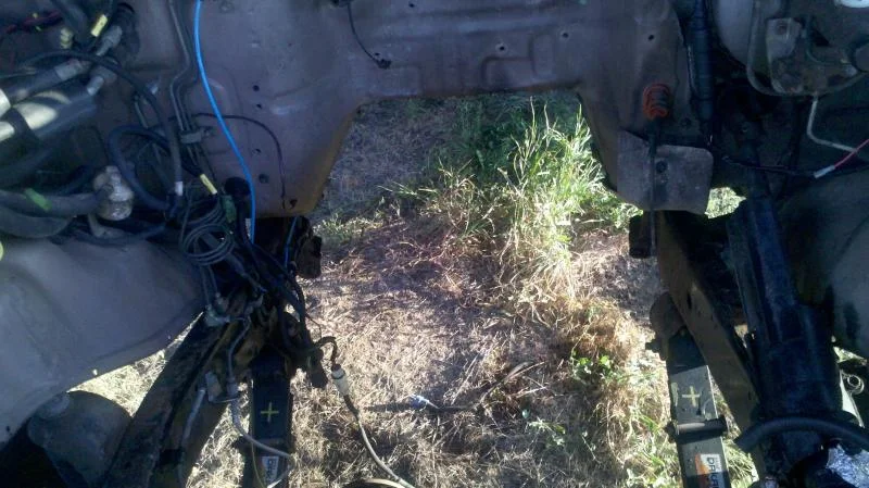

Finally (after a crazy and busy month) spent yesterday removing the tranny and TC, and cross member. Picture of the 'hole' below
THEN spent $35 at the pressure car washer removing the oil/grease/dirt/who-knows "junk" on the front of the frame and surrounding area. I did use some ORANGE Gunk degreaser.

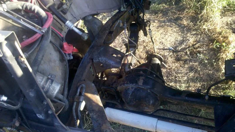

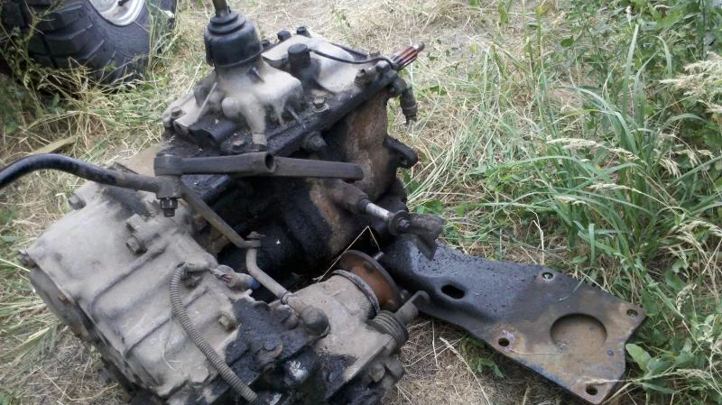

pic 1, the 4-sp and TC together (is there a market for the TC?)
pic 2, the now (finally) empty engine space but still pre-wash
pic 3 post wash, but bad lighting MUCH better to work in there now

more after wash pics
