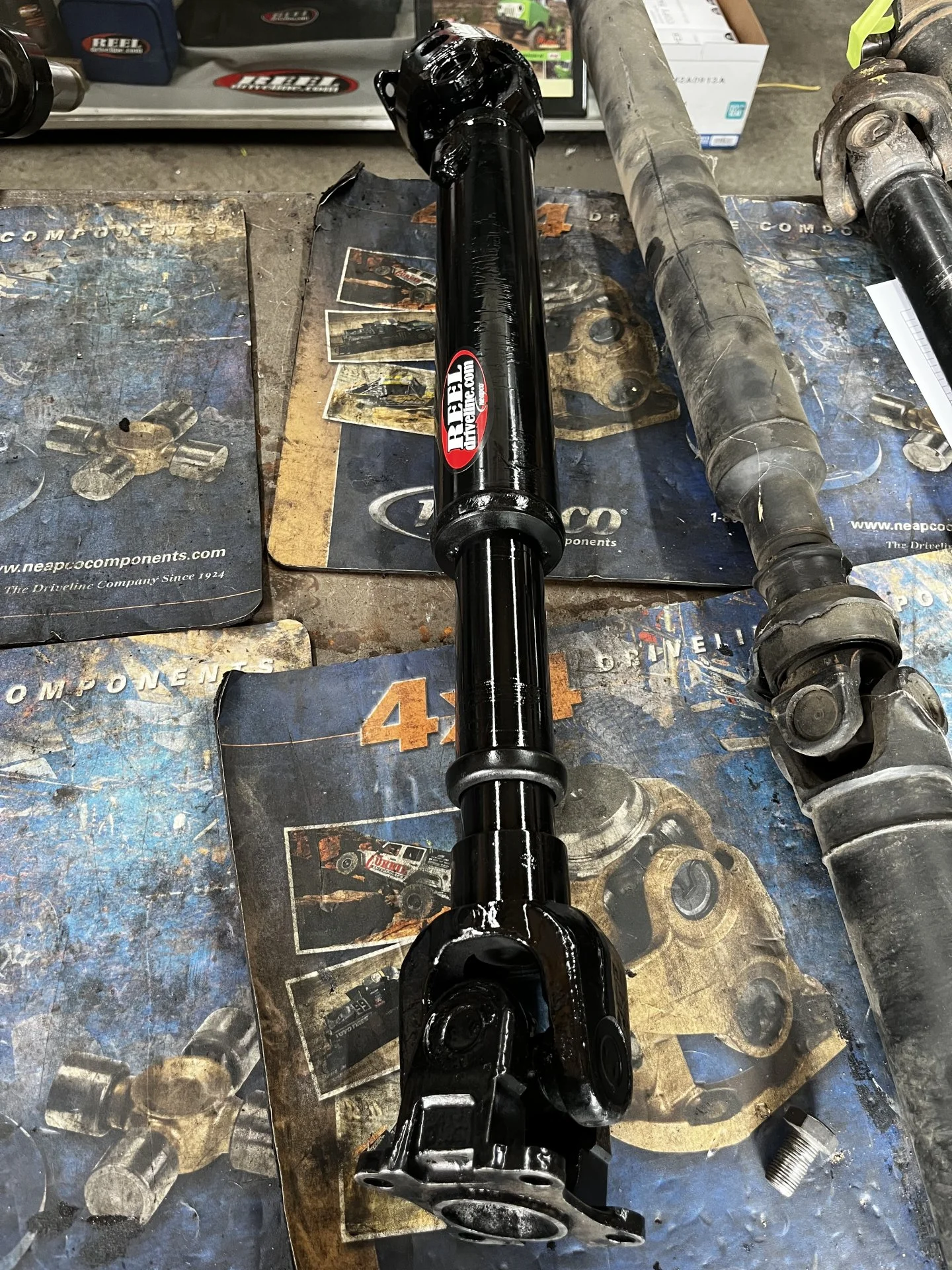

In the meantime, picked this up and will install today.
JE Reel's Scott has been easy to reach and handled all my requests/questions with aplomb. I spec'ed it with all Japanese bits which include the Matsuba joints (i.e. no Spicer).
We'll see how it performs!

Looking sexy. Any zirks on this one they quoted you for $750?
All the joints and shaft just like the landtank unit! Scott recommended I use Lucas Red & Tacky every other oil change for posterity.

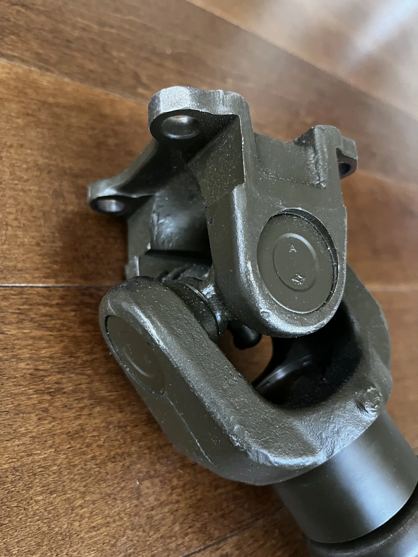

I need to verify whether I've lined up the two ends correctly as the two came apart when I pulled it from the cylinder box from the single joint side
Single end
DC end
There are 5 zerks: 3 in the CV joint, 1 in the slip yoke and 1 in the front u-joint (doesn't come pre-greased)
One thing you’ll like is how easy this shaft is to grease when installed on the truck. The centering ball on the factory shafts were always tricky to get to when on the truck. When this shaft is oriented with all the zerks pointing down every one is easily accessed.
