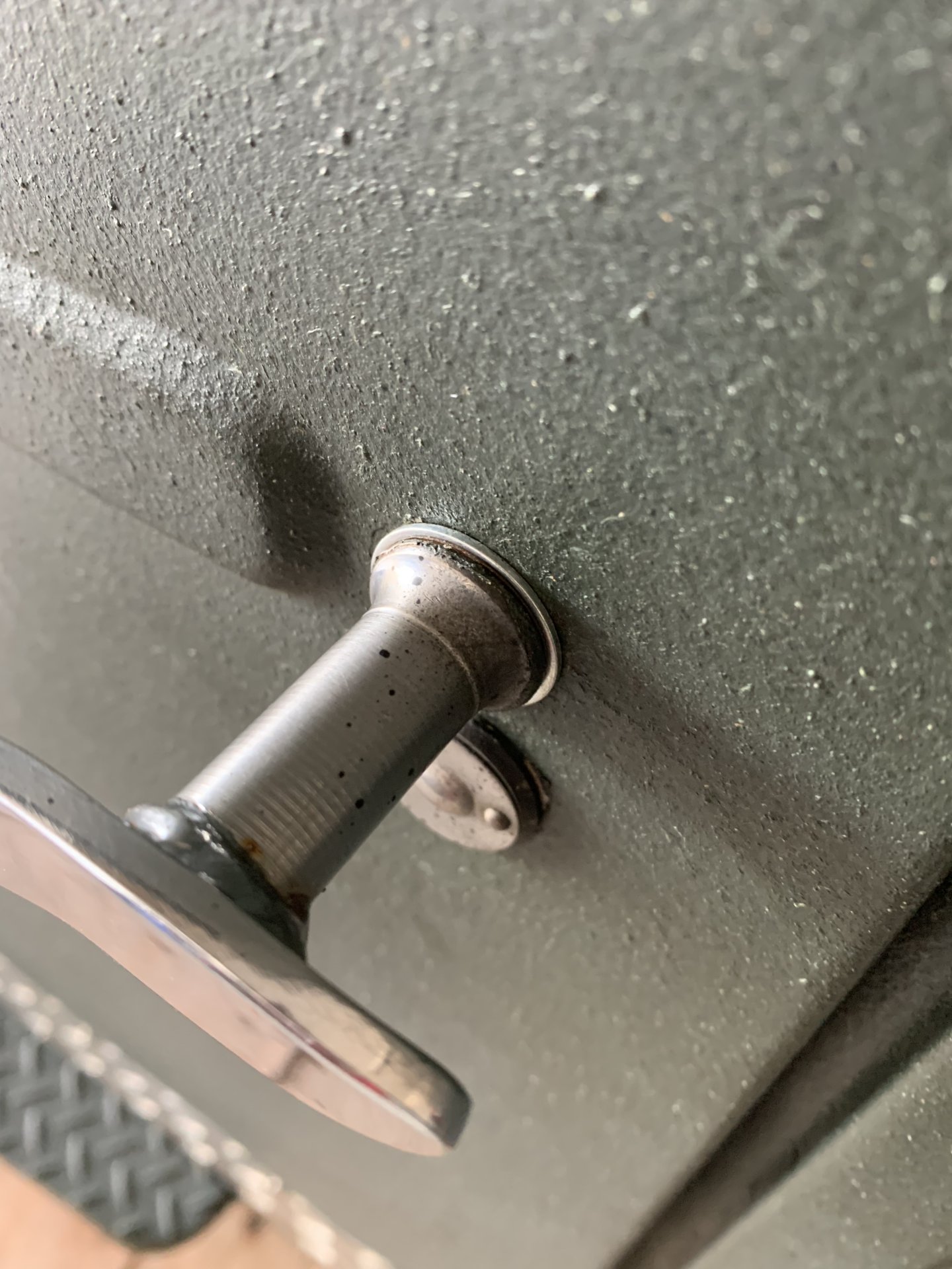

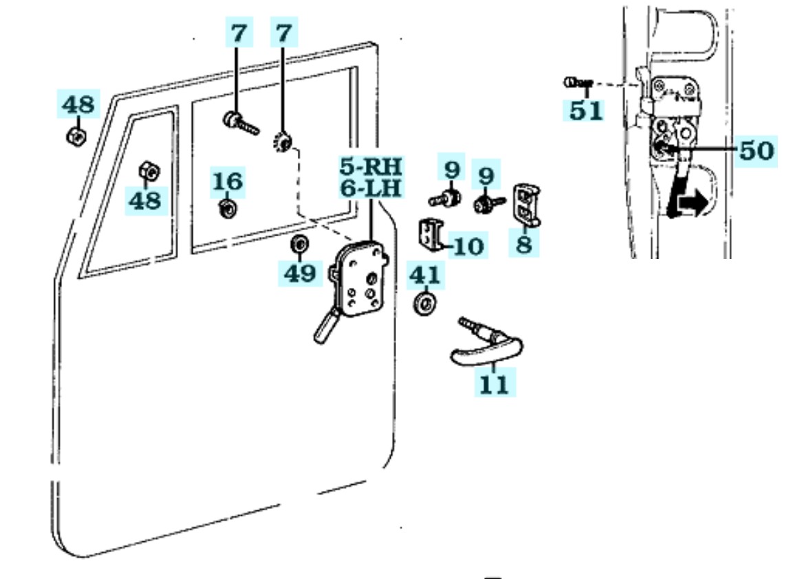

Hello, all. I'm relatively new to the FJ game here.
I've just replaced both door handle actuators in my 73 FJ40. The new actuator works great. Problem is, the outer handle (Part #11 in the picture) now wobbles. There's a tiny gap between the handle and the door (even after reusing the old washers). I'm thinking I need new washers (Part #41) but can't seem to find one anywhere. I tried a teflon washer that I found at ASE Hardware, but after installing it, now the handle doesn't automatically return after you unlatch the door. I had to loosen the retaining nuts on the inside of the my door in order for the latch spring to be able to return the handle - which again caused the outer handle to be too loose and wobble. Any ideas from the experts out there?

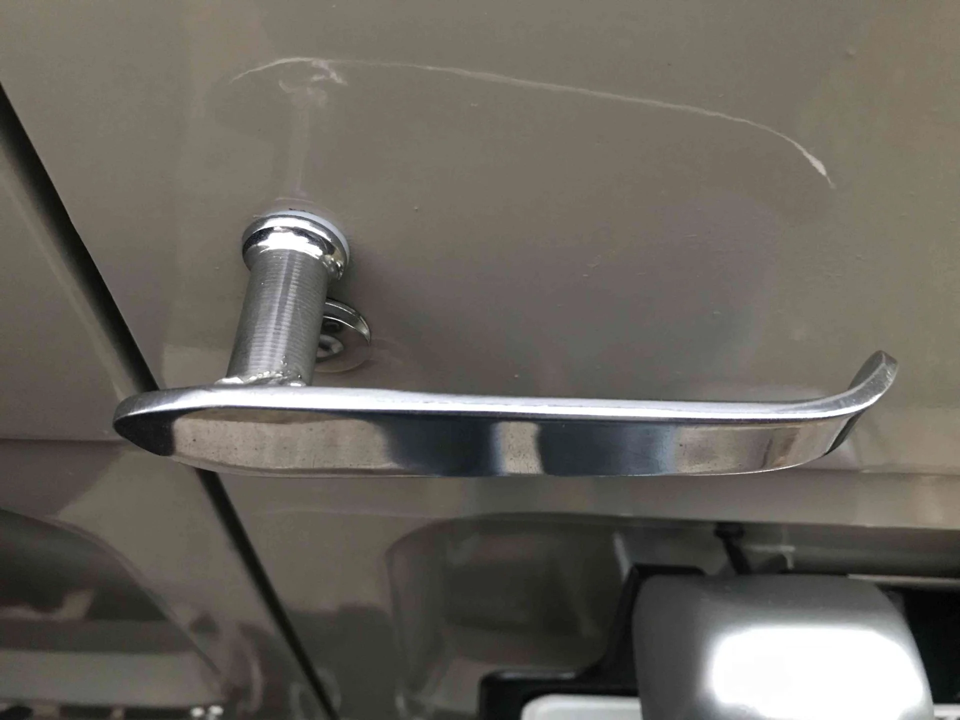

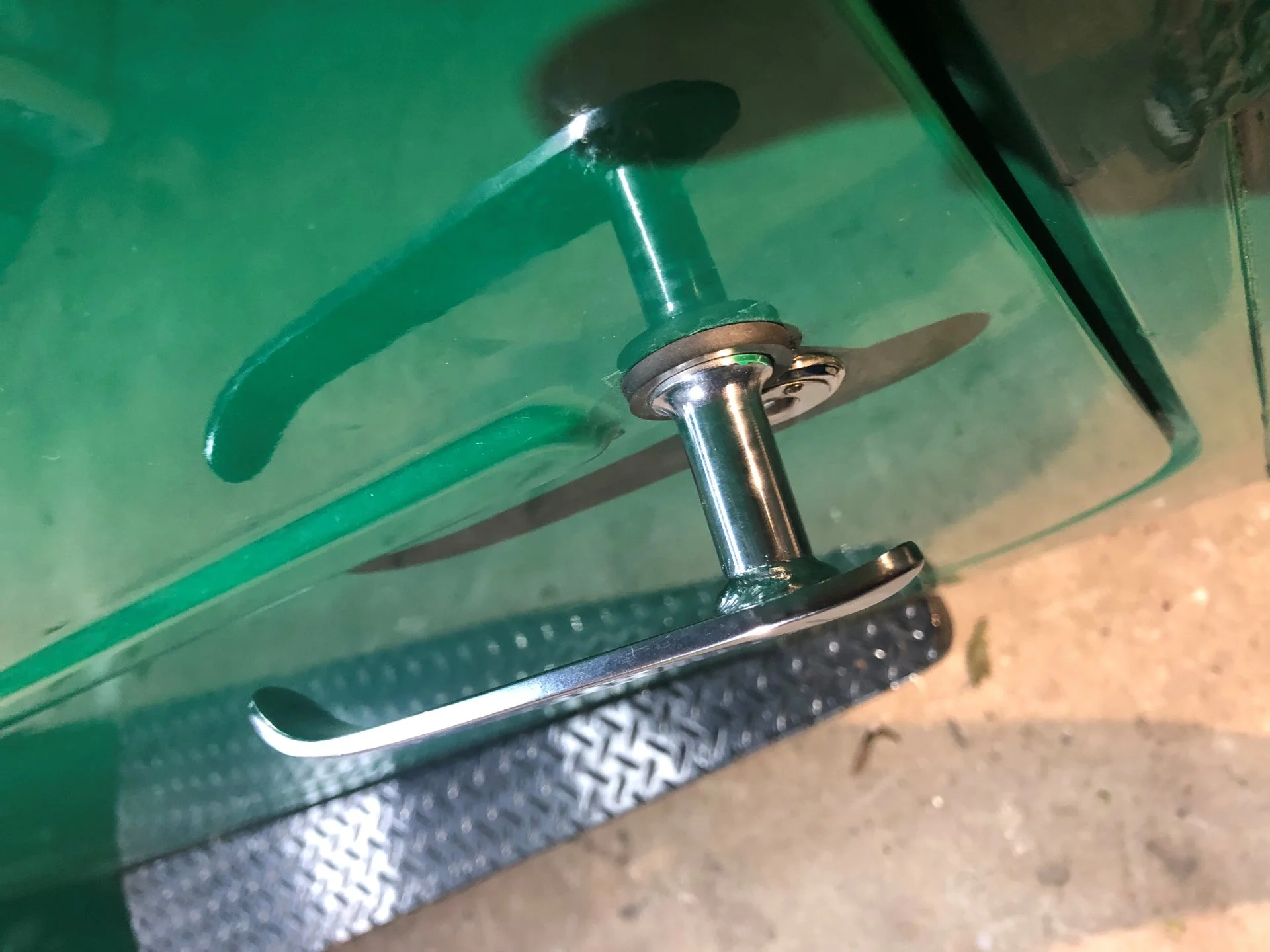

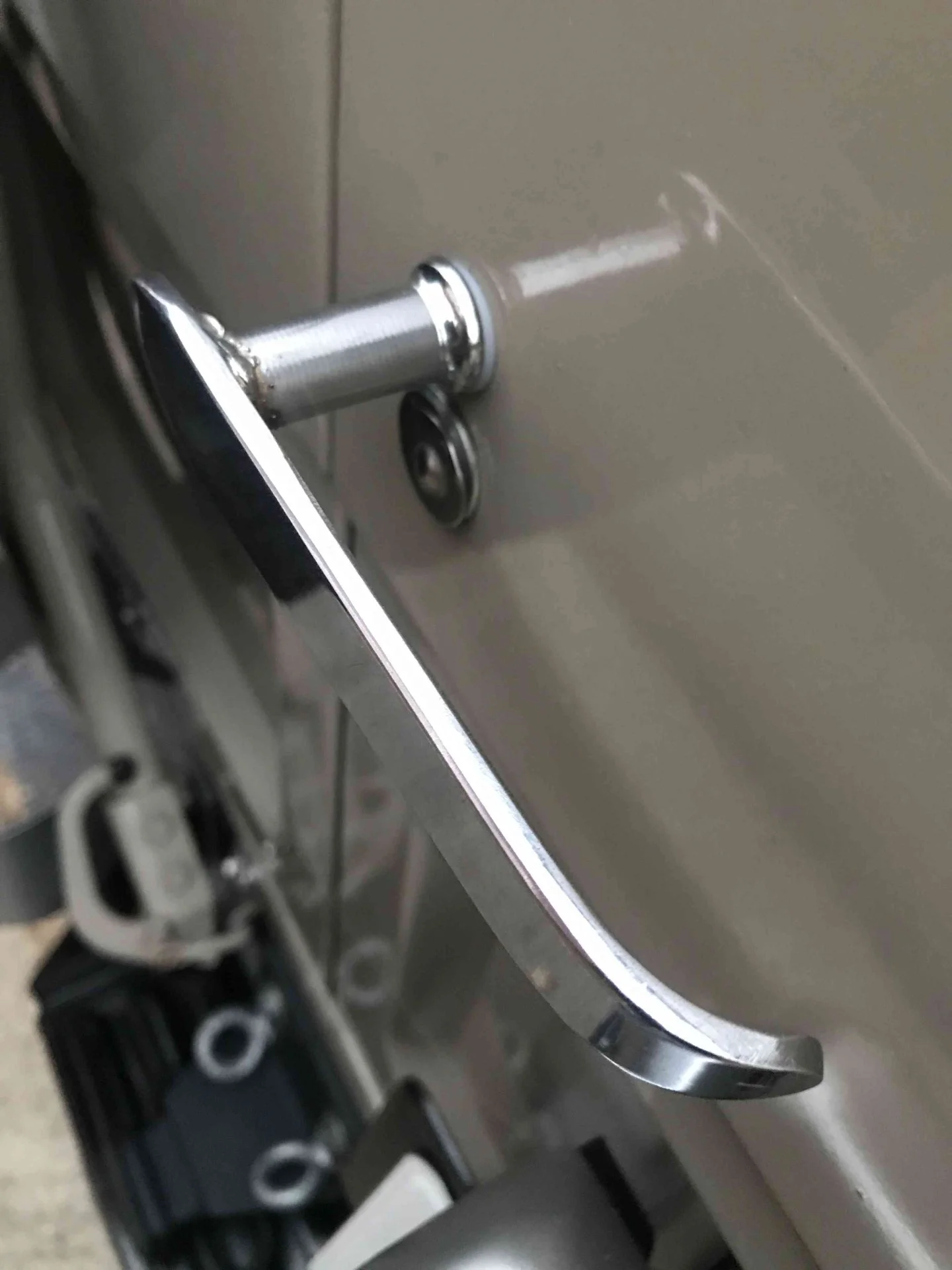

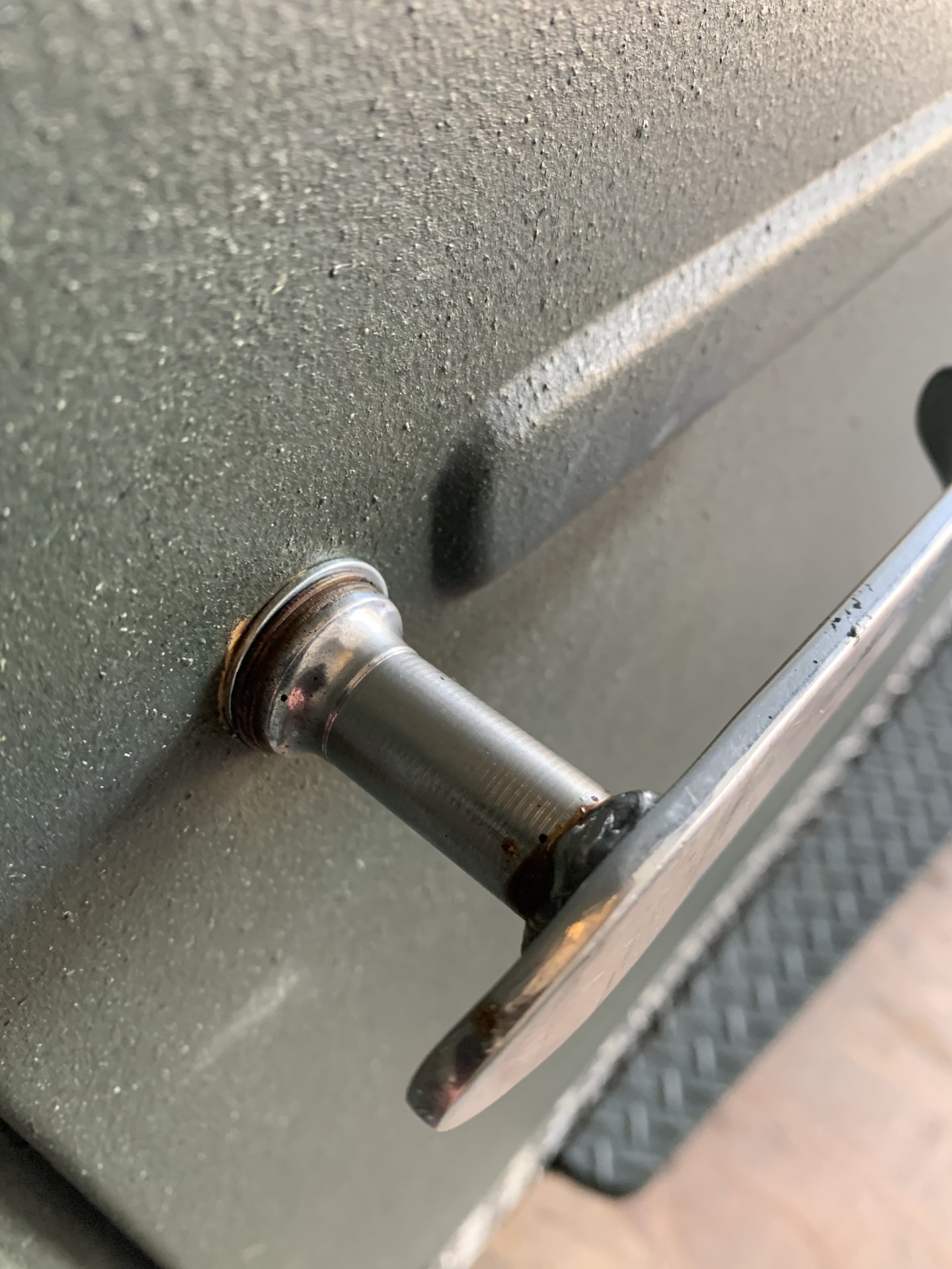

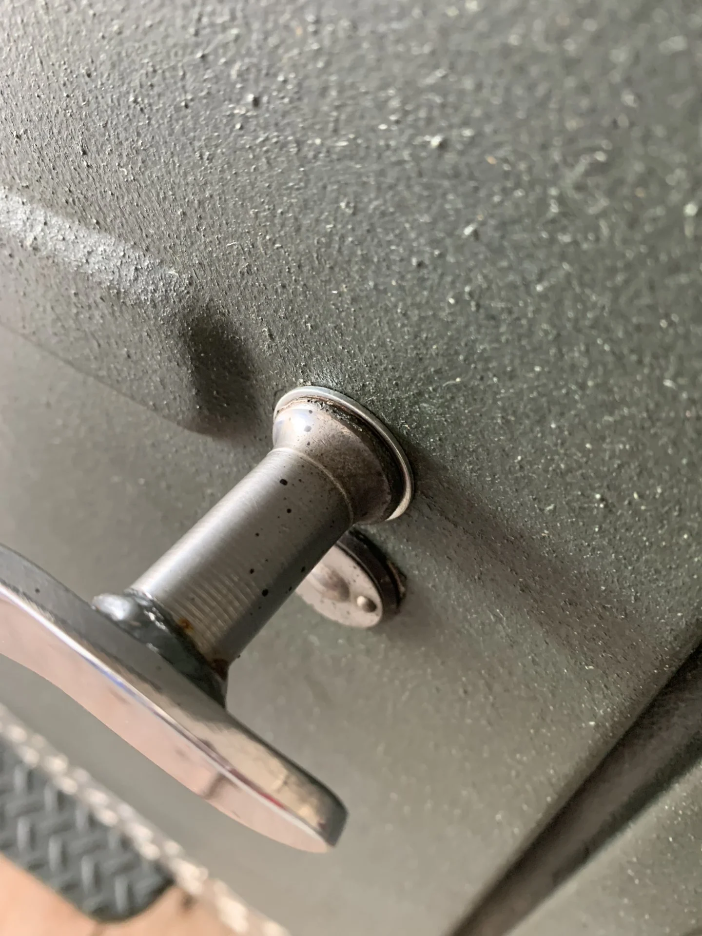

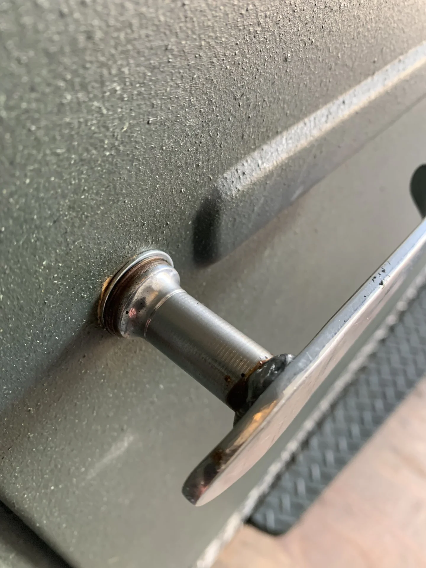

Here is what worked for me.

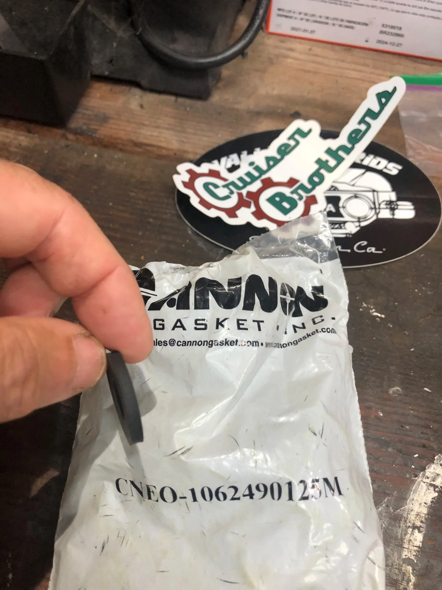

Spent the morning on the phone with Cannon Gaskets and later McMasterCarr (refered by Cannon). I think that rubber washer has been discontinued. I'll check out ACE Hardware again.
FYI: Looks like McMaster still has them but you have to buy a package of 50.
Oil-Resistant Neoprene Rubber Sealing Washer for 1/2" Screw Size, 0.49" ID, 1.062" OD, 0.11"- 0.14" Thickness.
I still have a whole package less the 2 that I used. PM me your address and I would be happy to send you some.

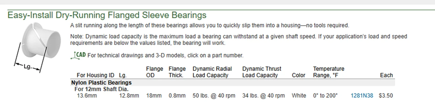

Here is an option for a door handle bushing/grommet if you have access to a 3D printer.

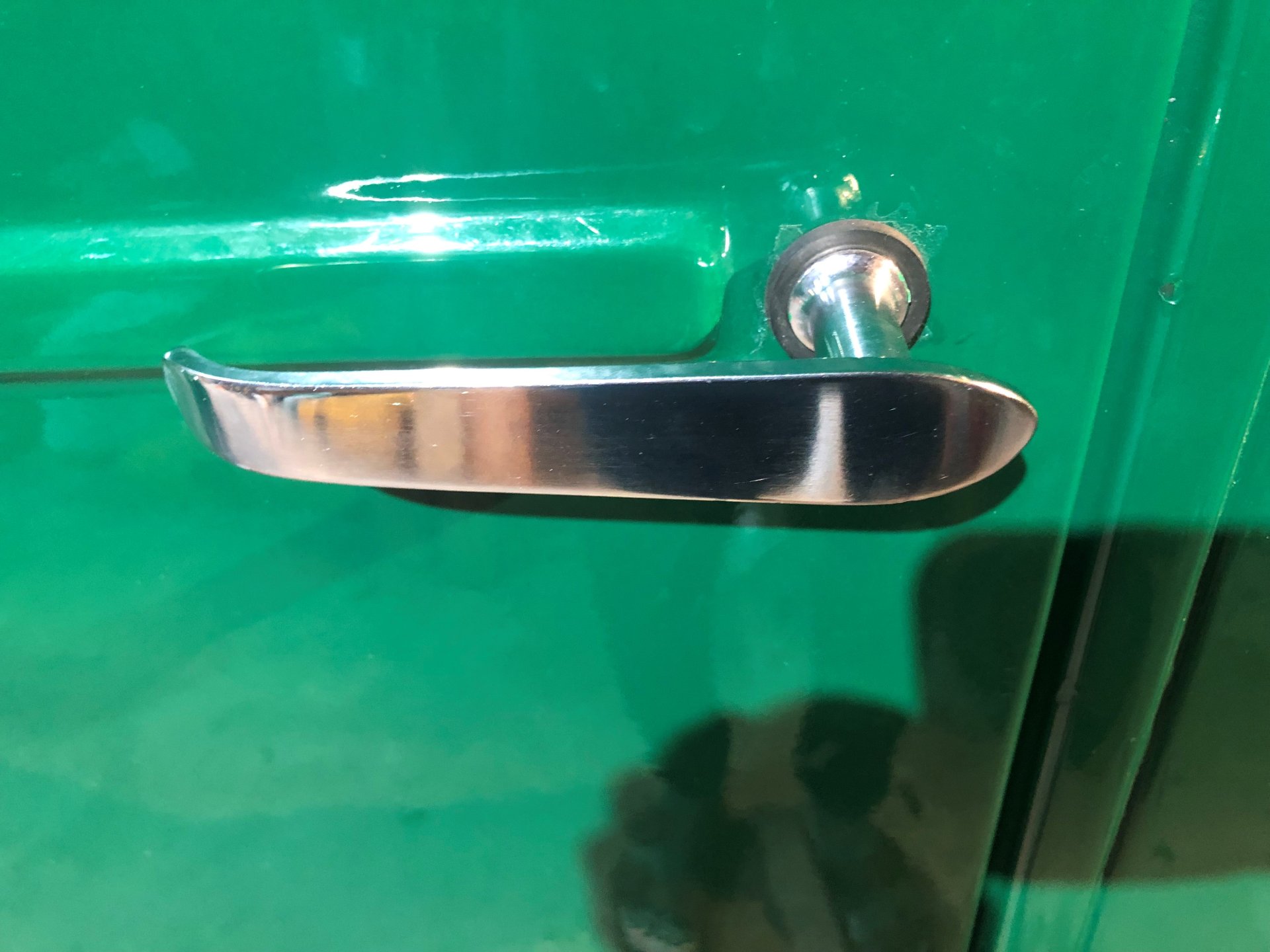

Here are the results when using the grommets.
Thanks. Appreciate the link.
Sadly I'm not up on 3D printing but I did use the dimensions in the link I.e. 12.1mm ID and 13.5mm OD.
I got a brass bushing at ACE hardware store that's 12mm ID and 15mm OD.
