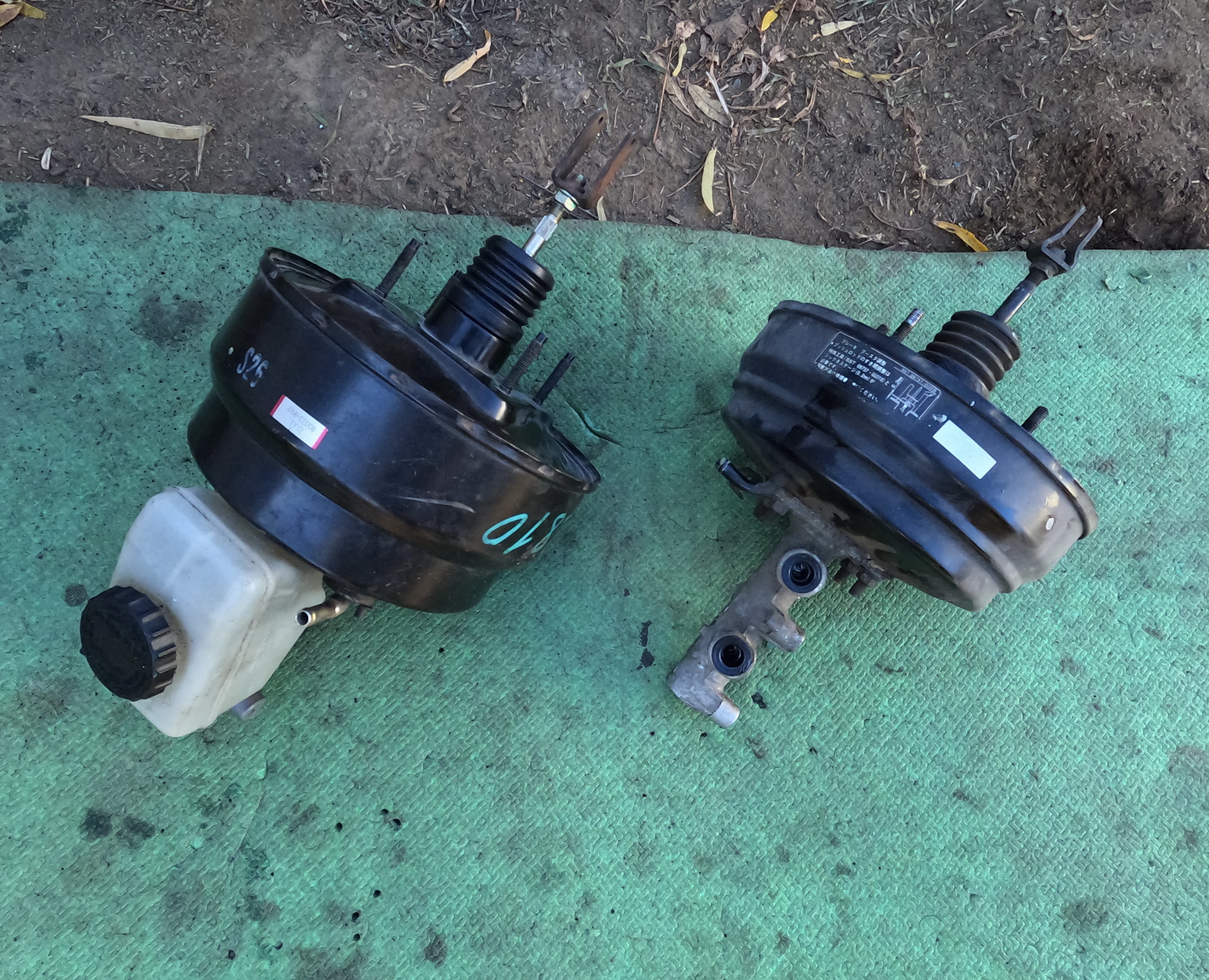

Ls430 vacuum booster, no needs any modifications for installation.
Works 60% better than stock

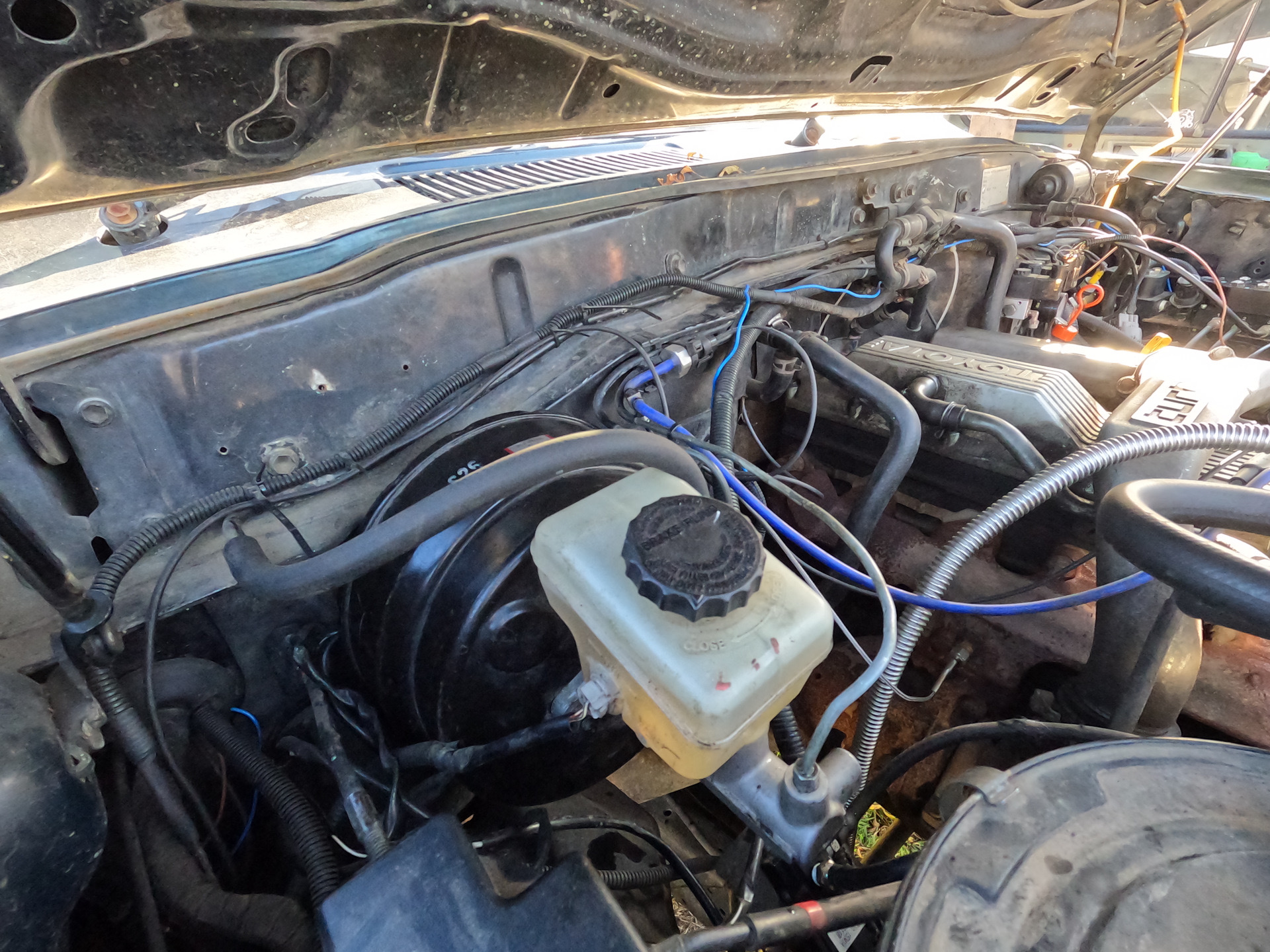

i know most said about the same thing but i will again say now is the time to check everything.
if you wanted to ditch the LSPV or ABS its a great time. replace the rubber lines with braided and extended ones. check all your calipers and replace them if needed. the system is already open so might as well inspect and replace everything needed so you dont need to bleed it out again for a while.
Are you replacing the master cylinder and reservoir with ls430 components as well, or just the booster?
I replace both. But if your master cylinder has 2 bolt flange, you can mount stock
Awesome, thanks! This seems like a great alternative that doesn’t require having to mess with the power steering. Is there a specific year range of ls430 boosters I should be looking at? Oh, and does anyone know what bore size is? I know the t100 swap has been popular, but some have reported pedal feel might not be as desirable, but I really don’t know.
all years are same
