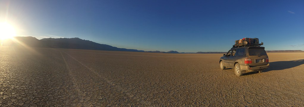

I've put 500-700lbs on top of the poor LX across 4 steel heavy duty crossbars using that config and gone 4-wheeling without a problem (yet).
Obviously the handling dynamics of the truck shift for the worse quickly with that much weight that high up and potentially create significant more roll-over risk.
