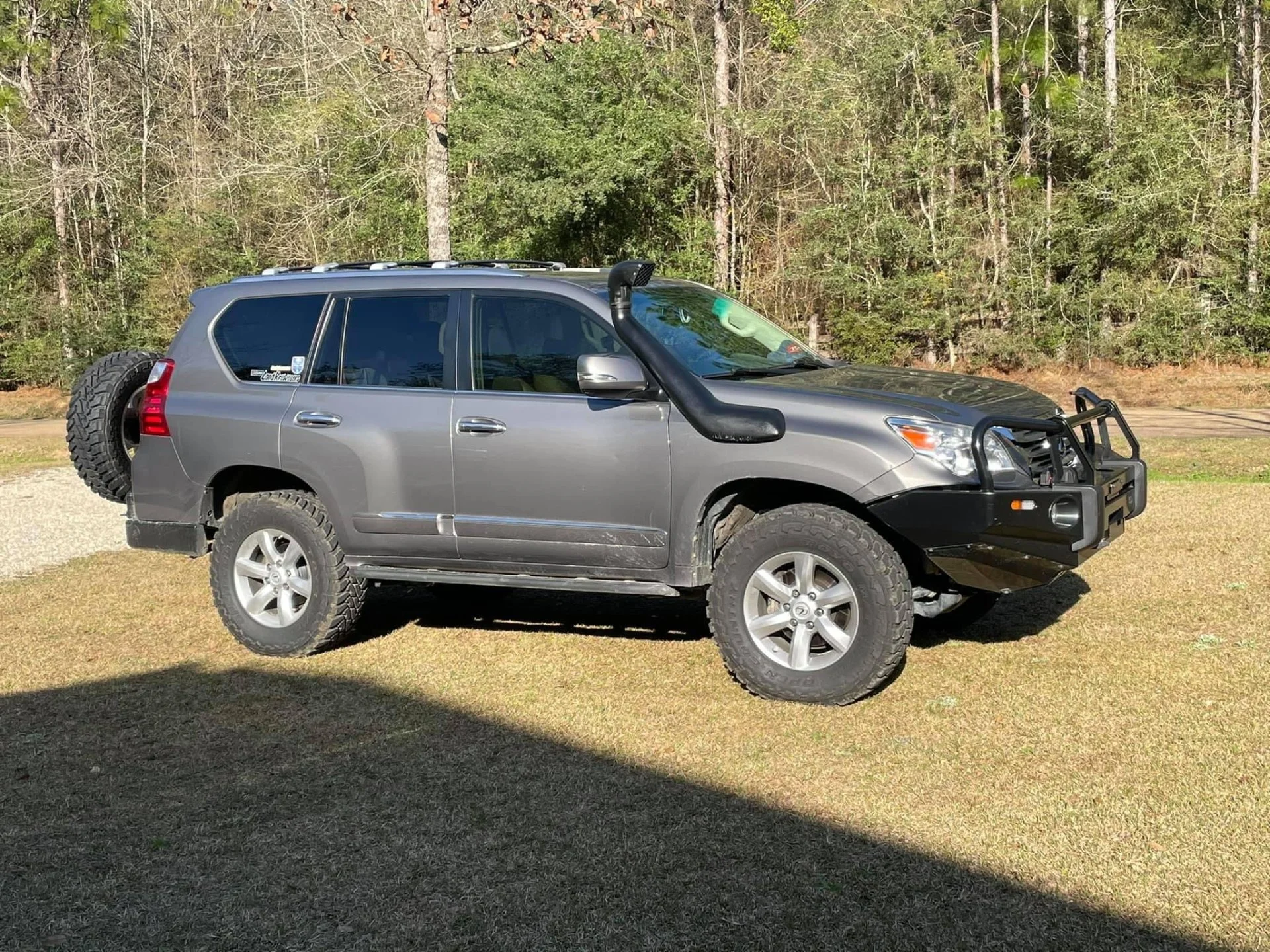

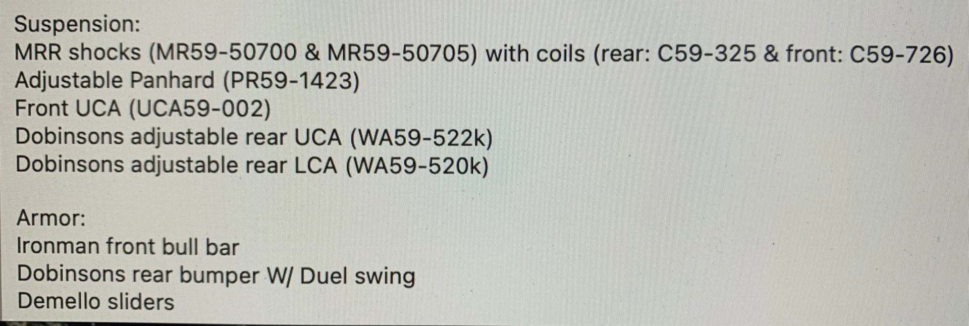

Call Kyle at Treaty Oak Offroad. He can walk you through everything and answer all your questions. The PO (who is a good friend of mine) I bought my rig from set my 2013 up with Kyle and is almost exactly what you are doing. This is what he did (keep in mind it was a few years ago and I don’t think the IMS was available at that time).

So with this set up, will it ride pretty close to stock ride and it'll have no problem with a front bumper like yours weight wise?

I have no idea how a GX460 rides with the stock suspension. I've never been in one other than mine and it was already lifted. The PO put 10 ply E rated MT tires on it not long before selling it. To me, the ride is a little harsh and I attribute a good portion of that to the tires. They are only aired to 32lbs but I still think it's mostly the tires. Up until this point all my rigs have been solid front axle so I am used to a harsh ride however, I need to look into softening this a bit. I am still learning this IFS stuff. ;)
As for the different heights, the GX has a natural forward rake so the difference in height is to level it out a little better.
