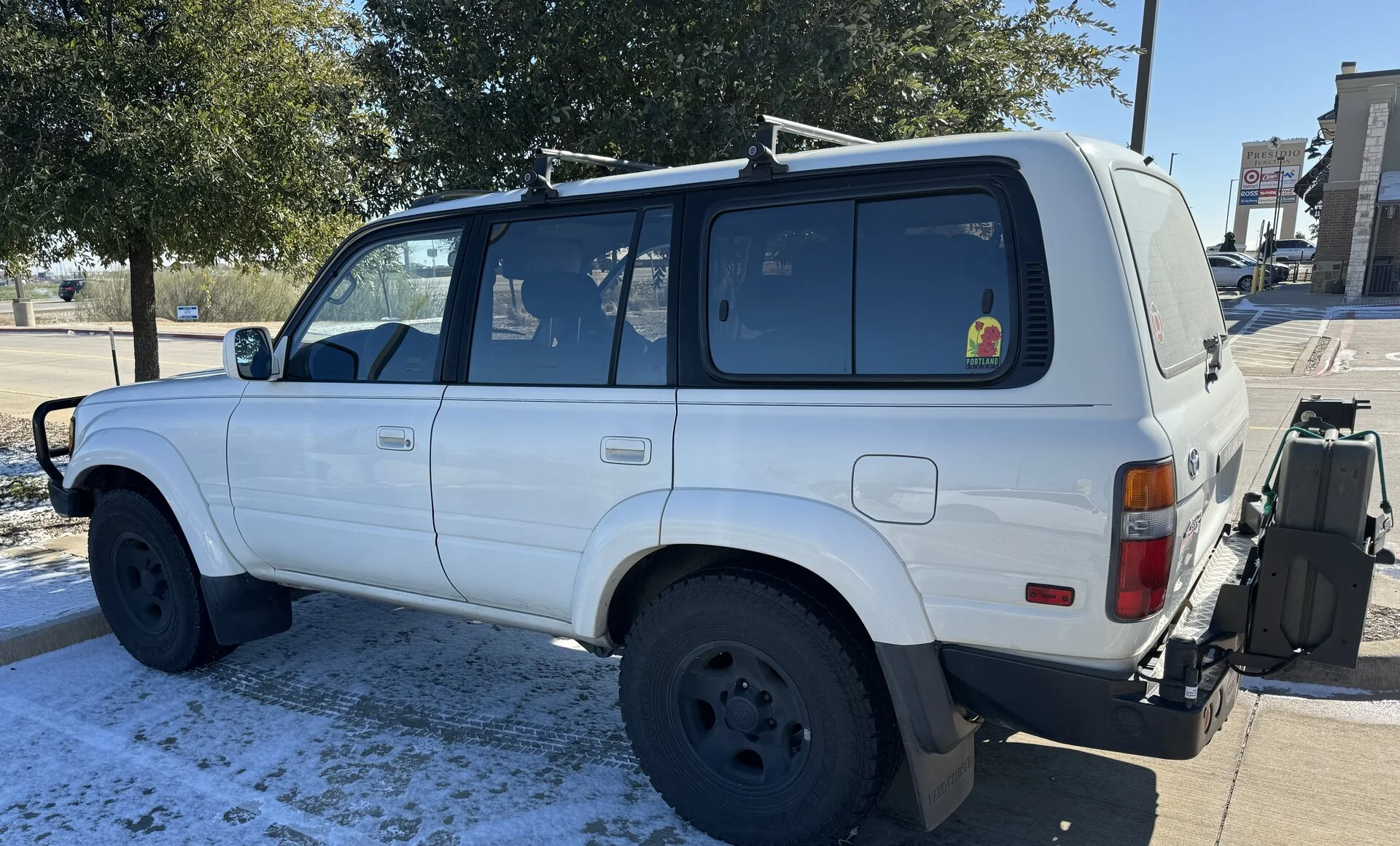

Ok, my wheels are the stock wheels that came on the Cruiser.. I was not wanting to have to lift it much if possible for if I do cross it up like this , I don’t tear up my fender wells and get some droop too.

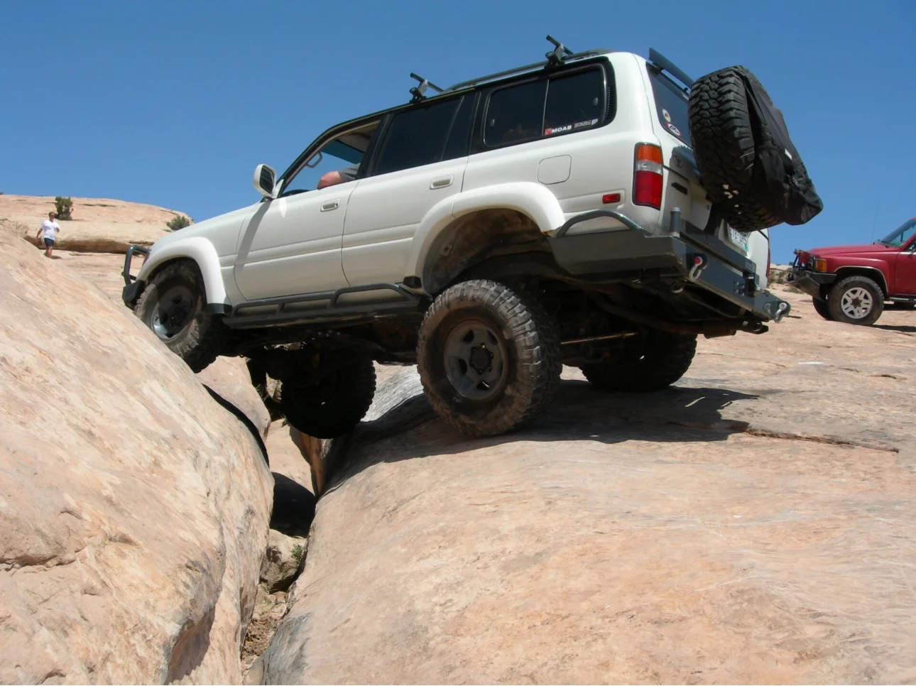

My rig is similar to this one… same color , same front bumper and similar rear bumper..
You cant really go by what lifts say in inches for a particular size tire. It has a lot to do with weight of the truck. Try to find a truck with a similar build weight as yours and see the center hub to fender flair they ended up with.
