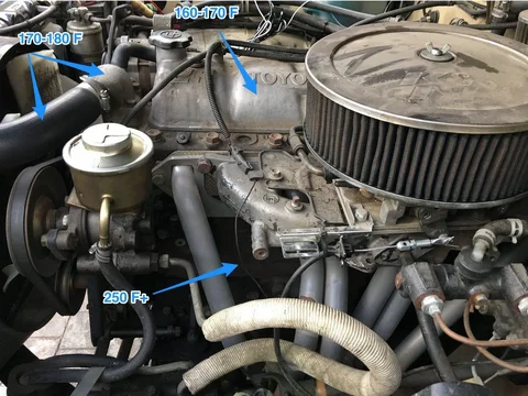

I picked up a IR gun off Amazon to run some checks.. No issues. Its running around 180. I even drove into the mountains to take a dip in the hotsprings and checked the temps after driving up hill for 2 hours.. All good.
I took temps at the thermostat housing, the return hose and just all around the engine. All in good ranges. (see picture attached)IMG_5165.webp However, right behind the headers the temperature was higher (around see 250) This to me seems normal as the headers are so hot that they are likely causing some residual heat on that portion. Is this thinking correct?

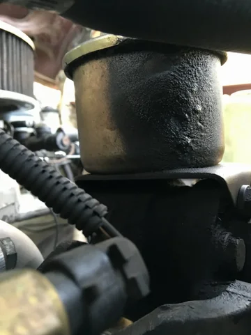

Also, I found some residue build up on the the power steering reservoir... Power steering pump leak? Or could it be something else? See picture..IMG_5141.webp
