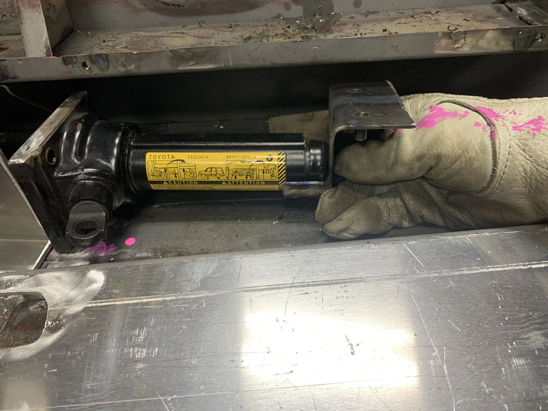

Made a jack mount.

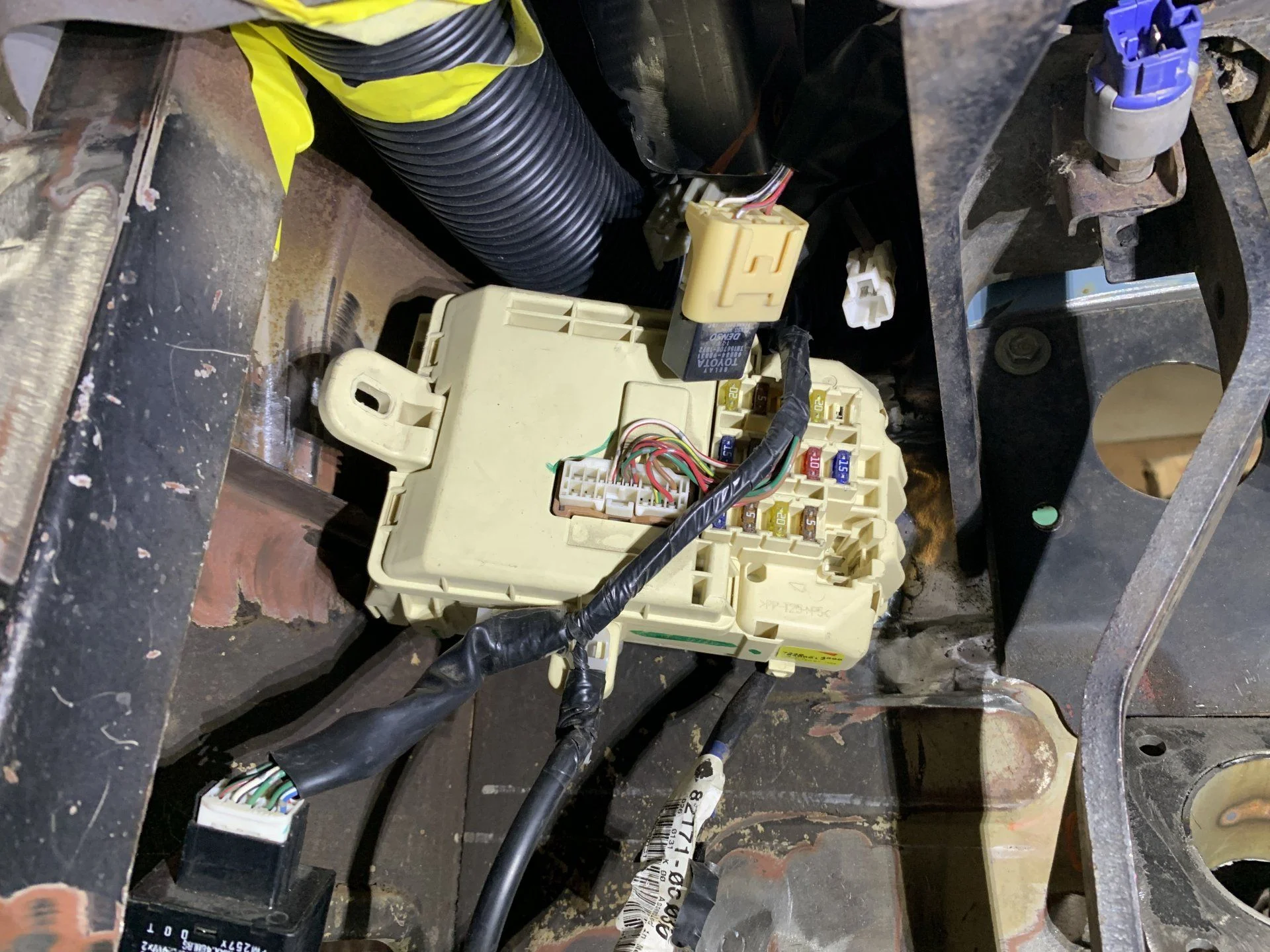

Pulled the wiring harness out to figure out how to mount the fuse block.
Bolt on collar! Genius!.. And now you have a removable steering column again! Firewall bearing come in yet?

Figured out a mount that would work for the original tundra ignition switch. And mounted the fuse box

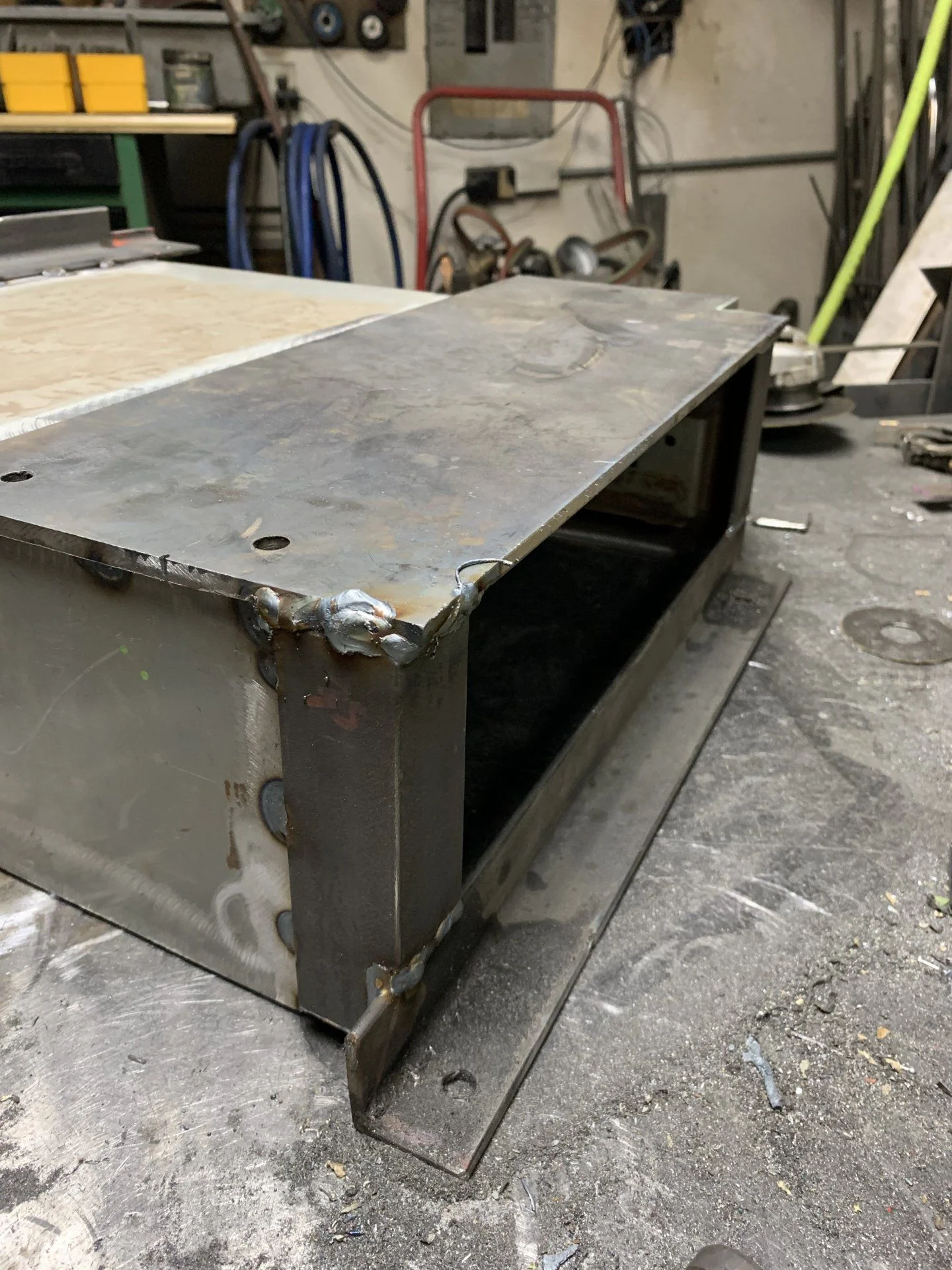

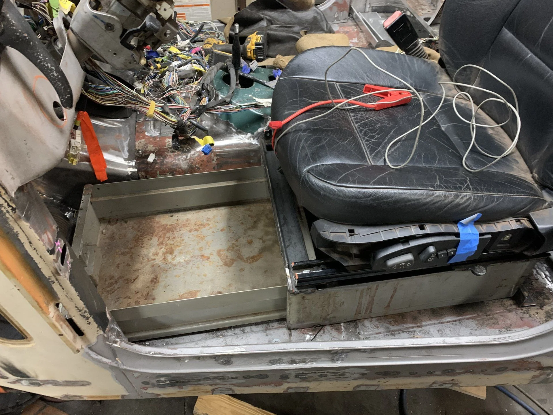

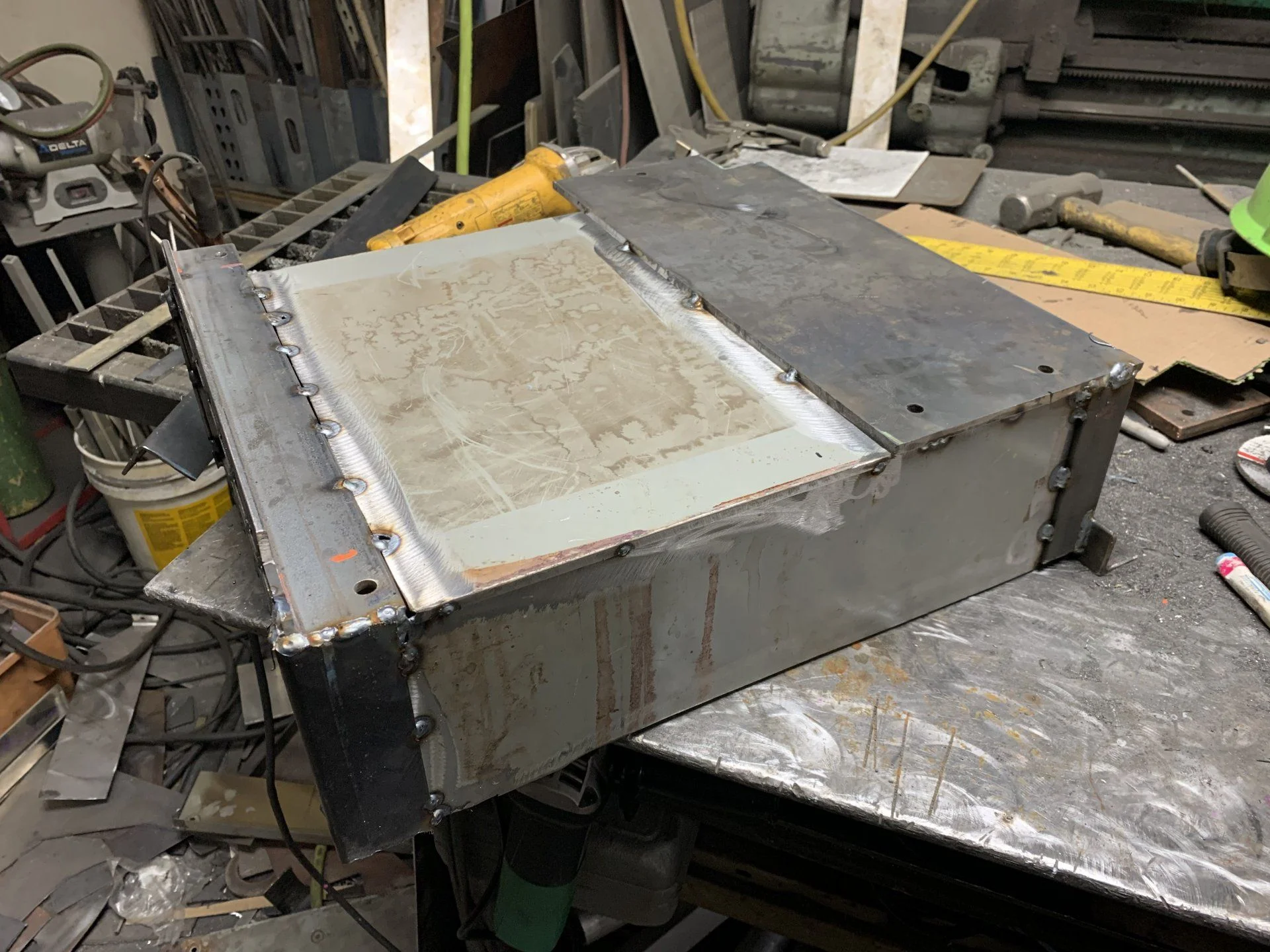

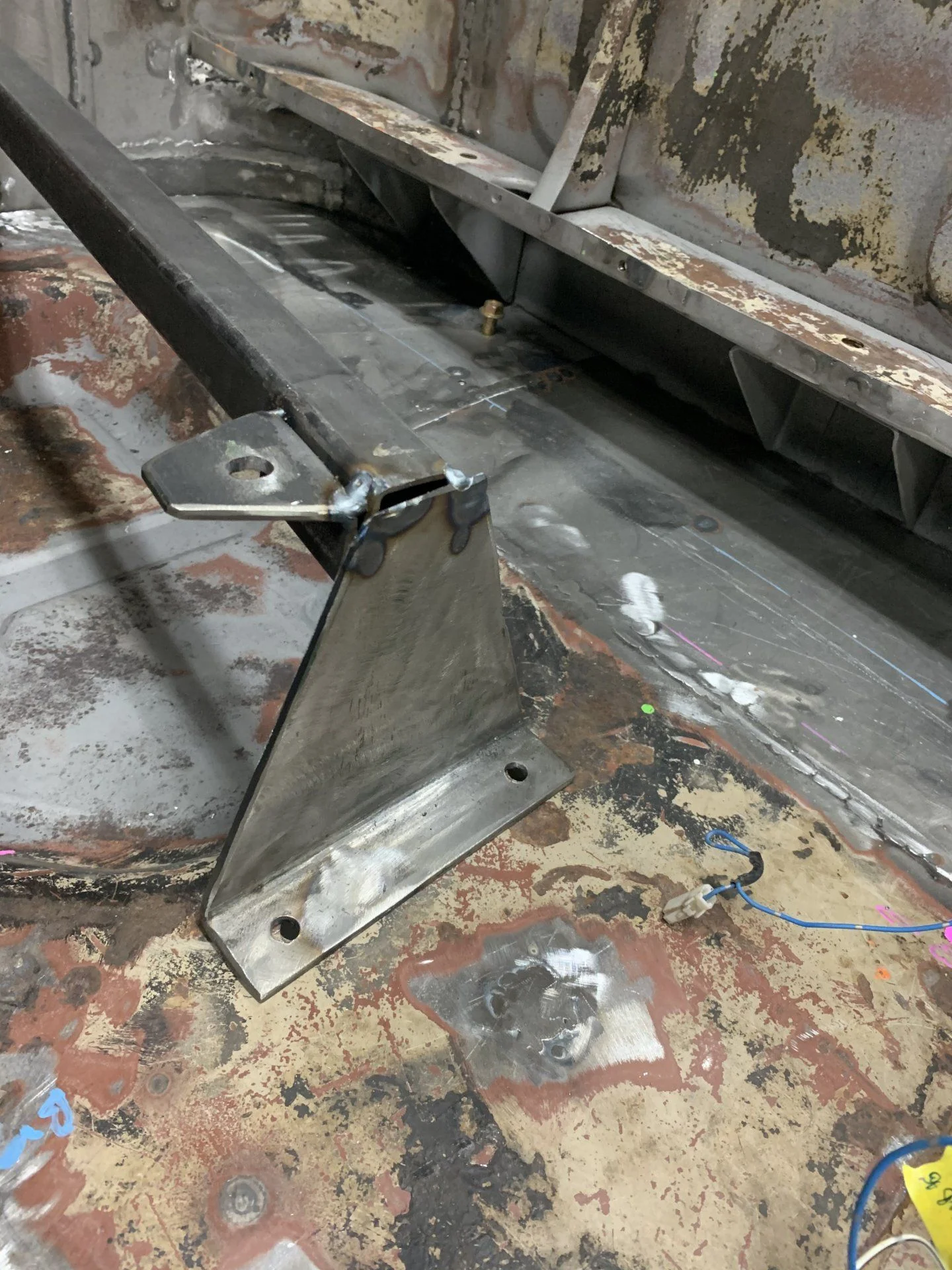

Spent a bunch of time working on the driver seat mount. After countless hours on the Internet trying to find an under seat storage box that used most of the 5 inch hide the space I went back to my scrap pile and found this... it was about three-quarter inch too tall so I chopped it all up and reinforced it so it’s strong enough to hold the seat. About four hours of time in it but it’s gonna work out great.
You weren't kidding when u said you reinforced it. Those seats were heavy before!
Passenger side seat mount done also!!

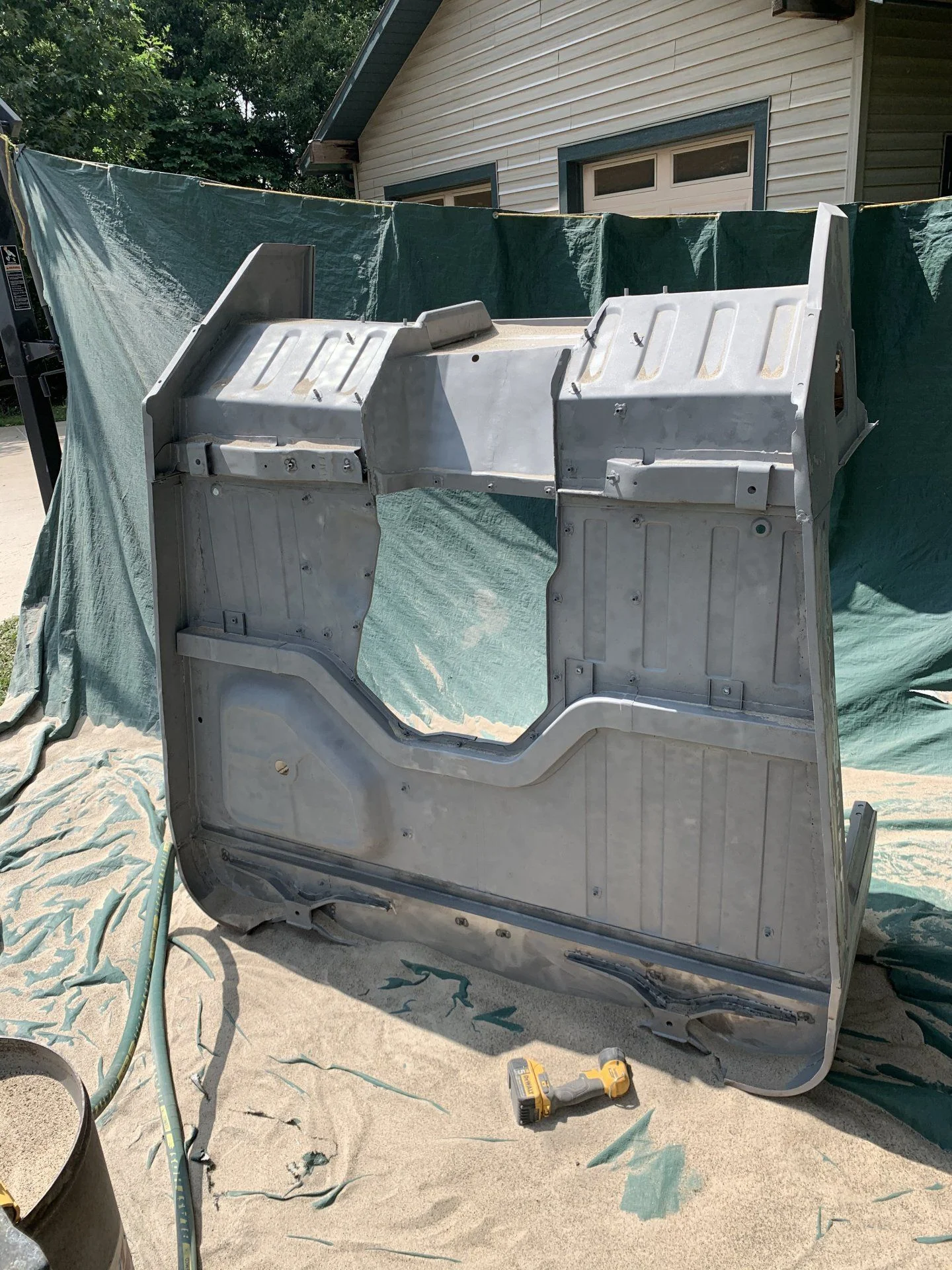

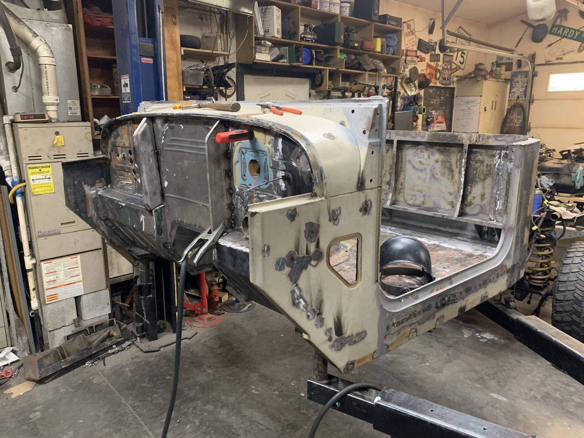

Then it was time to take the tub off and finish up all the welding and hopefully get the sand blasters quick!!!

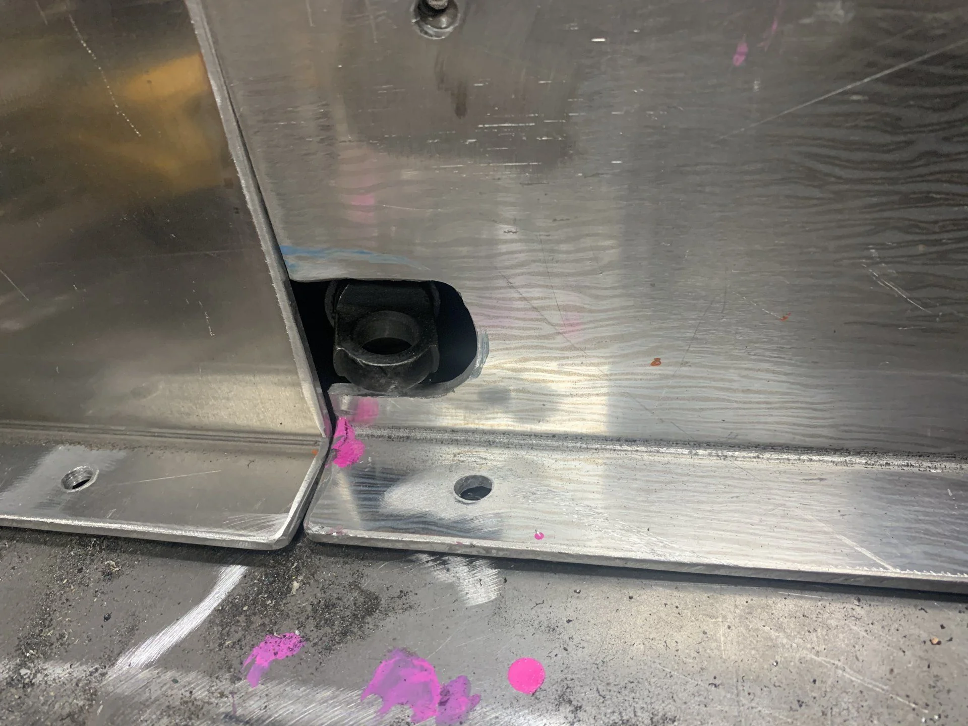

No pictures, but made great progress yesterday, welded the steering thing in final and got all the weld nuts done. I need to bend up some aluminum for the heat shields and figure out mounting points and then we should be ready for sandblasting...

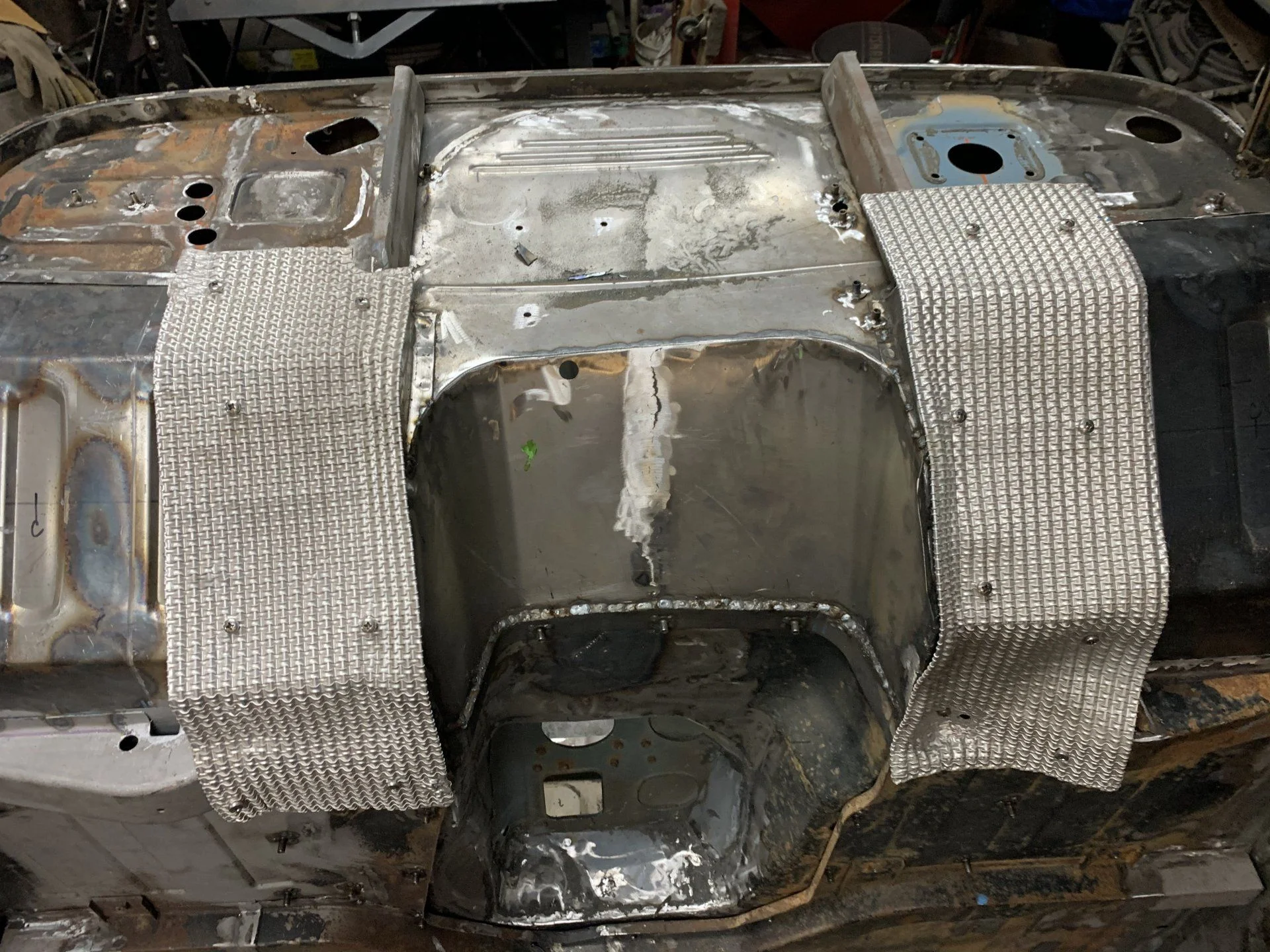

Heat shields cut bent and captured nuts and installed. this is some really neat stuff and it came off of a Toyota powered lotus... Thanks to @cjmoon !! Probably need another half sheet if you come across more!
Man I should have been thinking ahead. Recycled 10+ last year cleaning out the lotus shop. Kept what I thought was a life time supply. Damn, need to look in the storage might be more.
@cjmoon I'm game for some as well if you come across some more. I have something similar I'm using.

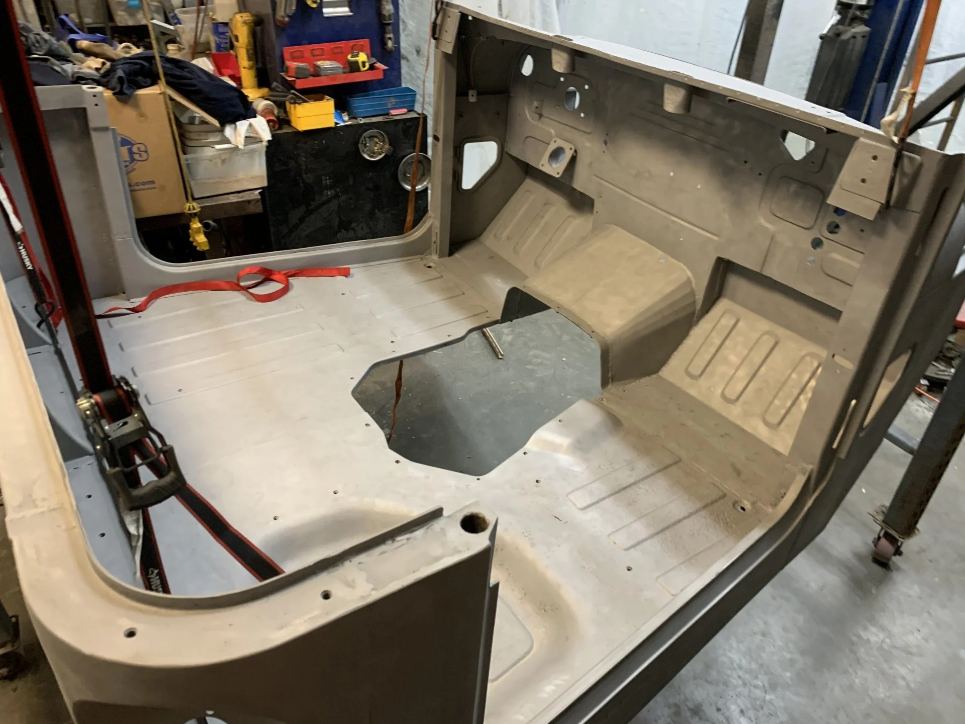

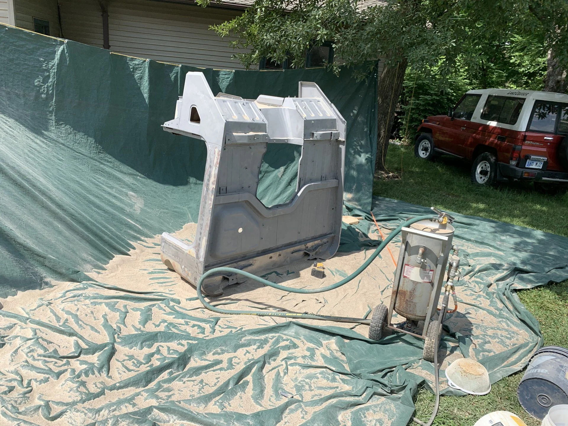

Had a blast on the 4th. Sandblast!!

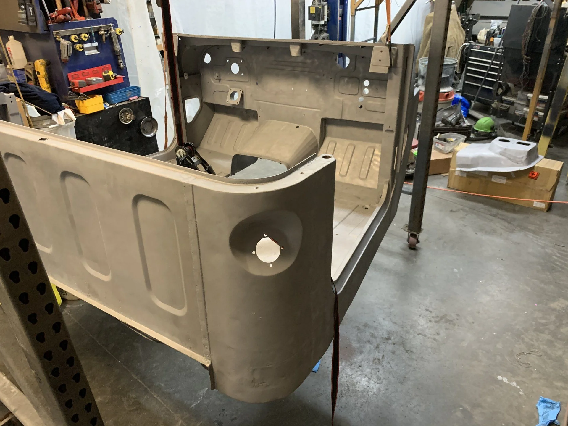

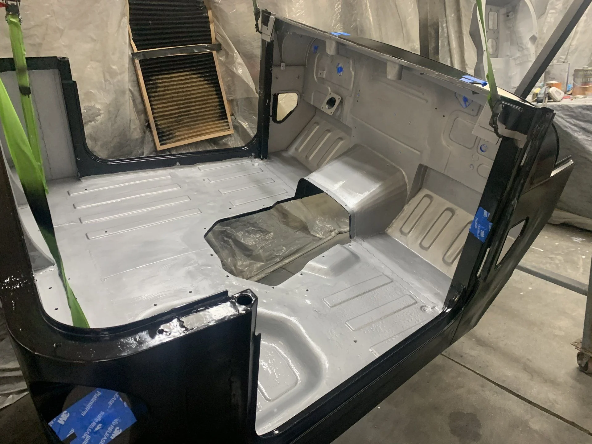

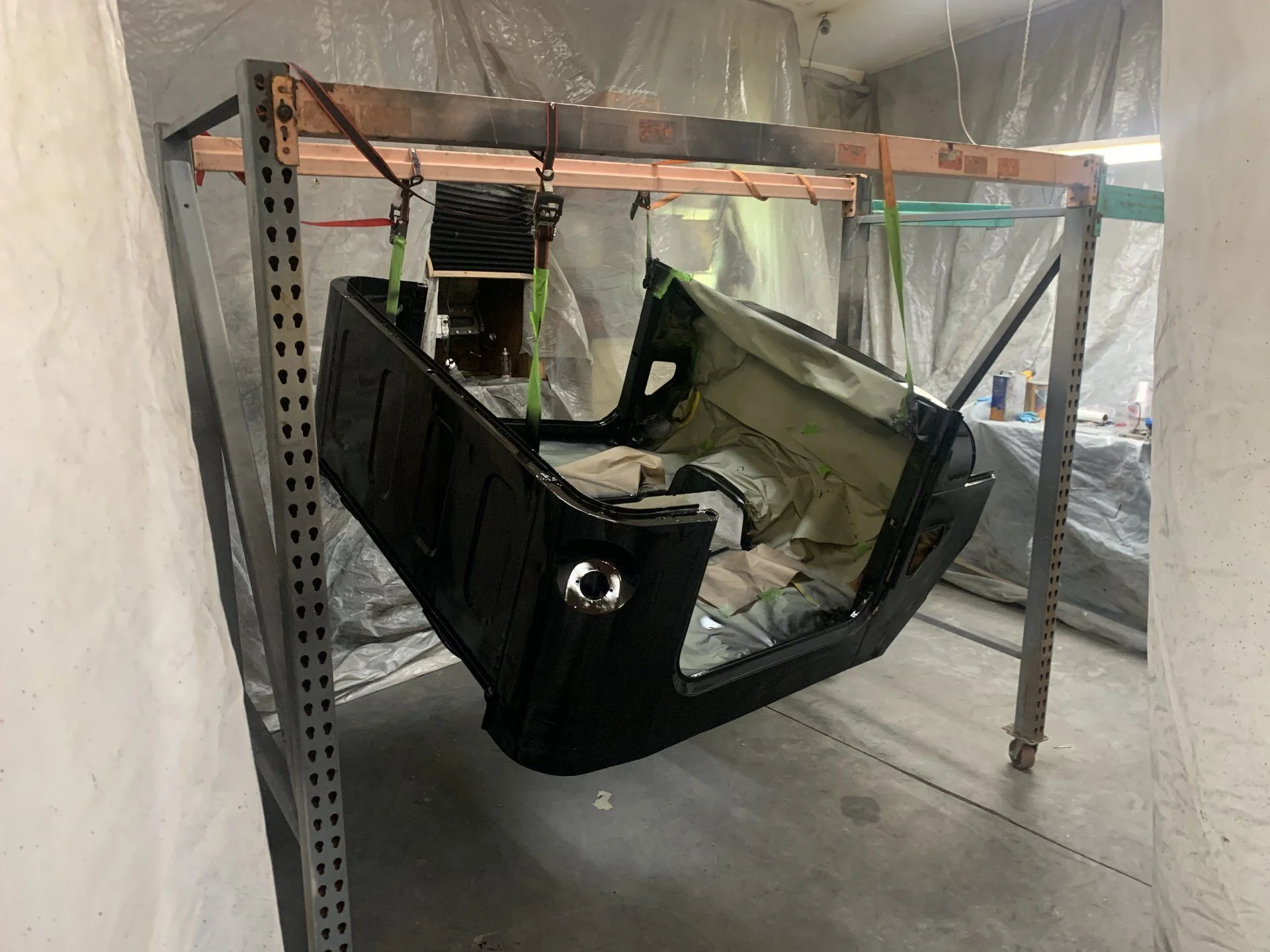

Epoxy Primer on exterior.
Master series. @c2dfj45 thanks for the advice
