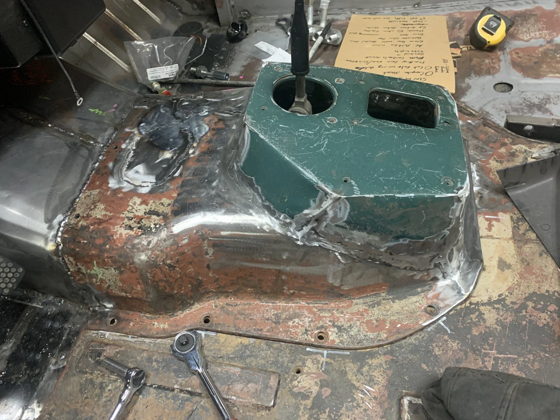

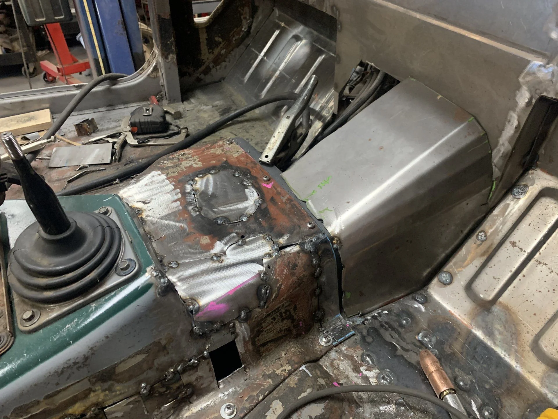

Snuck out for a little bit this morning.... Tranny tunnel progress.
Was able to sneak out for a little bit tonight and got the second side tacked in
Also take a look at before and after what I was able to do with the floor panel extension and widening

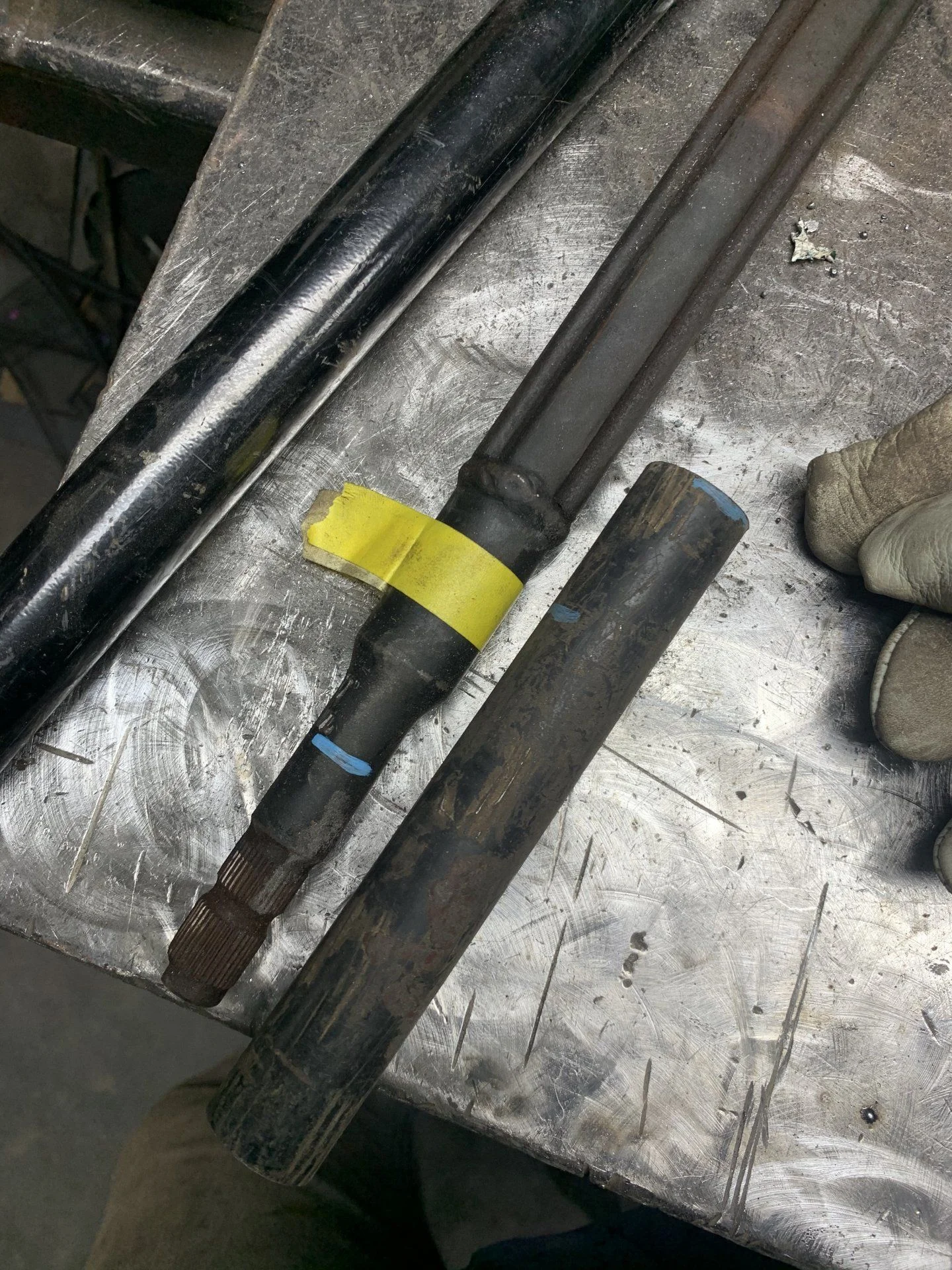

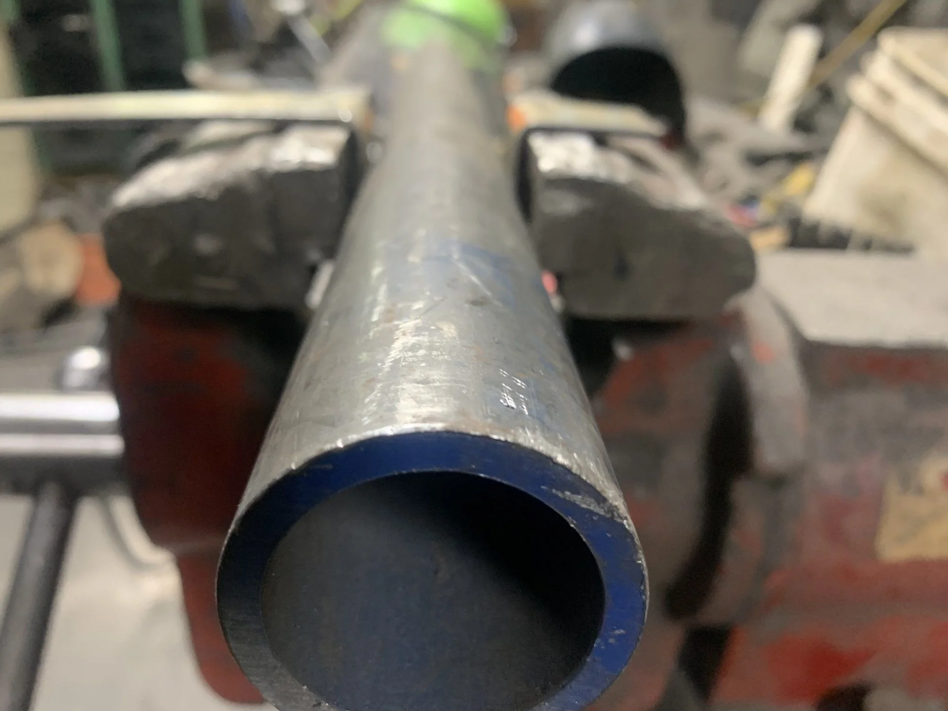

My 16 year old daughter and I Worked on new to her 4runner on Saturday. Had a great day doing the timing belt and all sorts of baselining ... but Sunday was able to roll vera back in and @tornadoalleycruiser stop by and help me through all sorts of questions... really amazing how many things we figured out and how long my list was when he left. Let’s start out with The steering column... we determined how much higher we could put it, so bent up a new column holder for the top, actually had to two of them because the first one was a little too big... then searched my parts Dash and found a shaft and u joints. Need to add about 5 inches and determined that an old tie rod from an 80 Series this is the exact correct ID Tubing
Here is how I bent, then made the angles on the new steering rod holder near dash.
The original in front, the final in middle and the big boy on the far side.
Steering column and the new section of tubing...
look familiar?? FOO donated this rod, after pretzeling it a couple times...

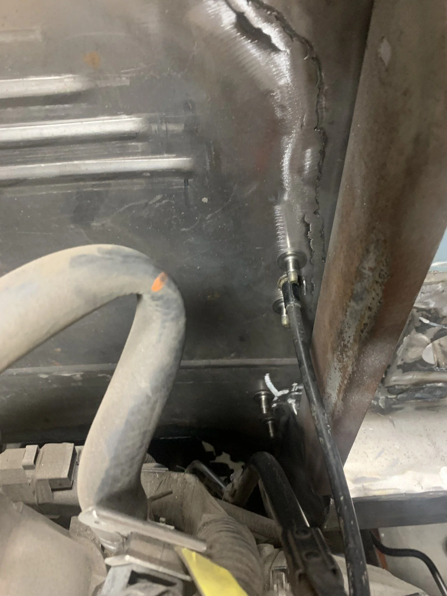

The Excelerator and cable Done.
Tranny tunnel welds all ground down, had to do some major heat shrinking to get rid of some deformed steel, but fits good now.

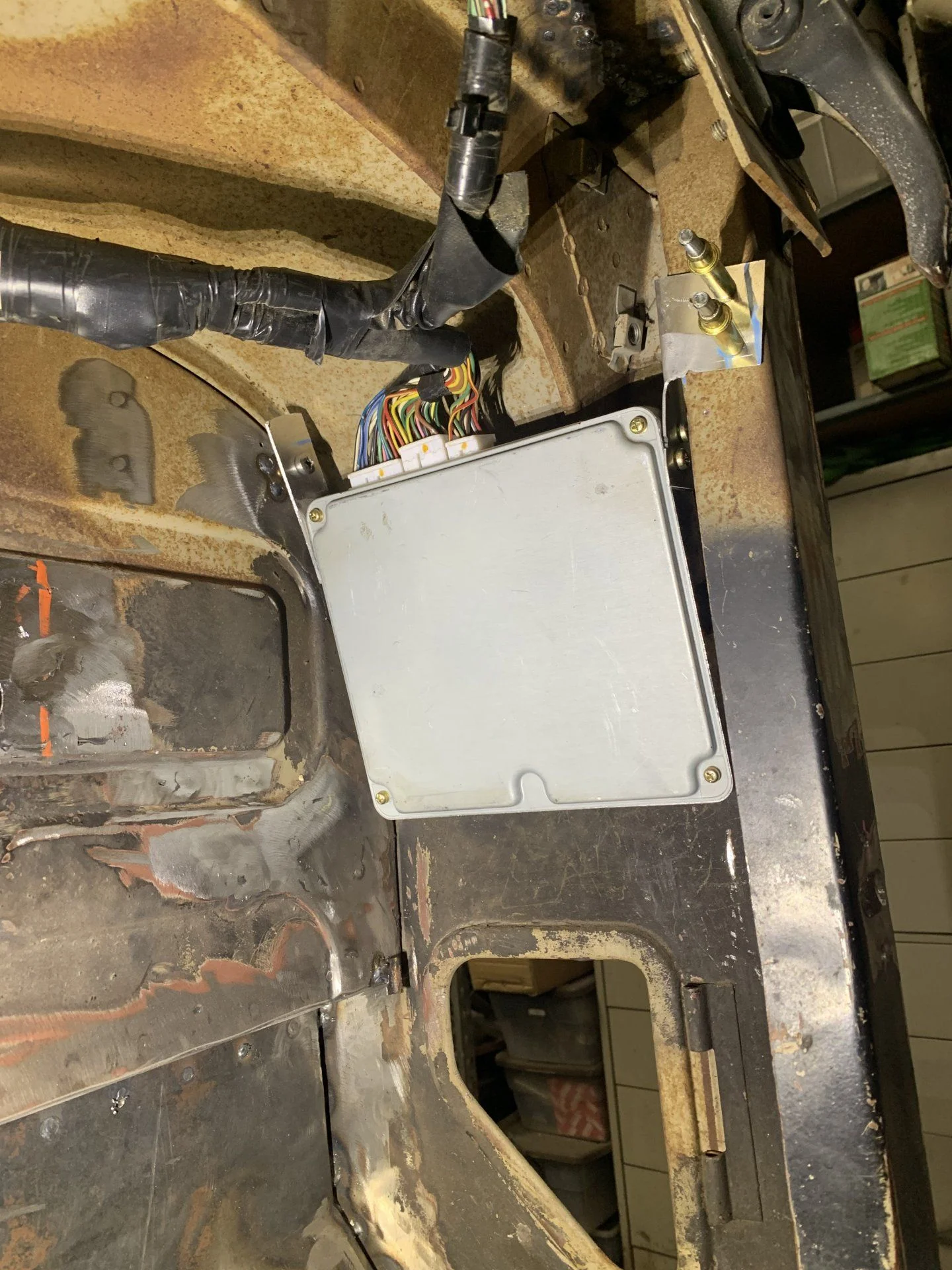

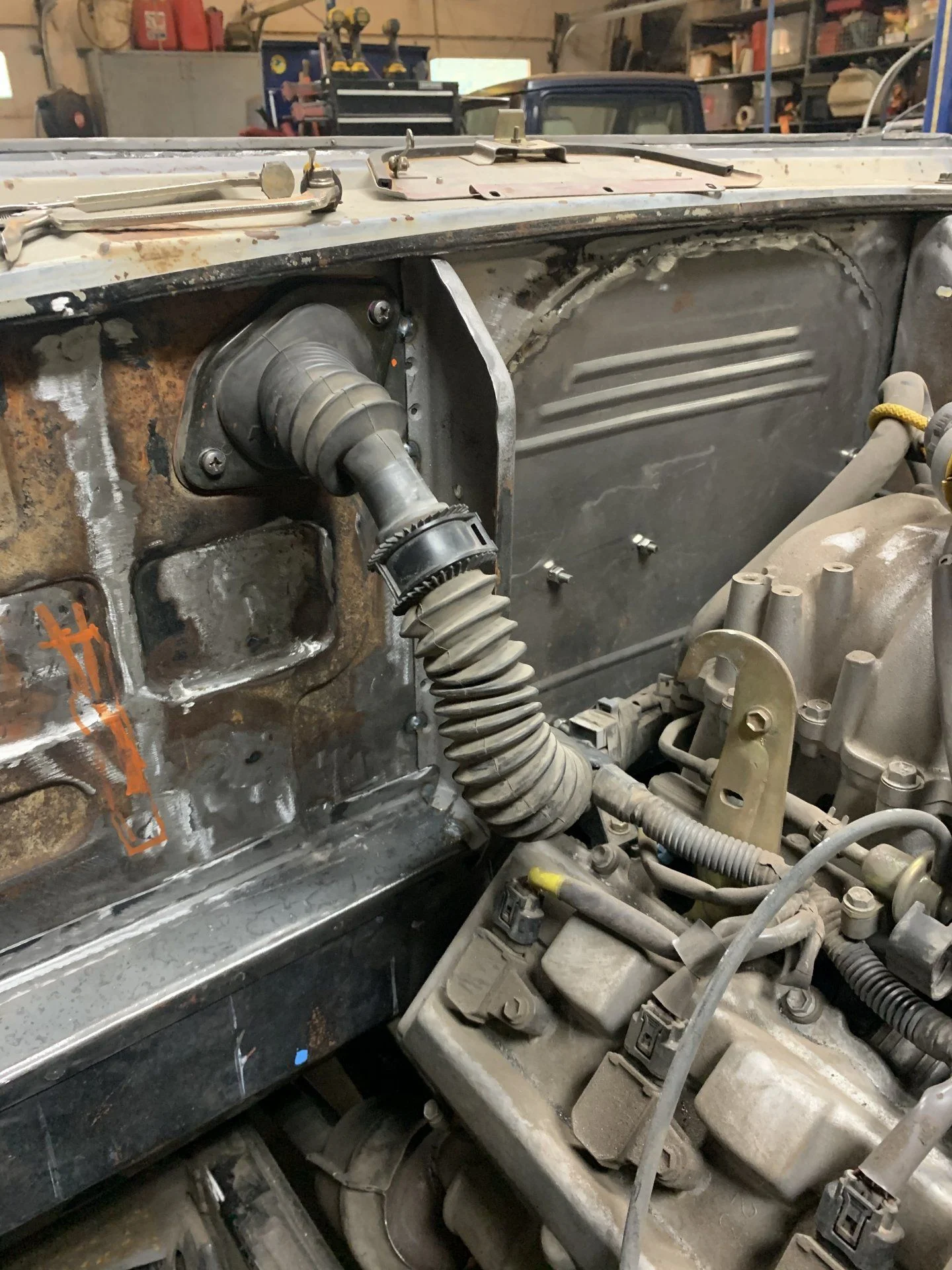

Progress. Got the engine wiring into the cab cut in.

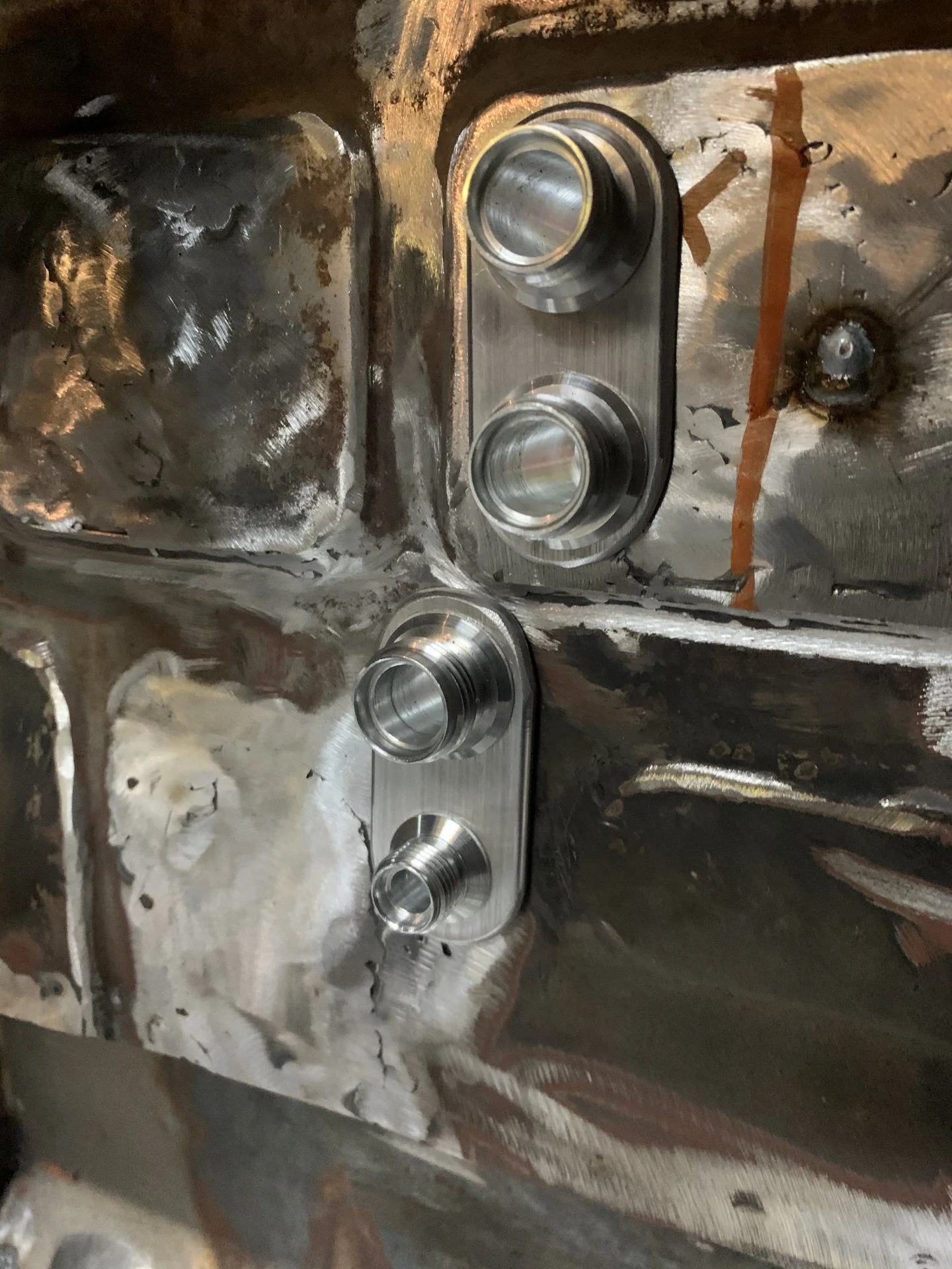

A/C and heat bulkheads cut in and I made a grommet for the engine side....
and got the computer mounted. The wiring harness is perfect length!!!! And I used my Kleco's for the first time.

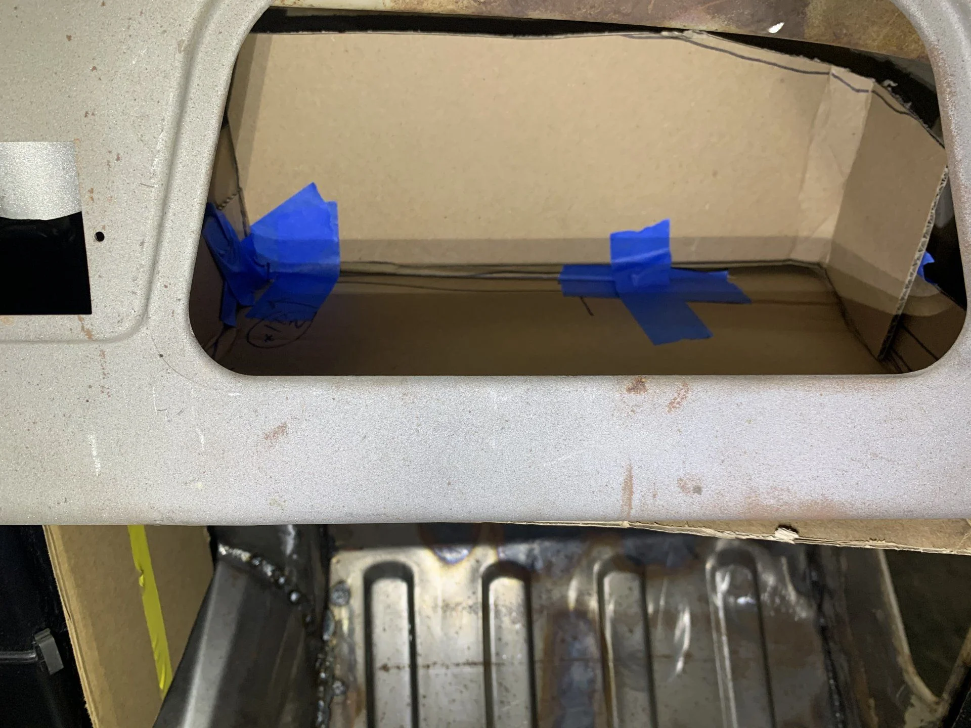

So if you recall this was originally a right hand drive truck, so it did not come with a glove box. Decided it would be nice to be able to unbolted it so
Made an aluminum tray. And also needed to leave room for the wiring harness and the AC lines as well as the heater a/c supply 2” hoses.

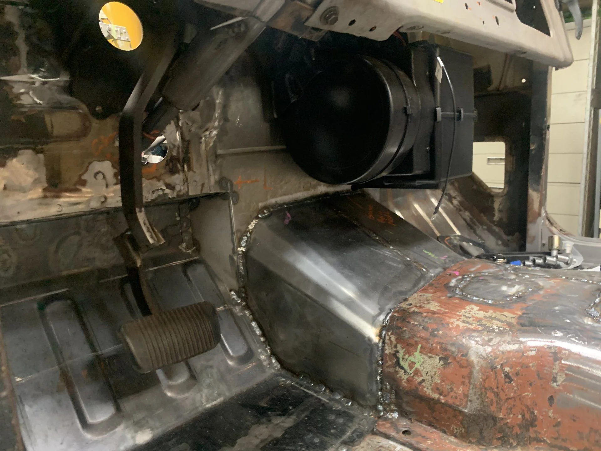

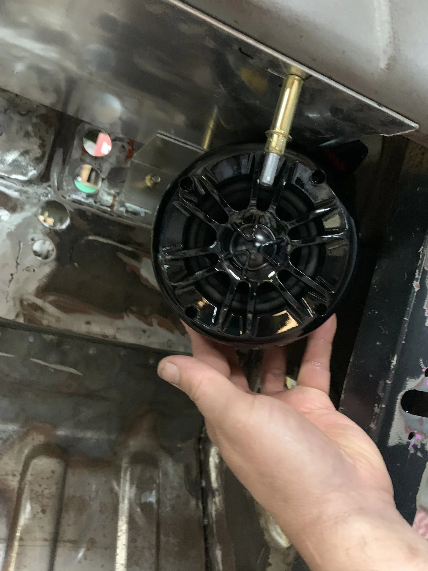

So I decided to buy some pods for under the dash and bought these as they were highly reviewed ... however I didn’t realize how big they were... They said they were 4 inch speakers so that’s what I was thinking...
Took one out and held them in place and they don’t seem too bad. Probably taking up less space than the factory air conditioner... Should be able to put them on little higher on the driver sid.
Got the speaker mounted on the passenger side and doesn’t create any issues with space.

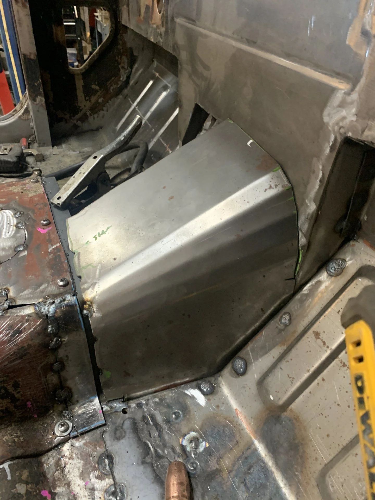

Then I got the filler panels for the rear made

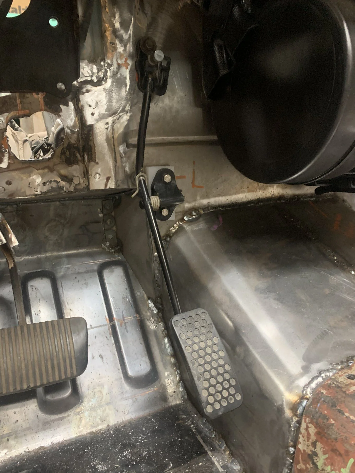

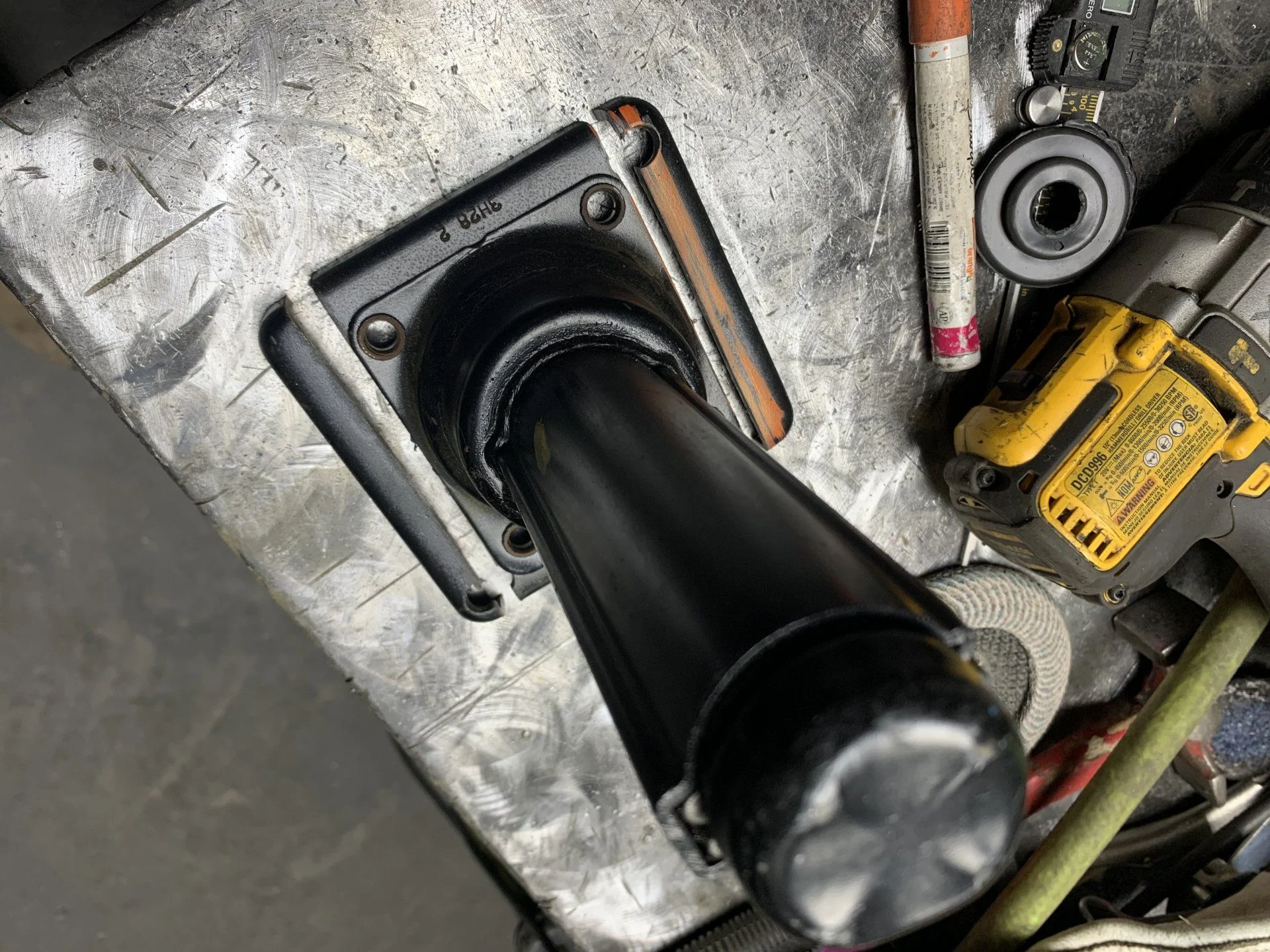

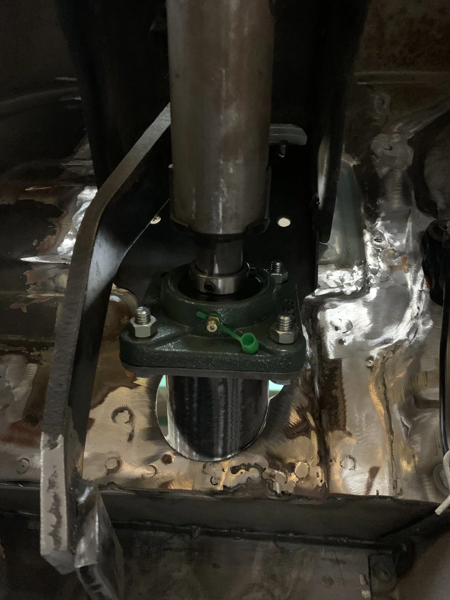

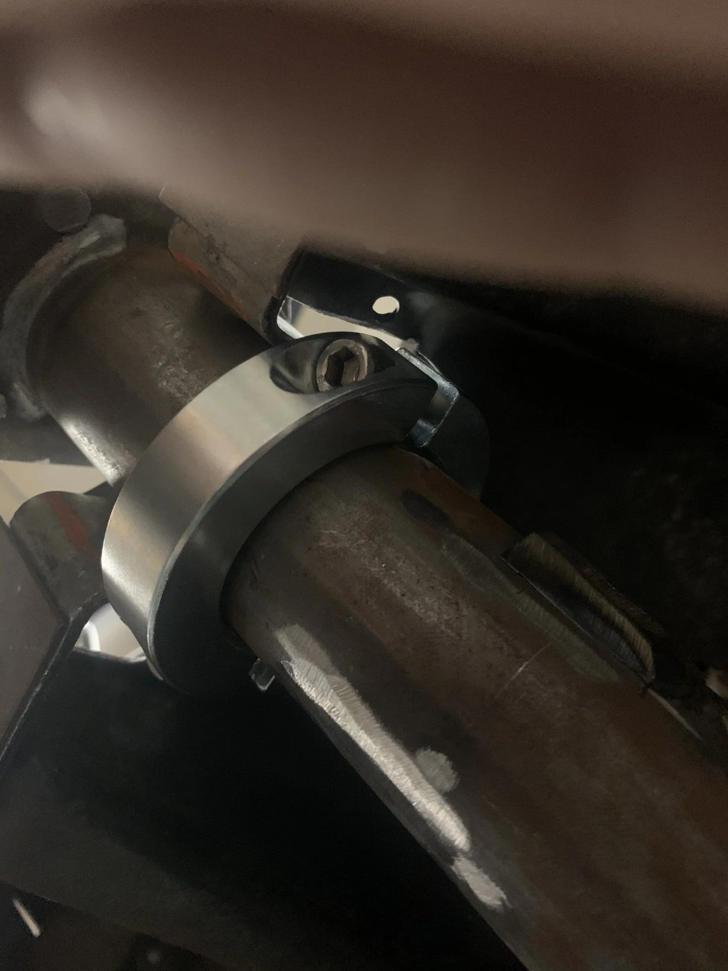

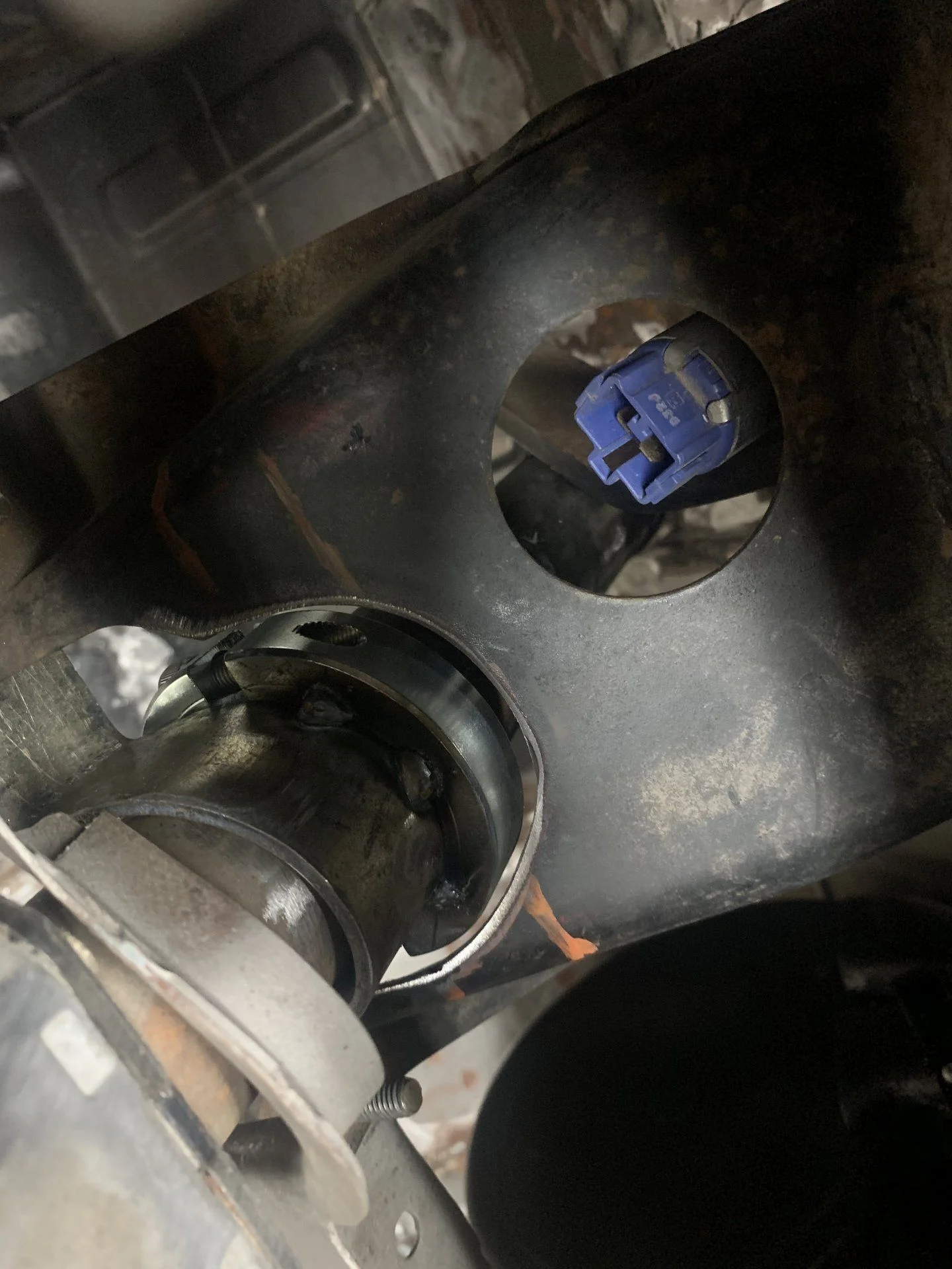

Installed the brake switch in the old 40 series housing and clearance the front edge so I could weld the bolt on collar
Bolt on collar! Genius!.. And now you have a removable steering column again! Firewall bearing come in yet?
yes... got the pillow block installed.
it took me a while to figure out how to make sure the steering wheel was straight I finally came up with this method.. measured the distance to the dash on both sides of the rule.

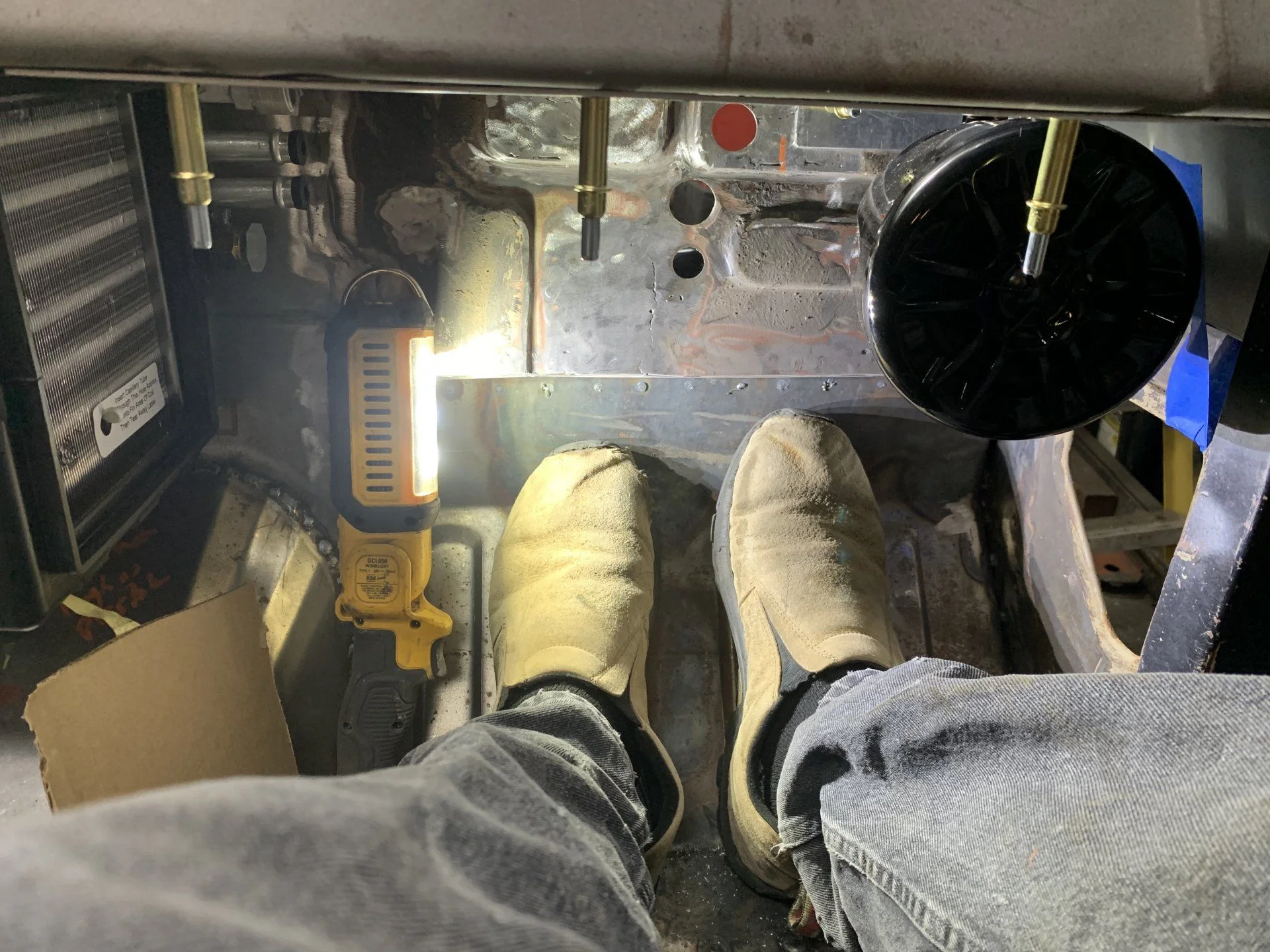

Clears the brake pedal with about 1/2 space... I might trim the pillow block some more; however, the pedal has no side to side play, so should be fine.

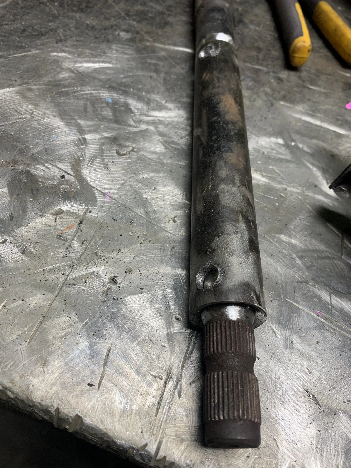

went ahead and lengthen the shaft as well

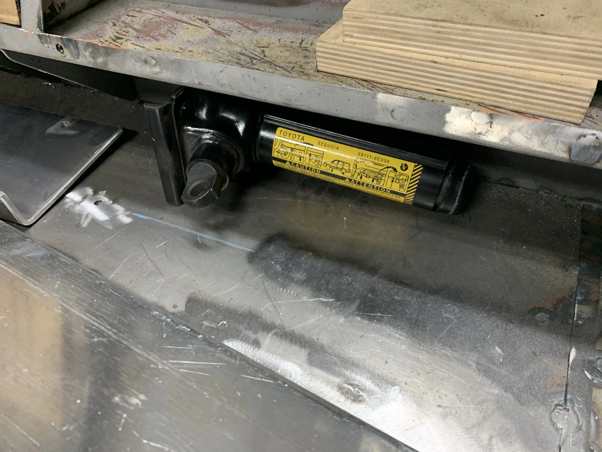

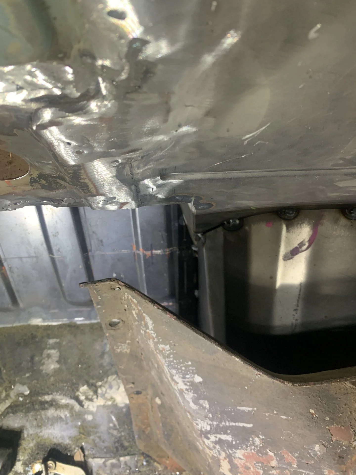

Was lucky enough to find a jack at the junkyard from a Sequoia. Unfortunately had to cut the base to fit where I wanted to hide....
