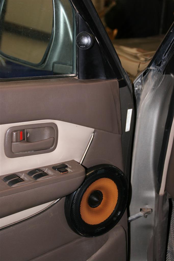

a pic of the Hertz component speakers I installed prior to the trip. good sound quality. good price. okay they were free as a gift from my friend for the trip but yeah good price for him too. they 'barely' fit. as in after one or two hard slams the grills now don't rub against the side of the dash.

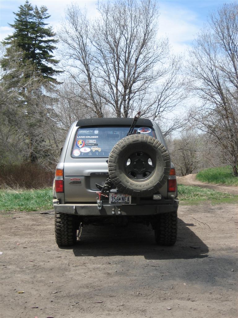

The bumper required lots of welding and grinding but still was very inexpesive and is pretty damn strong. I've beat on the bumper pretty hard and it has held up just fine. I've even used it for some very hard pulls getting a truck out of the snow 2 winters ago. It was weld designed. my welds have managed to hold up okay so far. you can see a good shot of it in the very first post.

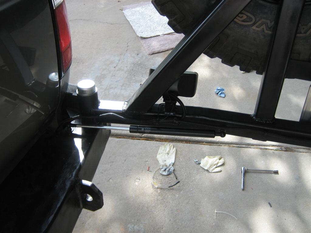

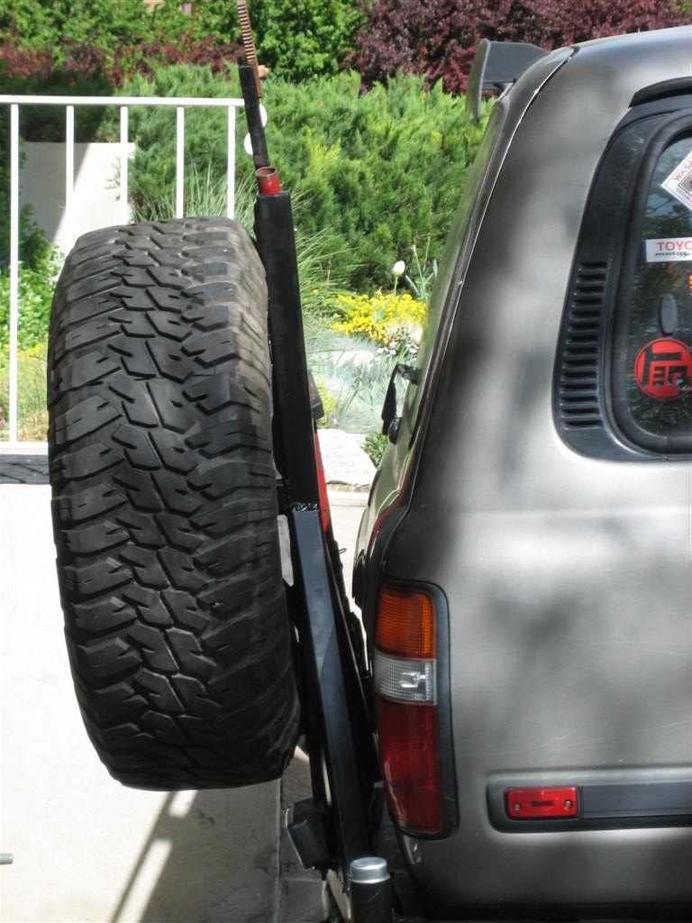

the swing out was my own concoction and i've been happy with it so far. here are a few pics...
the struts is off the hood of a rolled 80. or lift gate. i forget which one. but they are 80 OEM:cool:

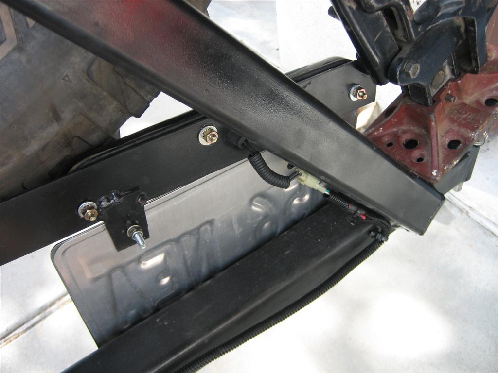

I managed to use the stock light off the tailgate for the license plate...
a profile shot...
and one with a little mud on it...
For the trip I added my 'pullpal' minus the shovel portion. with the Toyo, hi-lift, and pullpal it is very heavy and as such Eric asks the question. 'how is the swing out holding up?' I think the bearings in the spindle are getting worn and that is where the slop is coming from. I stopped by a trailer shop in El Cajon, CA and the owner donated some bearings and welding rod to my trip. Really cool guy and I just stumbled across him randomly. worked out very well for me. The bearing are sitting nicely packed with grease in a zip-lock bag waiting for the time and second set of hands to swap the bearing outs. in the mean time I have been running with a ratchet strap from the top of the hi-lift to a loop on the roof rack to stablize the swingout on the rough roads.

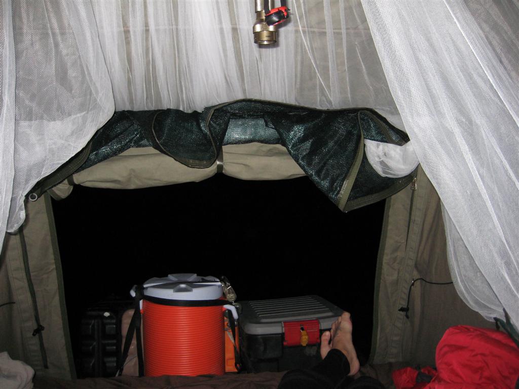

Eezi Awn 1400 Rooftop Tent
I'll be very honest. This was a challenge. I have camped hundreds of nights in my life and I never owned/used a tent until March of this year in Baja due to the hundreds of spiders on the beach. that was a borrowed backpacking tent. to go from a blue tarp and a sleeping bag to the luxury of the Eezi-Awn was quite the transition. Honestly it is one I'm still getting used to. The comfort, (i roll with sheets, 2 pillows and a down comforter) the security of not being away from the vehicle and the nice dry place to escape the element during the week long rain in Costa Rica is something I could easily grow to love. I have not camped as much as I would have liked but the deserts of Chile, Arg and Bolivia await and the tent will get far more use. one of the largest benefits has been protection from the bugs. to be frank there are some nights it's been so damn hot I've basically slept stripped to the skivvies on top of all my bedding and still managed to sweat all night long. I added a second layer of permethrin treated netting to the tent and so far the bugs have been a non-issue at night. a pic...
so rooftop tents may be a fetish for the expedition crowd but I have become a believer. I just wish I was about 4 inches taller. It would be far easier to open and close if I wasn't 5'7' with a 8'6" tall truck. But I'll blame that on my genetics not the tent.
