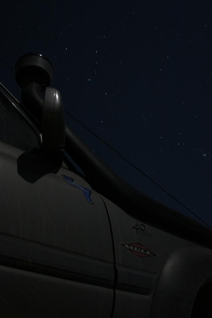

by moonlight in baja...

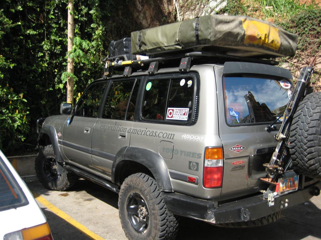

and in the hotel parking lot in Panama City just hours before putting her in a container. At the demands of the shipping compnay I paid $7 to have nine countries worth of mud washed off by hand. she sure looks pretty...

sweet ride. love the pics and how the rig is being used.

Amazing moonlight pic
The secont pic ismy desktop background:cheers:

dmc- amazing rig but I have a slightly off-topic question: what kind of camera did you use for that moonlight shot? It looks surprisingly free of noise and I would guess that's either film, DSLR, or some kind of Fuji Finepix with the SuperCCD?
the camera is a Canon 20d. lens is a tamron 18 - 200 dII. Here are a few more pics from the same night. it wasn't even a full moon that night. just very clear.
