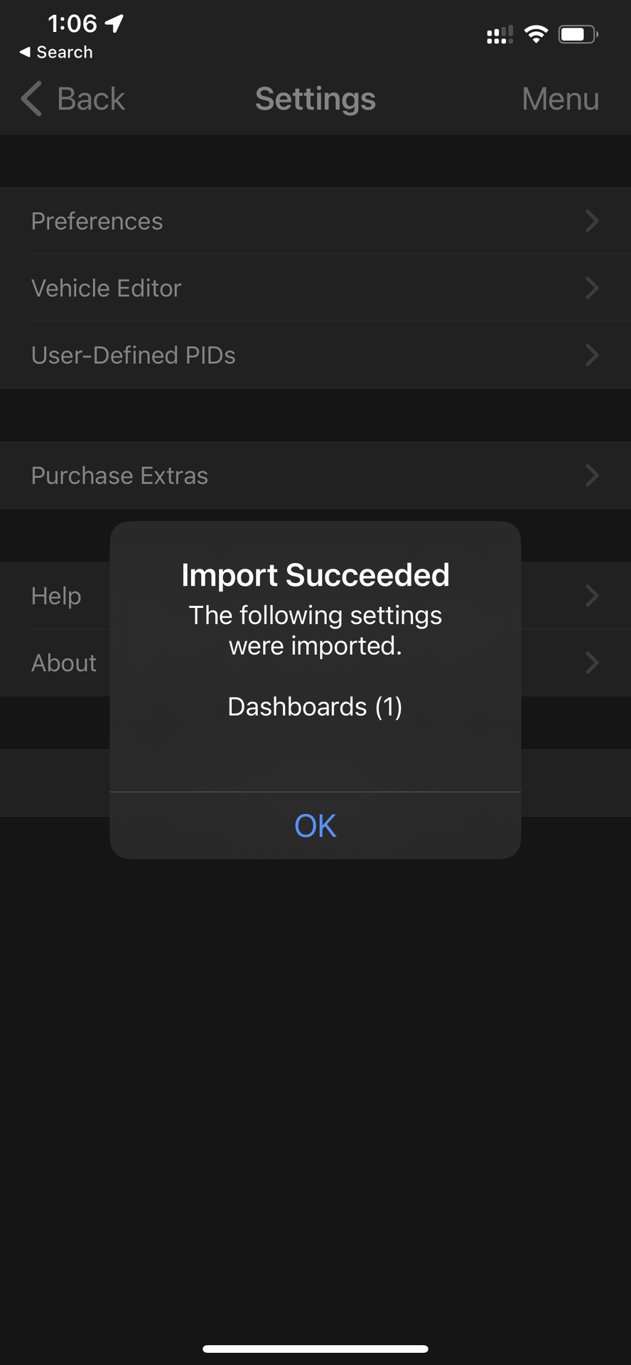

So the “success” screen can be misleading. This is what it should look like when it happens right. Notice it says “Dashboards(1)”… meaning one dashboard imported.
That makes sense. My success screen is blank.
I started to make my own dashboard but quickly realized I’m far too obsessive to actually finish in my lifetime. Hoping someone knows what I’m doing wrong.
I’m having the same problem when I try to import from both Dropbox and iCloud. Has anyone else seen this and figured out how to solve it?
So you have to go to “Settings -> Preferences -> General” and enable the “Use Simple dashboard management” toggle.
Then you have to import the dashboard (I would only enable the dashboard toggle in that screen, but may not matter. After those changes when you hit the import button, you should get a screen that says “Dashboards [1]”, if it only says succeeded, then it didn’t work.
After that it may be necessary to link the dashboard to your vehicle. If the dashboard isn’t immediately displayed after you get the above message, you need to do a “manage dashboards” from the menu button on the dashboards page. Then use the + button and you need to link the dashboard to your vehicle.
@lx200inAR already answered my question 7 pages ago. This is exactly what I was doing wrong. The setting makes no sense, but just enable it and move on.
Too bad i couldn't remember that yesterday.
