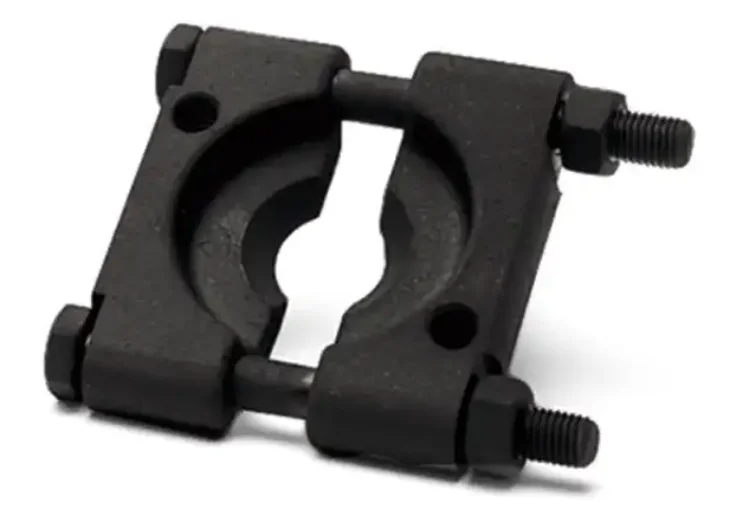

3) Separate inner CV - this takes some good force. With the pry I had, I couldn't get the right leverage against the carrier lip, and without confidence I wouldn't damage it. Used a large bearing separator plate in the gap around the axle and against the carrier, as a flat solid protected surface to pry against. Made quick work once I had that.
What large bearing separator plate did you use?
I have an old one that looks like this. I imagine any one could work. Put it behind the CV to have a flat surface to pry against.
