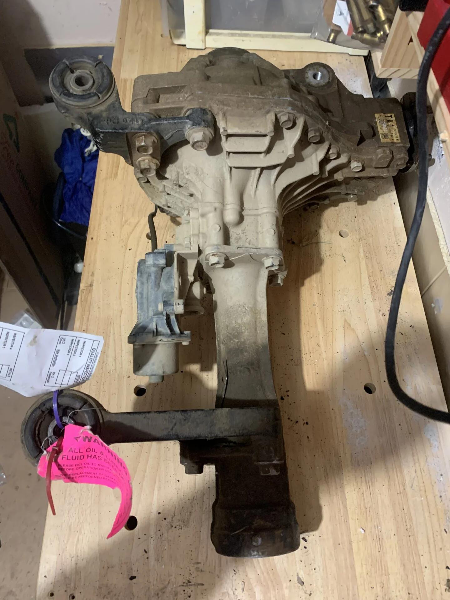

Would anyone happen to know if this 4.10 geared front diff from a 2011 tundra will swap into my 2011 lx570 (with the appropriate modifications mentioned by teckis300)?
The front diff will work. I put a 2010 sequoia diff in my 08. Easy swap. I'm at 260k miles, still running strong and smooth.
Yup, will drop right in with same procedure I documented earlier in this thread. Change for the LX mounts and extension tube. May need to address the roller bearing.
I used a carrier out of a 2014 tundra with 3.91 gears. The roller bearings were the same ID as the 2017 carrier that came out. I left them in there.
