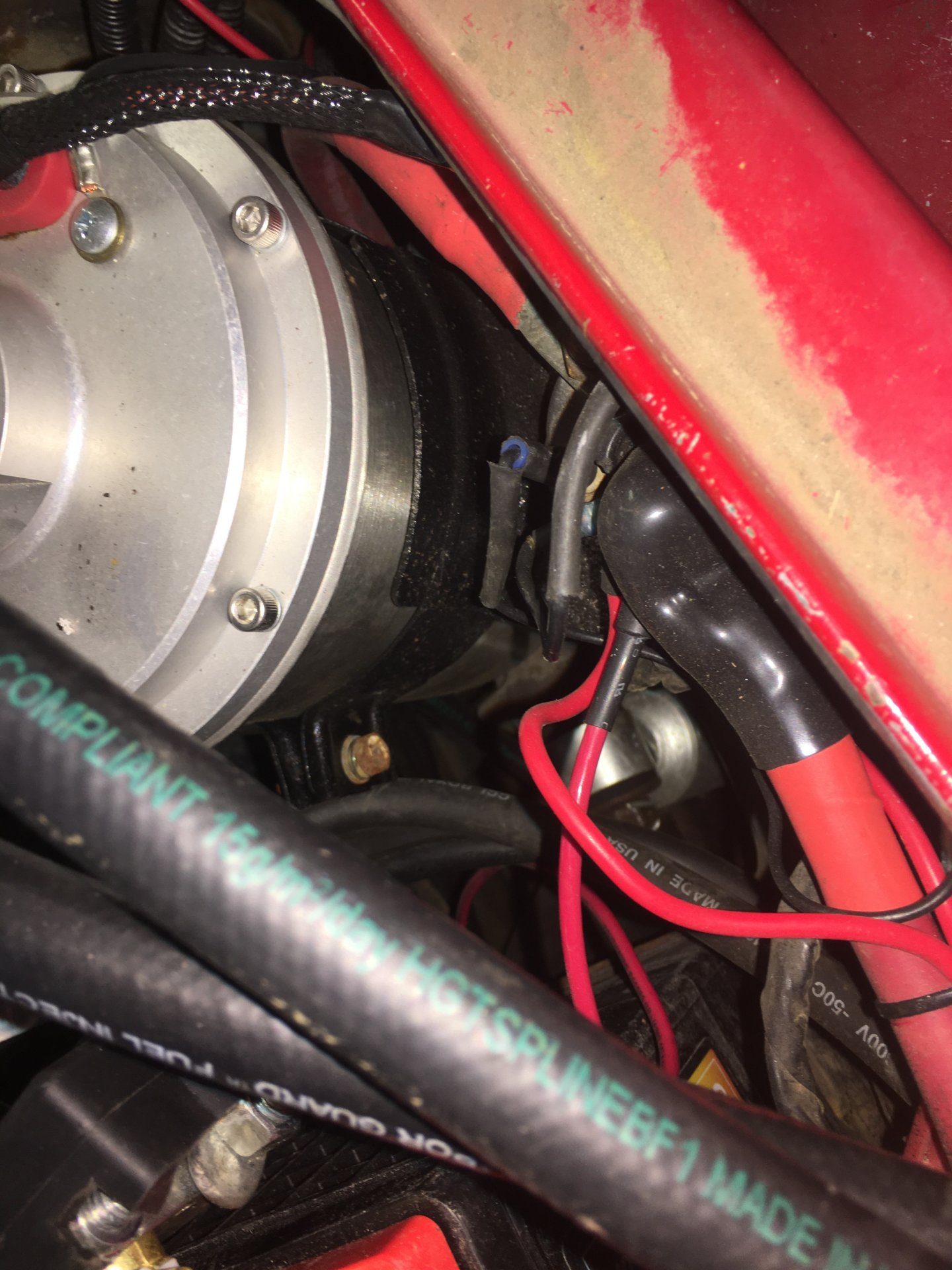

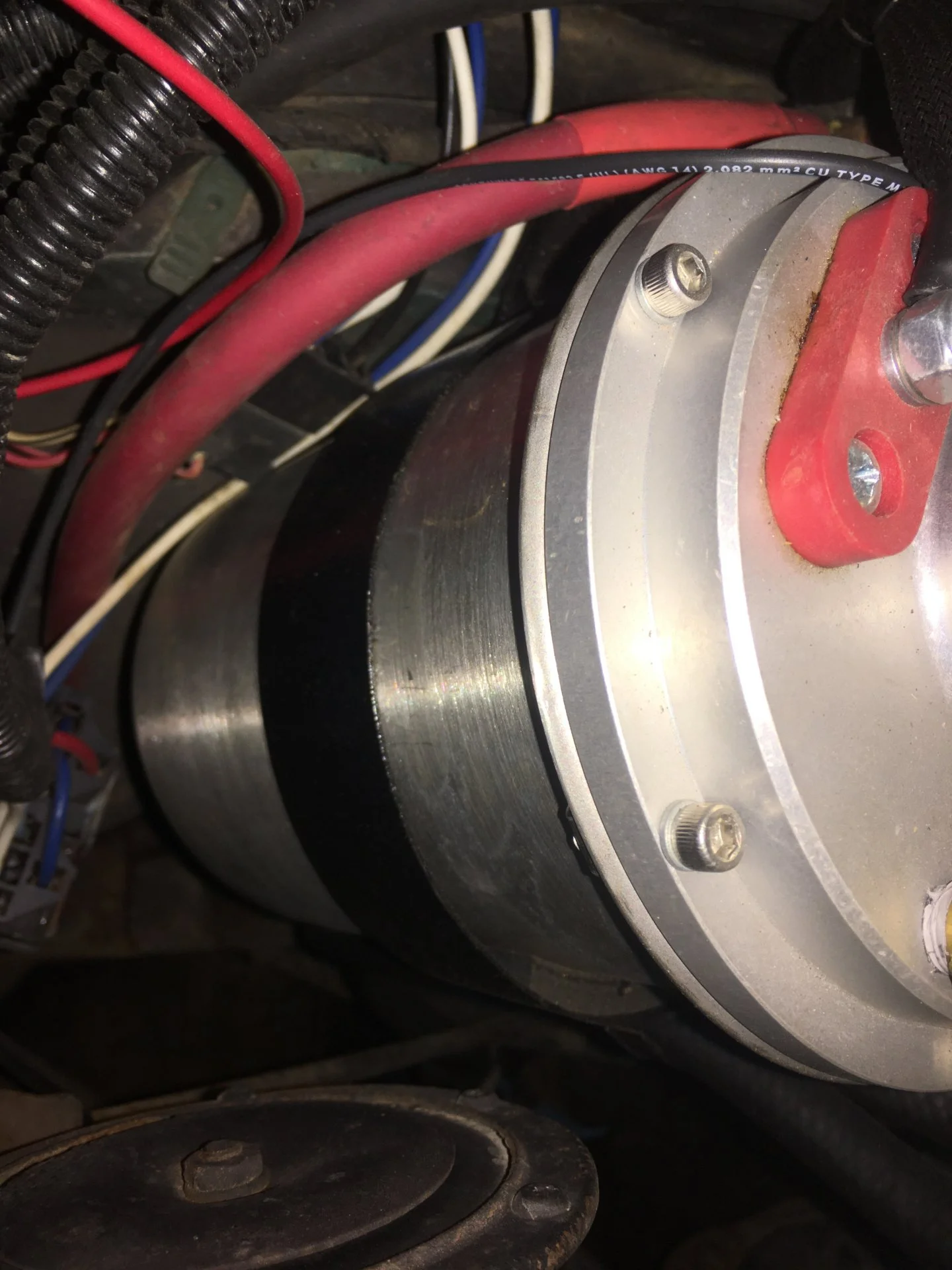

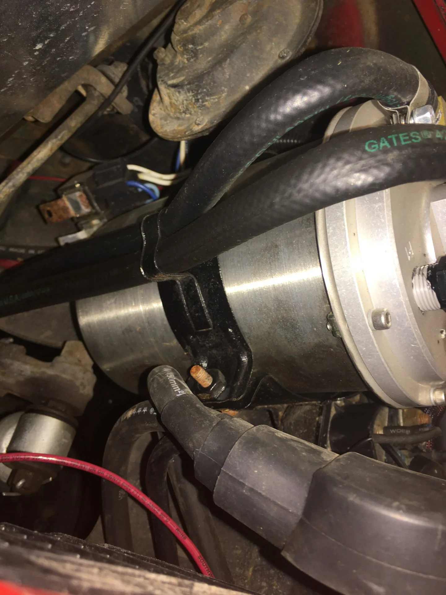

Can you show how you mounted your power surge? Is this the factory overflow mount repurposed? Any pics would be awesome.

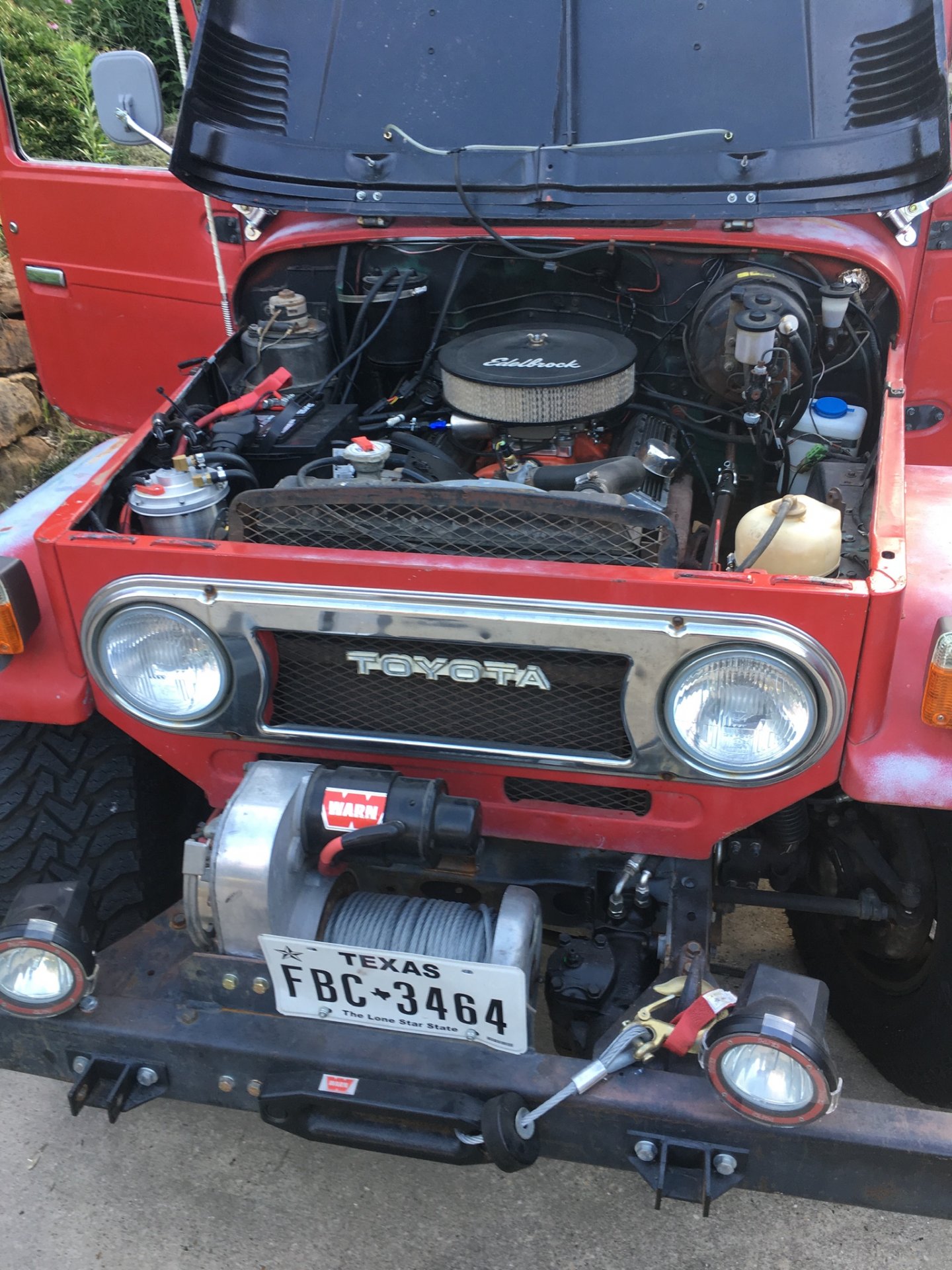

Let me get some photos this week - here is the only one I had handy - I did move the overflow to the drivers side.

Thanks. I measured it tonight. It looks like it is about 1 CM larger in diameter than the stock tank.
do you remember running a longer boot to reach around the power surge fully?

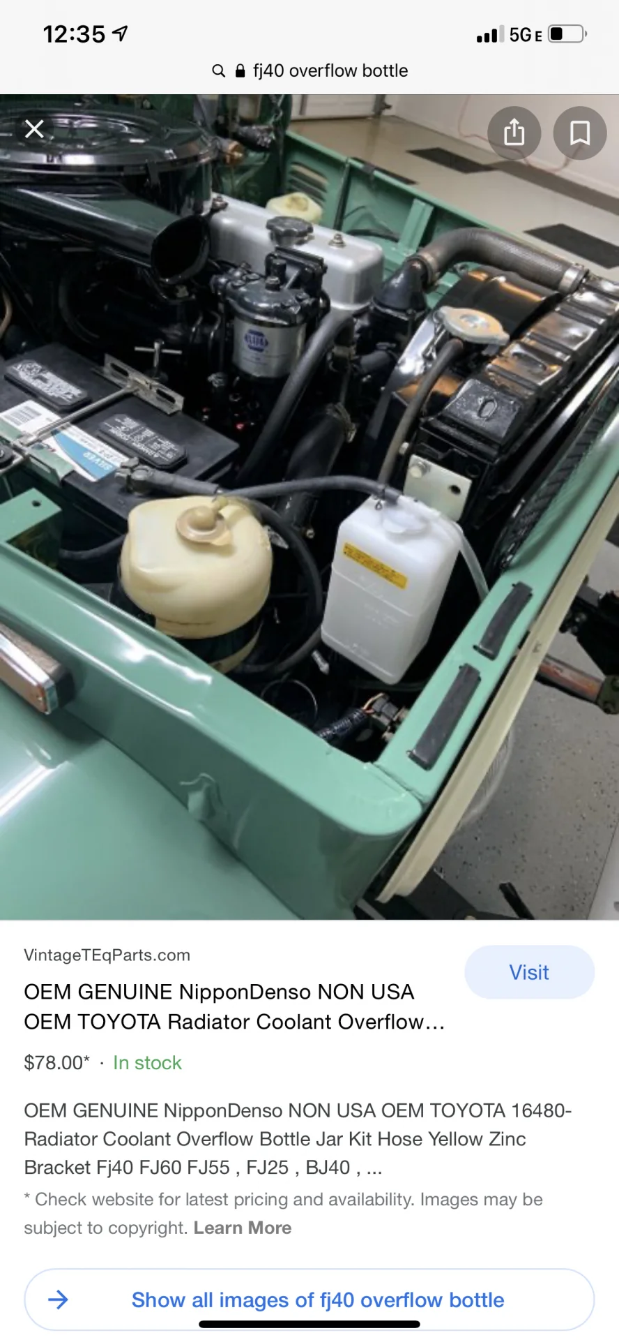

I bought a Non US spec overflow that I am going to mount on the radiator mount. The should workout great. All due to finding your picture on google images! Being in a high rise makes it much more difficult to fabricate anything. I have no where to cut grind and paint anymore, so this solution works out great!

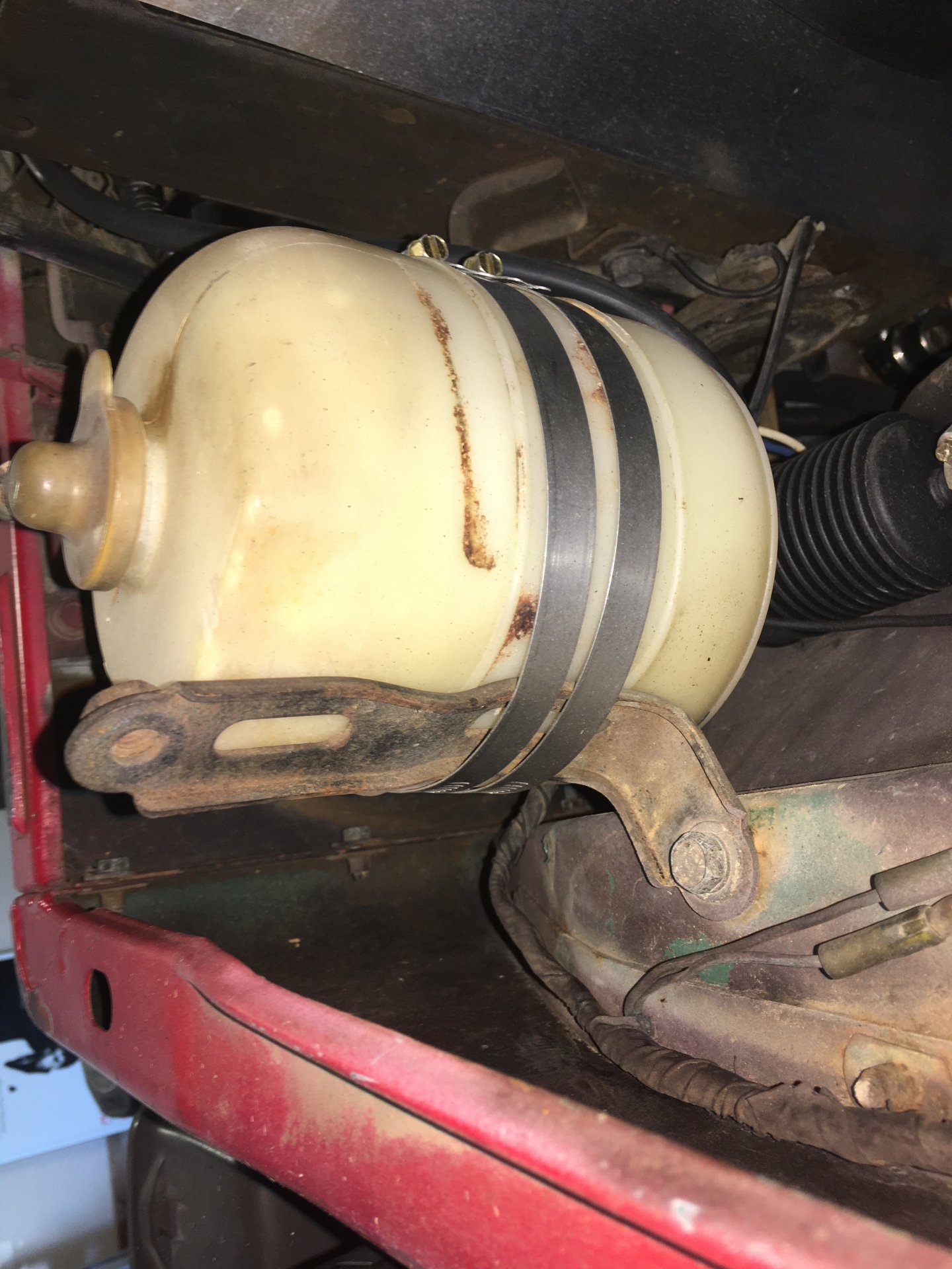

I had completely forgot about pics - it’s been a while since I did this but my surge tank fit in the overflow bracket almost perfectly. I did add a piece of rubber between the tank and bracket to take up some slack.
I moved the stock overflow to the drivers side and kludged up a bracket using some worm clamps. It’s still a work in progress but the last year has just kept me sidetracked.
