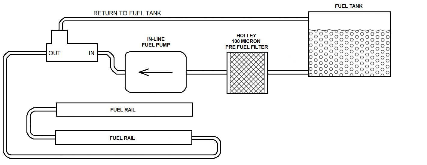

Another option for surge tank - this is what I run with my FI tech - same as your sketch - low pressure pump keeps surge full of fuel with a return back to main tank.
High pressure loop to and from efi and tank. I can get a picture later.

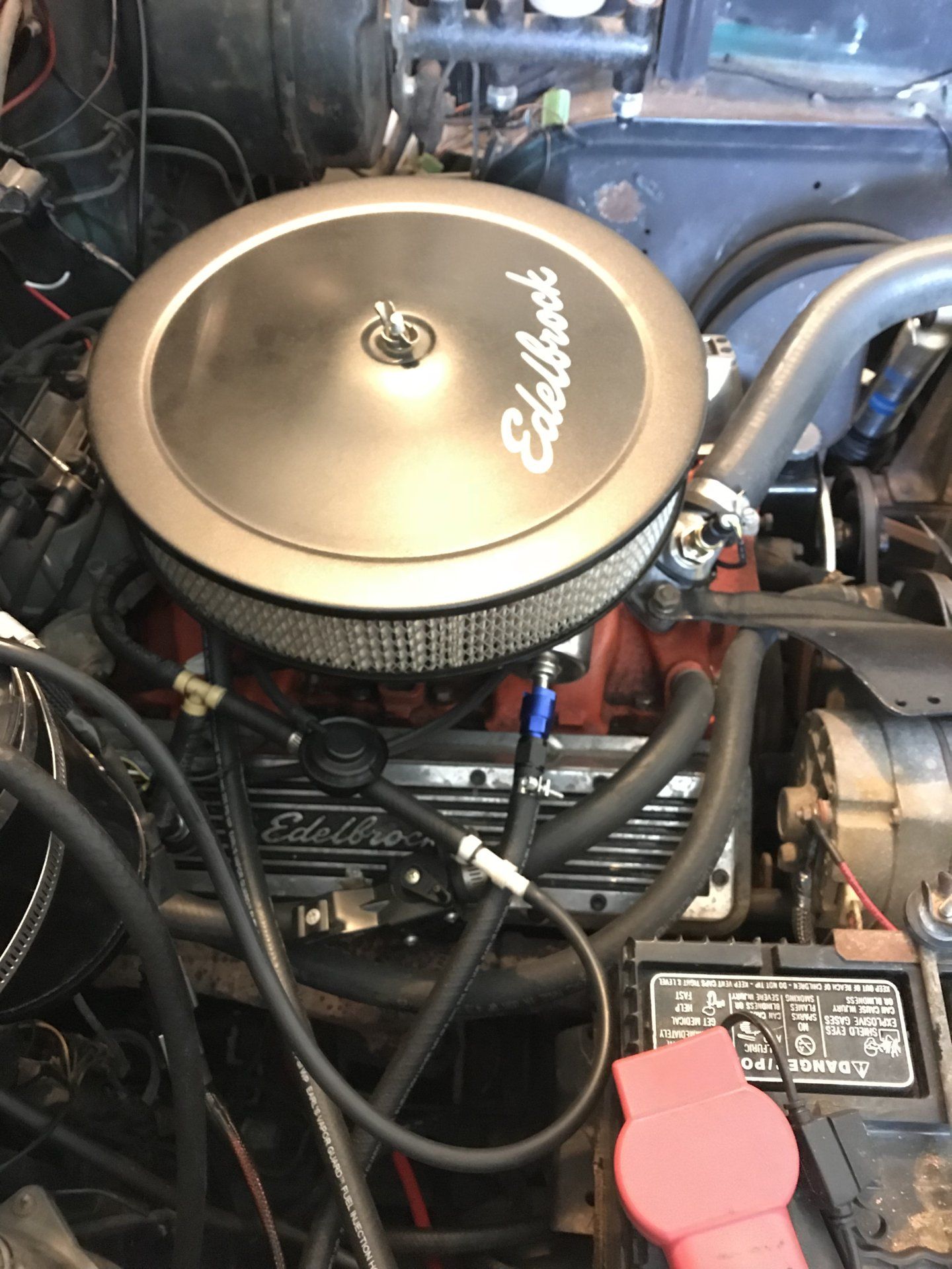

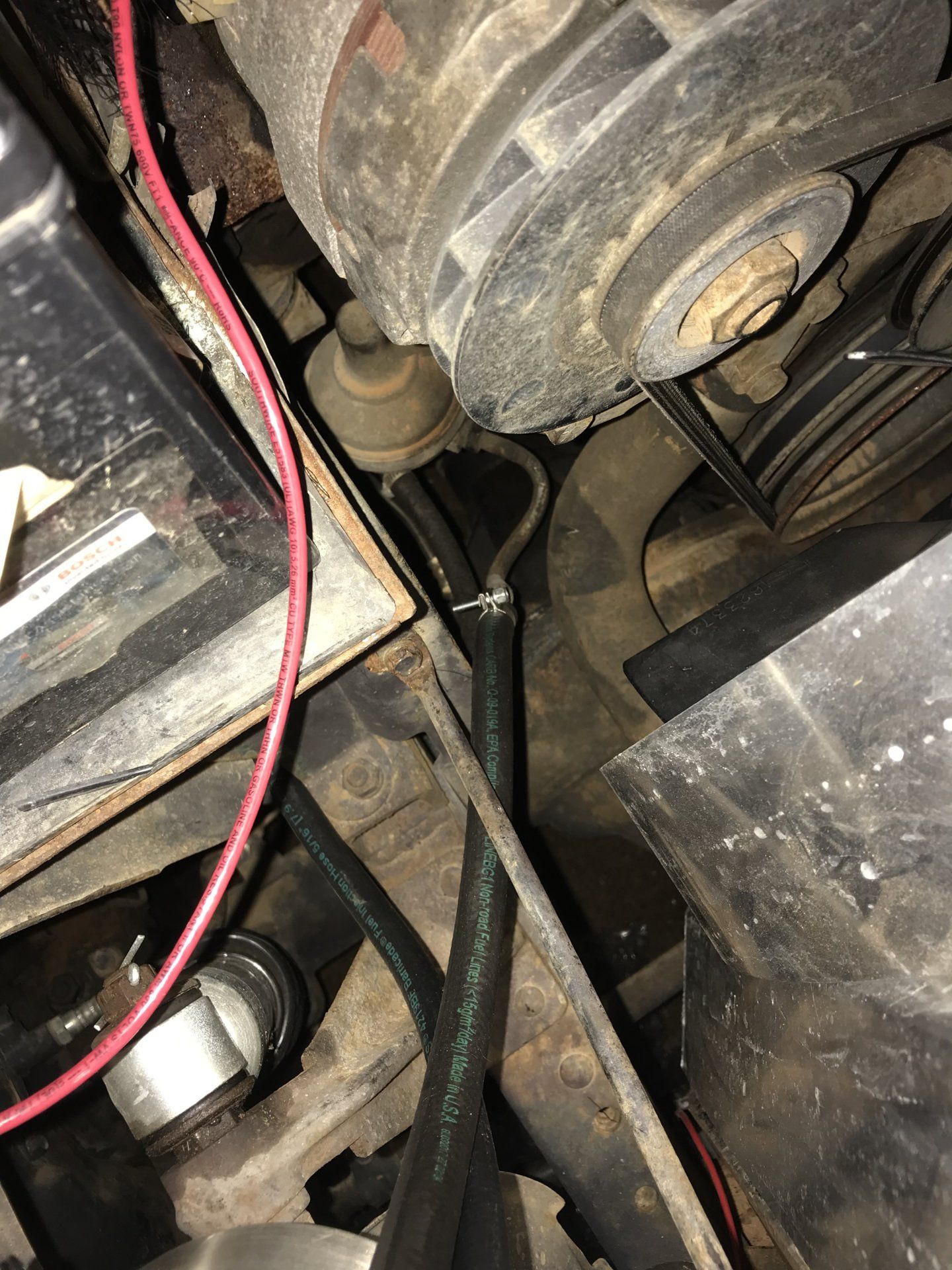

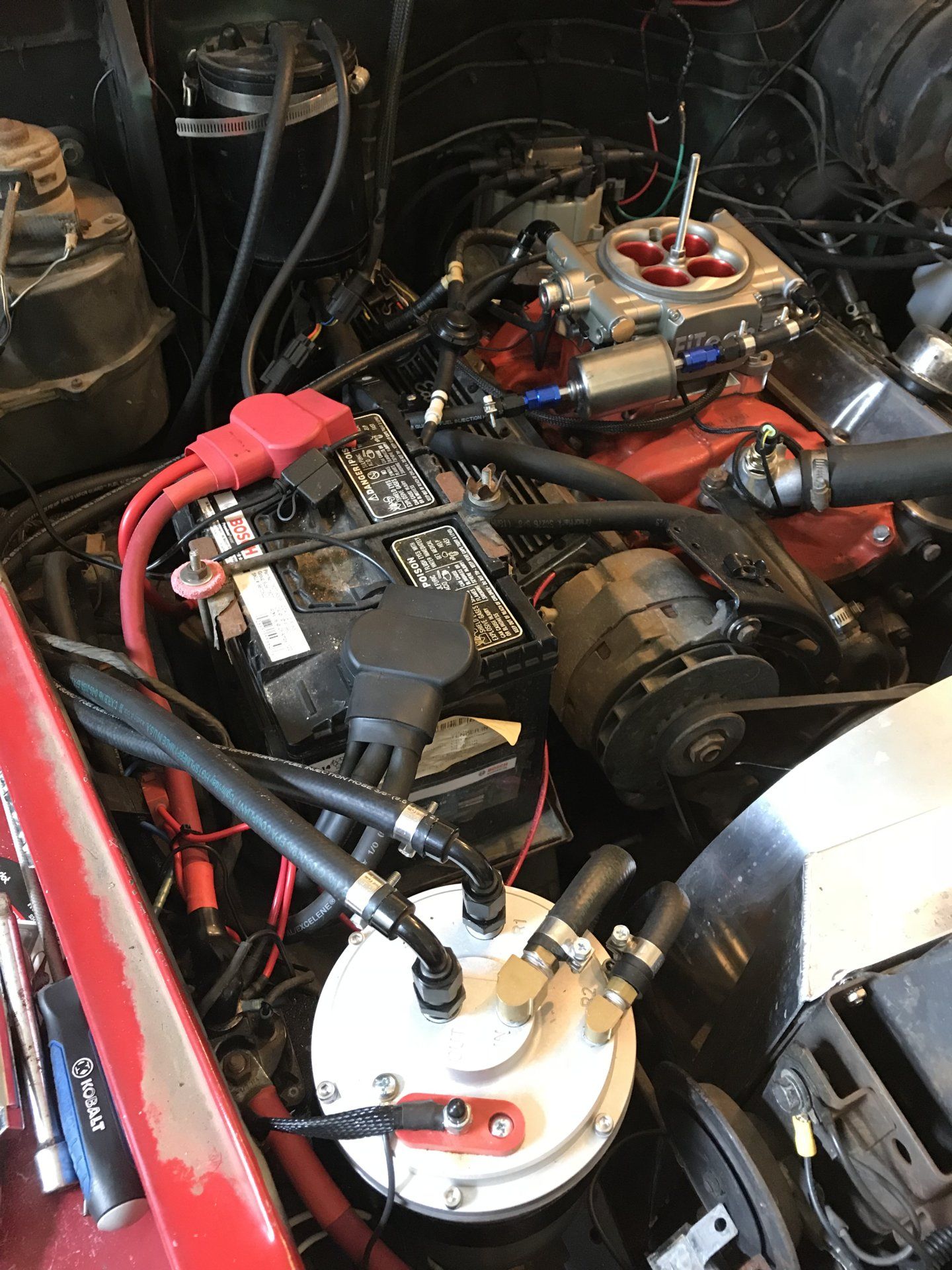

Excuse the mess of wires and hoses - I wanted to keep a vapor canister because I can’t stand gas smell in the garage - overview with surge tank in front corner - relocated my radiator overflow to drivers side and used the original overflow bracket to hold the surge tank - was a perfect fit (this is a 76 so it had the fat round radiator overflow).

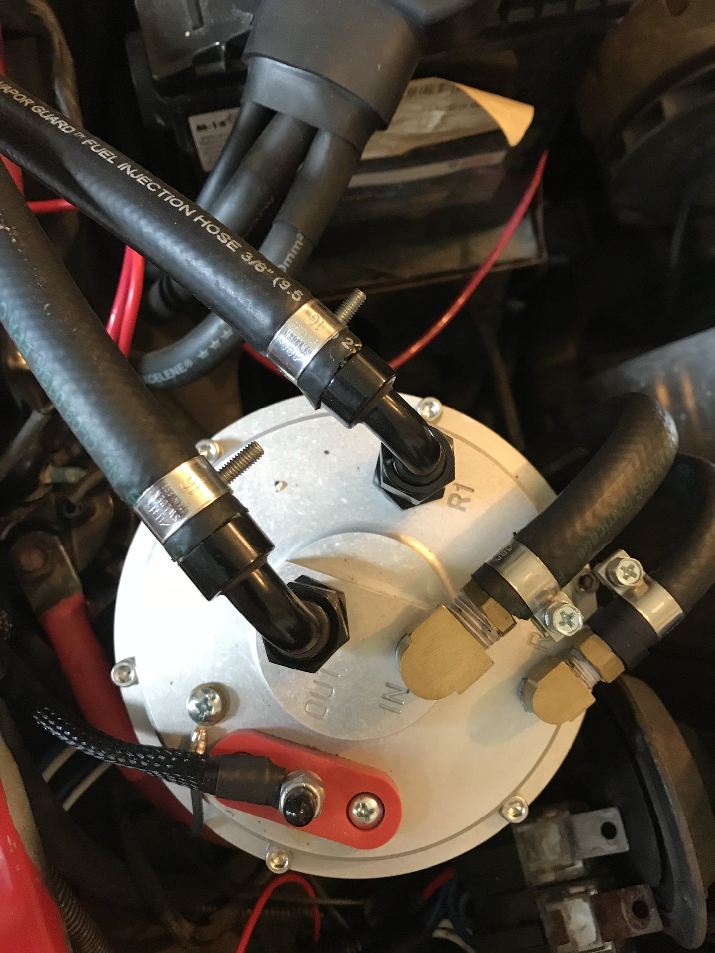

I didn’t care for the original command center because the thought of the float and off-road just makes me think that it’s going to overflow continually, although the pressure gauges on the cc are nice and the original cc came with lots of extra fittings - those add up in a hurry.
I Purchased everything from speedway motors, bought the EFI hose, Earl‘s brand fittings and the special little EFI hose clamps, everything is AN6
Surge tank - brass fittings are inlet from mechanical pump (after pre filter) and return to the stock 40 tank. I like this surge tank because there is no float, it’s always full of fuel, and the mechanical pump is slowly circulating cool fuel from the main tank to it and back - The inlet has a small restriction to put some back pressure on the mechanical pump to slow down the flow. The larger black fittings are the high-pressure out to the EFI, and then the return back from the EFI, it’s low pressure but I used the same hose and fittings.
This is the actual EFI you see the high-pressure inlet on the upper right-hand side and the low pressure return on the lower left side, you can actually use any of the other two ports for the high-pressure inlet, I originally had it coming in the back but it was a little too close to my linkage and crowded - since the hose is already cut I just used the far side and that helps to hide the EFI high-pressure filter under the air cleaner. This all easily clears the hood and it’s super quiet.
I should add I’ve driven around in the Texas heat with no vapor locking issues yet - my mechanical fan is a big one off a caddy - it pushes plenty of air under the hood - I like having the surge tank up near the front where it gets some cooler air.

To address the concern that the Fitech rep brought up it seems like if I put a fuel regulator on the return line from the fuel rail it would maintain the necessary pressure in the fuel rails and at the same time separate the high and low pressure systems. Thoughts?
Is the FiTech unit regulated at the CC? Holley does the same thing with their inline fuel pressure regulators which can be down on the frame rail and single line from there to the throttle body. Both the FiTech and Sniper throttle bodies have regulators built in so if you run just that one, you need a return from there. Really I think you just need a return from wherever you regulate pressure first.
Pretty sure you could dead-head if that surge tank has the regulator and puts out the correct psi. Holley sells a remote pressure regulator that does just that. I'll go into more details later after work.

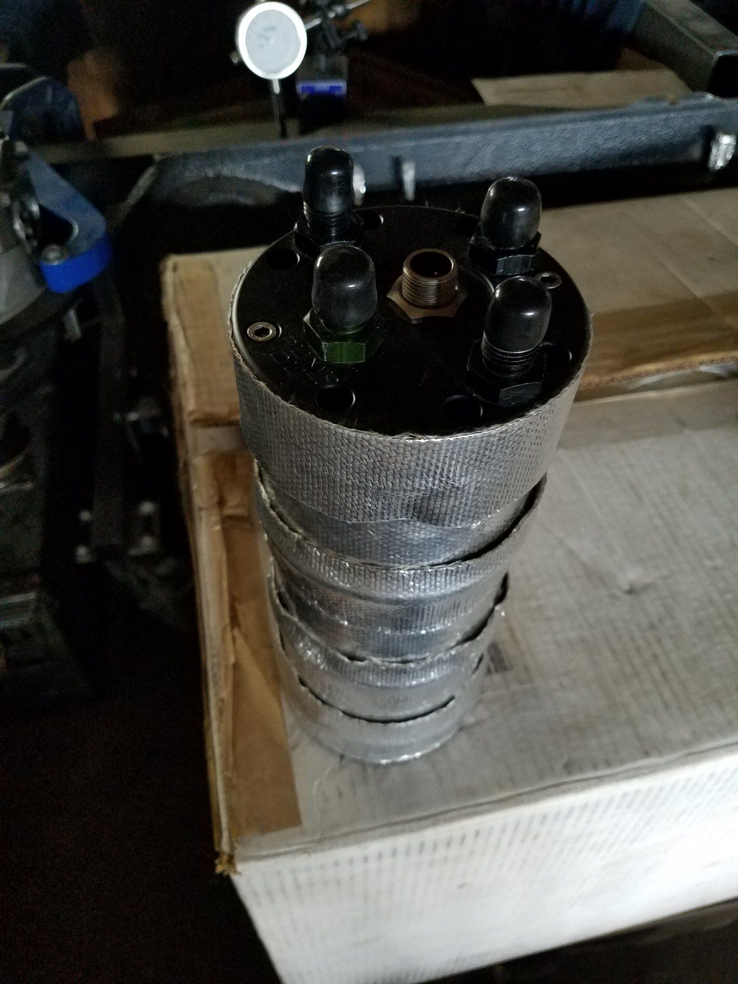

I decided to go with a radium surge tank that is set up to run a submerged Walbro pump. It it looks like it will make for a clean install. I am currently waiting on parts to arrive. I will have some more updates after I have everything here to start working on it.
I am also going to be replacing the oil pan and valve cover gaskets since they are both leaking.
My radium surge tank arrived today. I was lucky and found it for a great deal on Craigslist. Previous owner only ran it for 5k miles so it stills looks really clean. It is not real big which is what I wanted because I plan to install it under the hood. Hope it works out just fine.
It has a 450 lph pump. I called Holley and they said the stock regulator would work just fine to manage the fuel with this pump, so I am going to give it a try.

The design seems really nice. The housing is pretty light and all aluminum. The only concern I have with housing design is that both ends seal with an O-ring. If the bottom O-ring holds up long term it I will be happy.
The tank only holds 1.5 litters. I hope that is enough to get the job done. I am t honking it should be fine. The nice part about it is it fits in the engine bay without taking a lot of room. It will make any maintenance if necessary a lot easier.
The pump is a walbro pump and walbro said the designed it to be extremely quite. I will give an update after I get it going.
thanks for the info, it kind of makes you wonder why they made it so top and bottom come off. it really only needs the top to open and if the bottom was part of the housing then no worries about leaks.
and 1.5L should be more than enough since your mechanical pump will keep filling it. mines only .5L more (2.0L) and no issues.
also coat the O-rings with a little vasiline or oil before sealing the unit up. it helps with sealing and helps keep them soft.
any idea the number of the walbro pump they use, i would like to look up the spec's for future referance.
