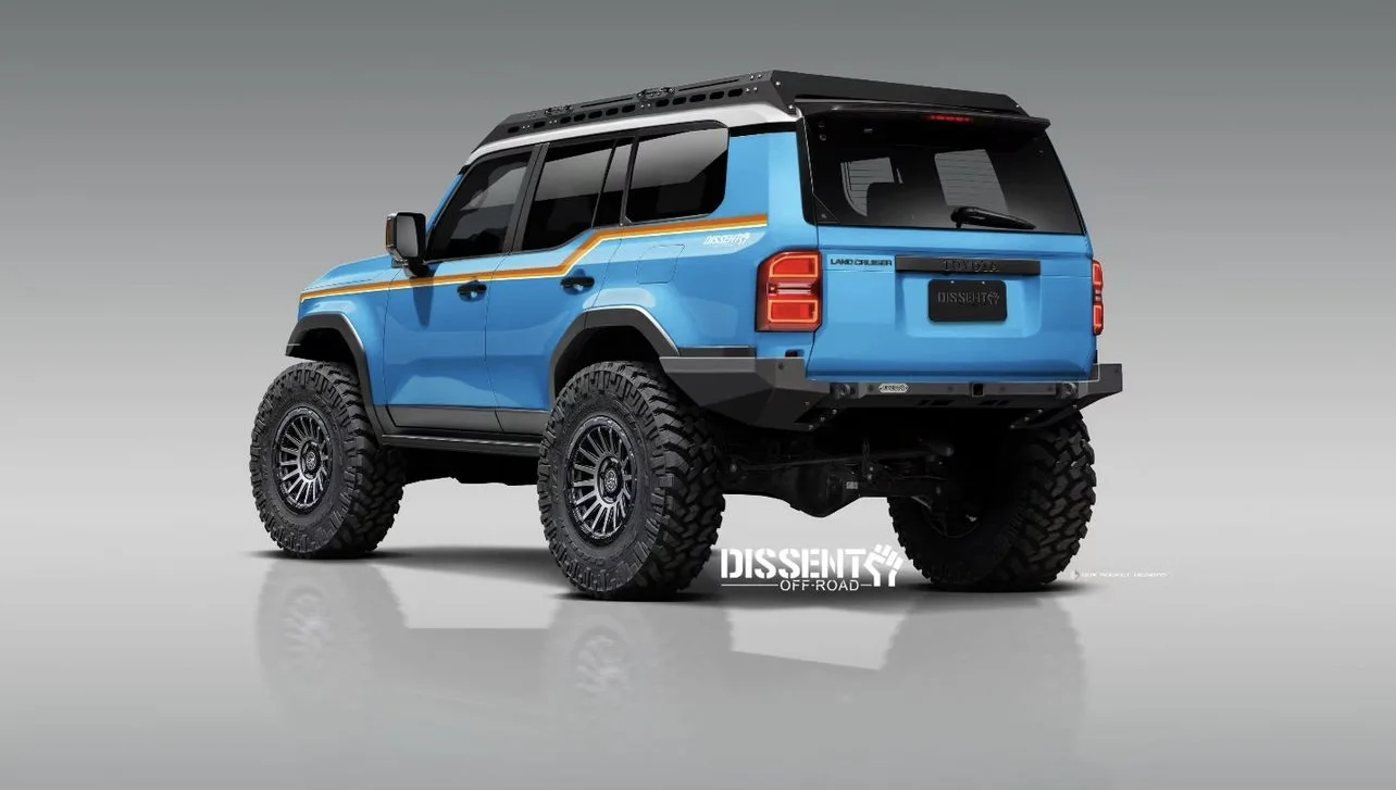

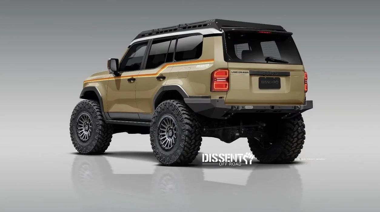

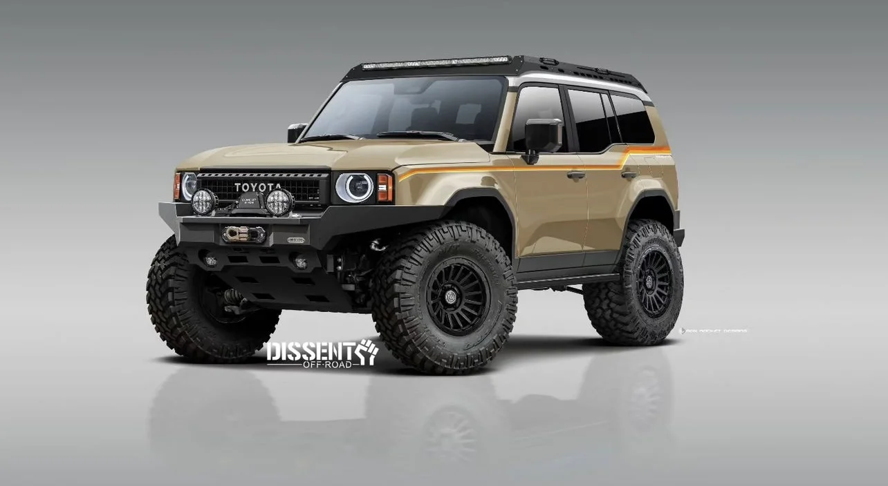

We have some big plans for our 2024 lc250 FE once we receive it! What are your thoughts? Think it will make a good trail rig and compete with the bronco and jeep market? Ours should arrive soon and we are planning to give a crawler build a go and see how it handles trails like fordyce and rubicon! Excited to push the limits of this new platform!
Thanks @Box Rocket for the awesome renders!
Do you plan on doing no-cut bumpers? At least no cuts to the frame? It looked like the front facia was designed in such a way that taking off pieces of it would leave a nice empty bumper space without the need for cutting panels.
We do. I’m doubtful many will want to modify in the way we are doing ours but I’m sure many will love to watch 😂. We will be doing a Les aggressive armor line for the masses that will require much less cutting.
I figured. Your render is really enticing though. Maybe in 10 years when mine is "old" and ready for more aggressive fun.

The cross-traffic radars would have to be removed or relocated for those bumpers. looks rad though.
The renders look a little cartoonish but I do like the bumpers. That said, many wouldn't think twice about cutting plastic but cutting the frame makes it a very niche product for the very few.
I love the look and want to see the rig, the armor, and the 37 or 38 inch tires underneath it all out on the trail soon! I will be in the 'happy to cut the body, less keen to cut the frame camp' when it comes time to actually buy and build though (lame, but being honest).

Wait… is this not how Toyota sells them? 😃
Where could a vehicle built like that be legally driven? Mongolia? I don’t think it’s highway legal in the USA. Guess it would need to be towed to an off-road location.
Aside from commie kalifornia, you can drive a modified car legally……
