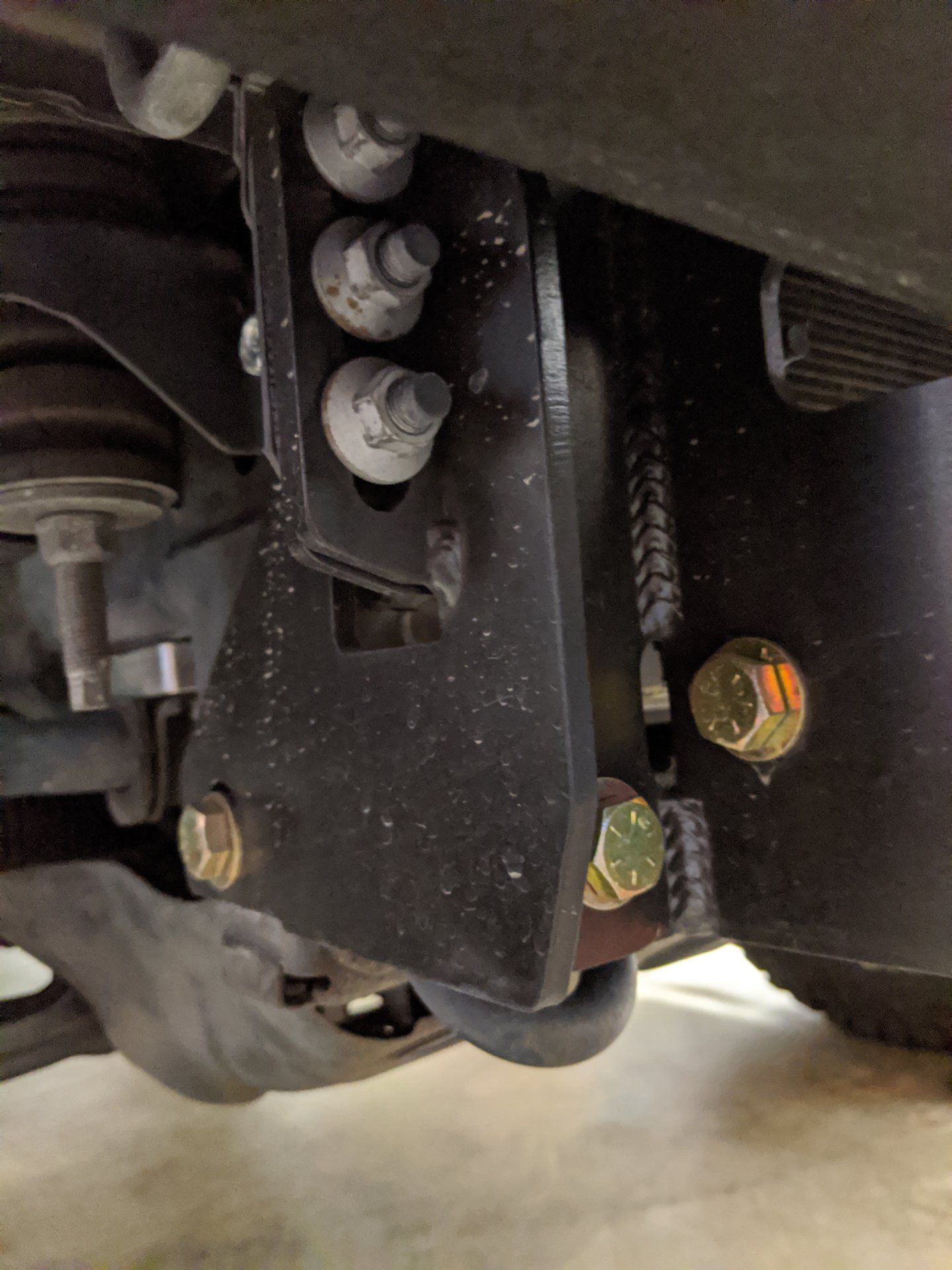

Yeah, it was definitely wrong. But I flipped it and still don't see how to get it right. I'll have to contact Ben tomorrow.
Basically when you undo the hose, that screw will go into the top open hole holding the hose in your picture of it backwards and there is a carriage bolt in the frame that will use up the other visible hole. The other three of course go where you have them. But yeah man the builder will set you straighter than I can...

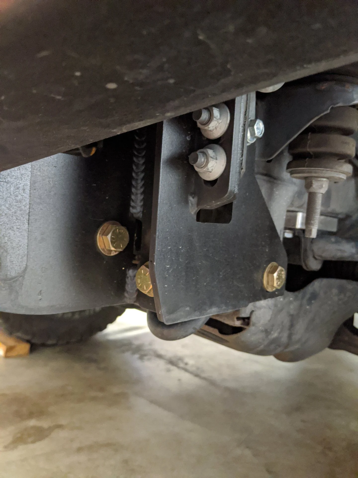

Here's a pic of mine installed. It sandwiches the recovery points with the frame attachment.
Driver side.
Passenger side

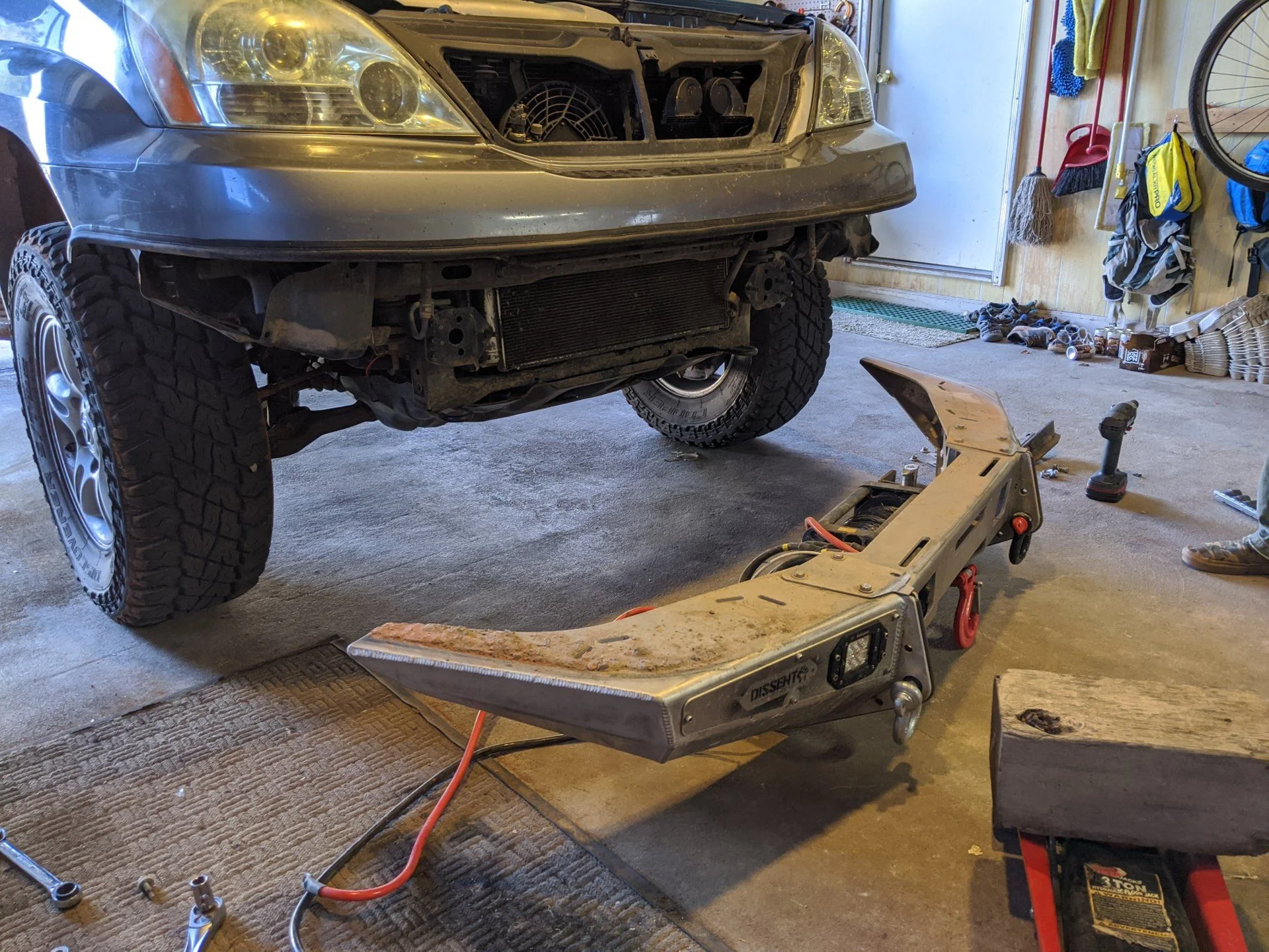

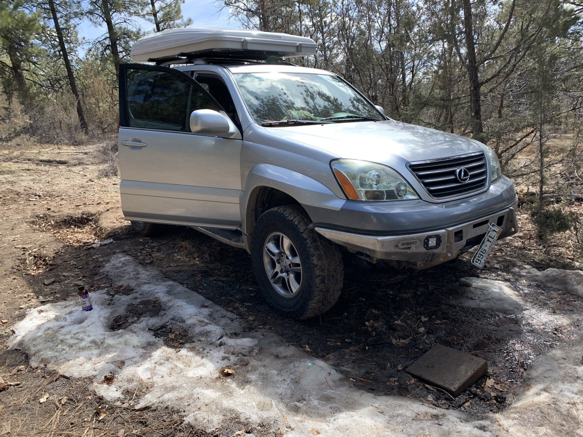

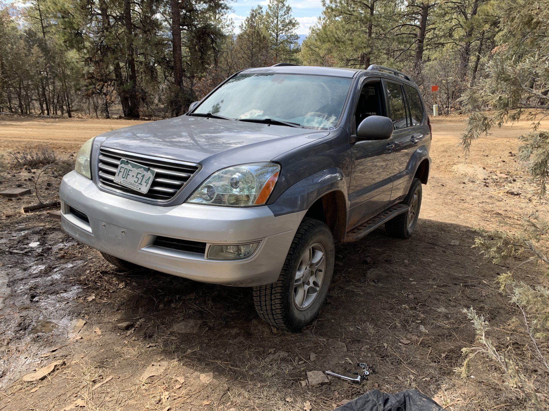

After three years and 30k miles, and buying a sequoia also, I decided to sell my ‘04 GX and focus on the ‘07. So i took my bumpers and tires off the ‘04 and put the front on for now and am working on the rear. Time was a huge factor and I was traveling, now stationary.
here’s the gx trying to look like a Subaru because I wasn’t going to cut another bumper. I’m going to color match in time. Funny to note, the metal actual bumper fromView attachment 2234392View attachment 2234395 the ‘07 would not fit/line up with the ‘04 which I found strange but buyer is putting bumpers on anyway.

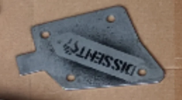

I noticed, looking back at some pics on an earlier page - what is this? I laid out my parts last night and don't see this.
Edit - I think I see that on top of the bumper in the pics above.
Yes, that goes on top of the bumper where the side piece, recovery piece, and main piece go together.
