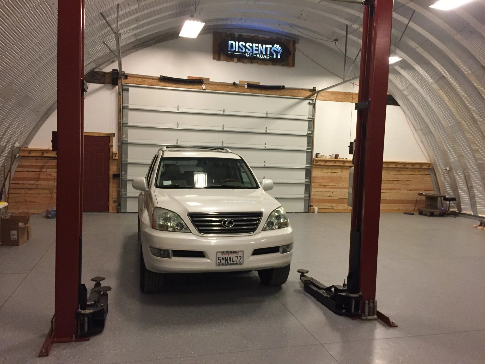

He wanted bumpers for his gx470 so he bought me one for r&d. I picked up a clean 1 owner trade in with service records yesterday and will have it for about six months for r&d. Hoping to get front rear bumpers, sliders , skid plates and roof rack developed in that time.
Stay tuned for progress!
Dang, I think I might be more jealous at how clean your shop is, but the clean slate is pretty awesome too.

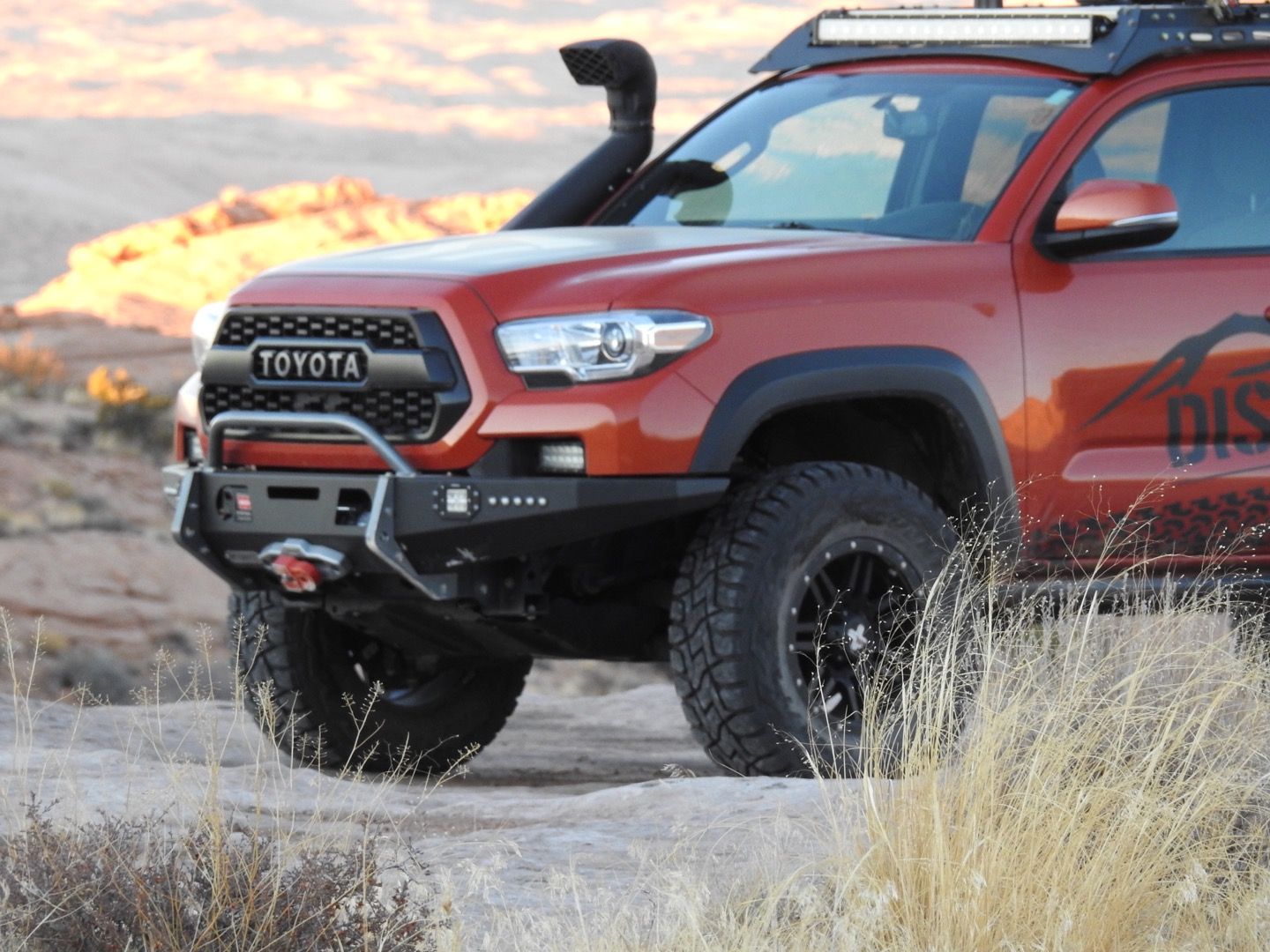

That is the plan as of now, similar to what I have done with my Tacoma bumper.
You have my attention. Interested to see what you come up with.
This is awesome! I'm interested in what you are going to do with when you are finished!? My wife is wanting GX bad ;)
I like the clean, industrial and minimalist aesthetic of your Tacoma front bumper, I hope that continues with the GX! My main complaint with the front bumpers I've seen for the GX so far is that they have looked too big or pronounced, like a bulldog with an underbite :)
